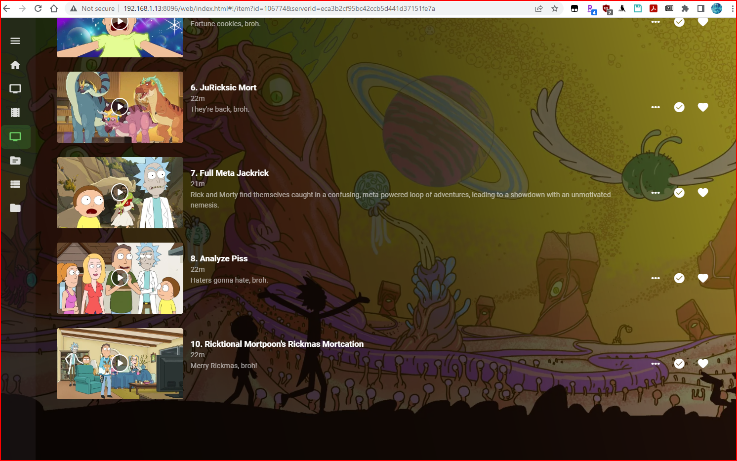

HTanner 6 Posted May 15, 2023 Posted May 15, 2023 I have a weird problem going on. First, some background. I have a LARGE video library, with over 100 TV shows and thousands of movies. I add new content daily, and while Emby normally monitors folders for changes, I usually do a manual reload (by choosing Scan Library Files) after the new content has been added. Most of my names were set when I used Plex, and I continue following those naming conventions for consistency. Emby has always done a fantastic job of identifying everything properly. I'm having a problem with a single episode not loading into Emby. It's Rick and Morty S06E10. The episode is listed correctly at thetvdb.com, so that's not the problem. The other episodes of season 6 are loading properly, yet this single episode refuses to load. Normally, Emby adds an nfo file to the folder where the episode is after it scans the episode. But Emby has not added an nfo file to the folder, meaning it hasn't even tried adding this episode. Again, I'm only having a problem with this one episode out of thousands Here's the folder: Notice there's no nfo file for S06E10 while all the other episodes have them. Here's the view of that season in Emby: As you can see, the rest of the episodes have loaded into Emby just fine. It's only this one episode that's a problem. I'm on the current version of Emby server: Any help would be greatly appreciated.

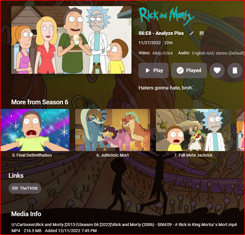

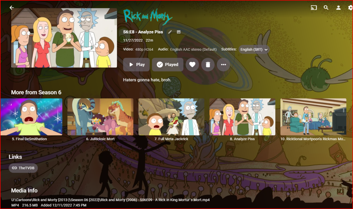

HTanner 6 Posted May 16, 2023 Author Posted May 16, 2023 I see the problem. It's mis-identifying S06E09 as S06E08: Notice that the episode is identified as S6:E8 by Emby (at the top of the screen), yet the file is named S06E09 (as seen at the bottom of the screen. This is the only problem I have in my entire collection using Emby. And I've no idea why this is happening.
HTanner 6 Posted May 16, 2023 Author Posted May 16, 2023 My apologies everyone. I was missing S06E06 in my collection. You can see this in my original post. This confused Emby and caused the problem. I will add S06E06, and I'm sure this will fix it.

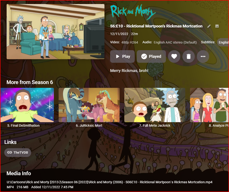

HTanner 6 Posted May 16, 2023 Author Posted May 16, 2023 Jeez. I added S06E06 but it didn't fix the season. So I moved S06 out of the Cartoons, rescanned, added S06 back to Cartoons, and scanned again. That didn't fix it. But it did change the episode that was being identified incorrectly! Now S06E07 is missing from Emby! That is, S06E01 through S06E06 are correct, S06E07 in my collection is missing from Emby, and S06E08 in Cartoons is identified as S06E07 in Emby. S06E09 is identified as S06E08, S06E09 is missing from Emby, and S06E10 is correctly identified.
