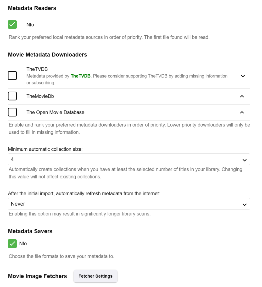

akacharos 32 Posted May 14, 2023 Posted May 14, 2023 Hi, I am using TinyMediaManager to update metadata for existing content in Emby. So I have only enabled Nfo Metadata Readers & Savers in my Emby Libraries: I have done a refresh on the local .nfo's through TMM for fetching updated IMDB/Critic ratings for all the content. However I have hard time understanding how can I force Emby to read these ratings. Scanning files for new content won't update the ratings and if I do full metadata refresh > search for missing metadata won't update the ratings (as the ratings are not missing). Obviously I don't want to replace all metadata because I will lose chapters and Video Preview Thumbnails. Any ideas?
GrimReaper 4846 Posted May 14, 2023 Posted May 14, 2023 (edited) Scan alone of the updated NFOs should do it - are your items locked (or your original NFOs had <lockdata> tag set to "true"), as that'd prevent any metadata update/change? Btw, if you're writing your NFOs with TMM, disable Emby's NFO saver, you don't want both programs to constanly overwrite those. Edit: Scratch that, just tested it myself: neither Scan library files nor Scan media library nor Refresh Metadata>Search for missing reads updated rating(s), even though updated NFO carries later timestamp; @Luke, shouldn't those be read without the need to Replace ALL metadata, as that seems way excessive for an updated metadata field or two? Edited May 14, 2023 by GrimReaper Tests 1
