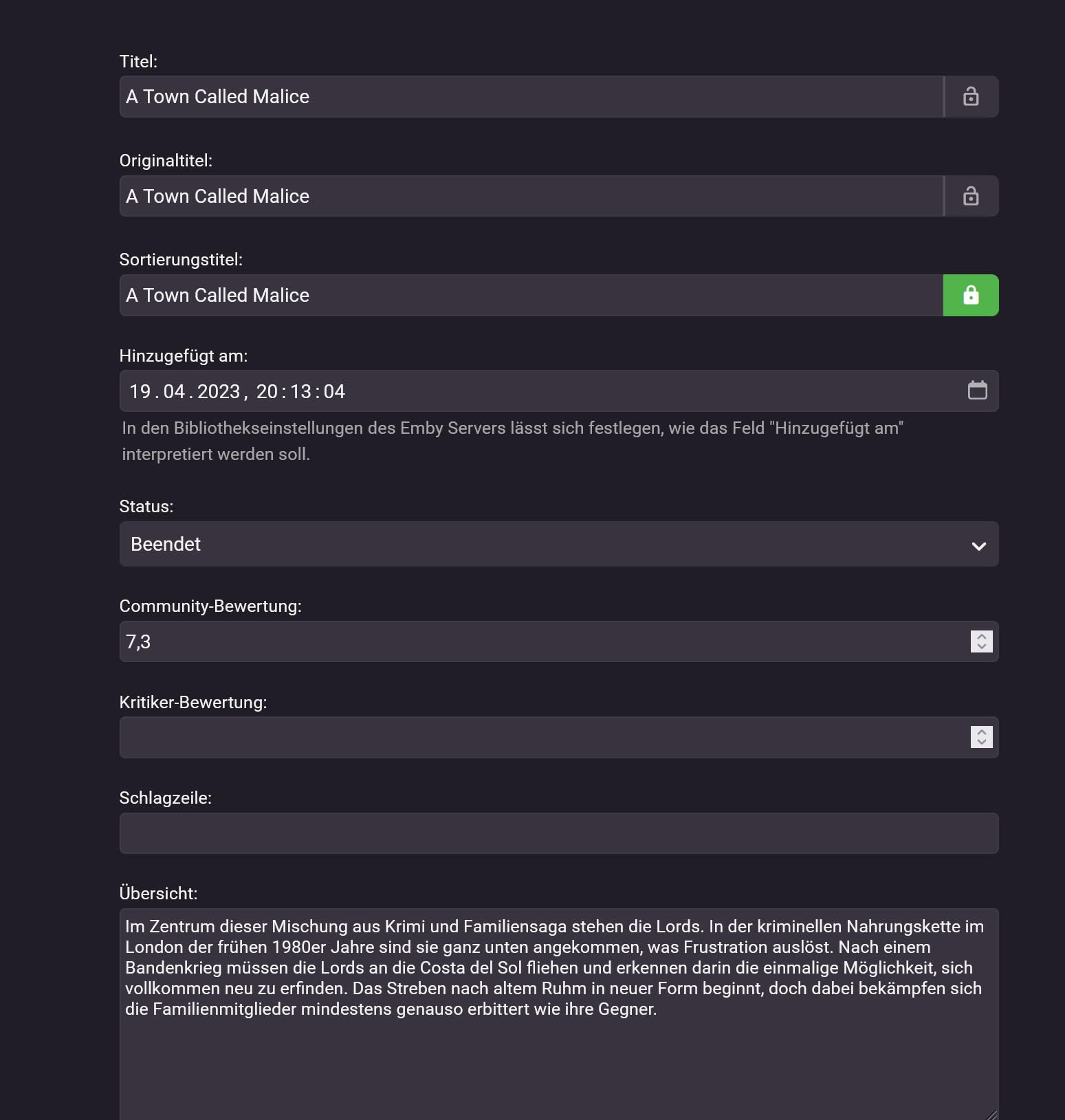

Luke 42240 Posted May 13, 2023 Posted May 13, 2023 Can you show a screenshot of the metadata editor for A Town Called Marcie ?
Home2008 21 Posted May 13, 2023 Author Posted May 13, 2023 Ich habe das nun manuell geändert, daher weis ich nicht, ob der Screen etwas bringt?
Luke 42240 Posted May 18, 2023 Posted May 18, 2023 @Home2008OK that's the metadata editor for season 1. Can you show a screenshot of the metadata editor for the series? Thanks.
Home2008 21 Posted May 29, 2023 Author Posted May 29, 2023 (edited) Du meinst so? Edited May 29, 2023 by Home2008
GrimReaper 4896 Posted May 29, 2023 Posted May 29, 2023 Your Sort Title is locked with an article ("A") at the beginning. Unlock that field (click green lock at the right end). 1 1
