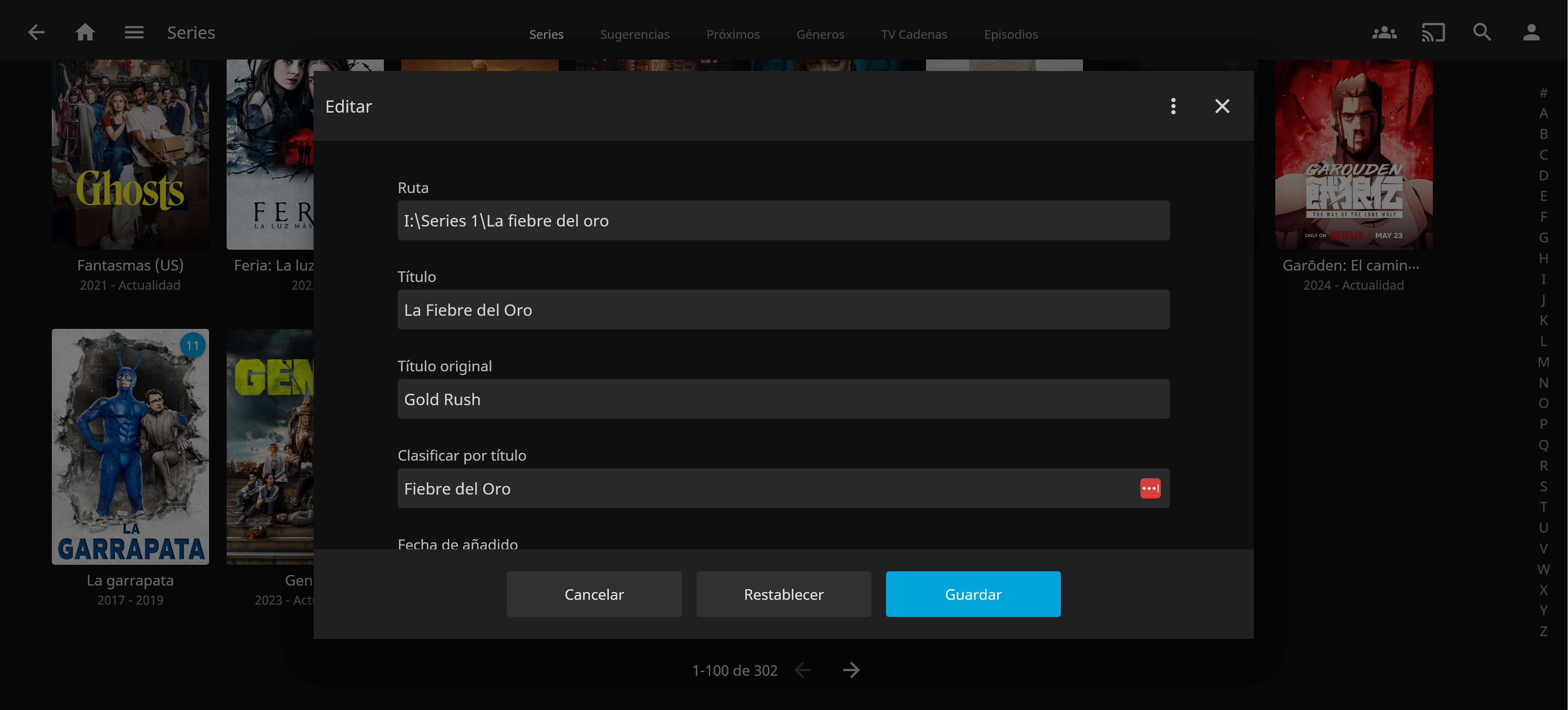

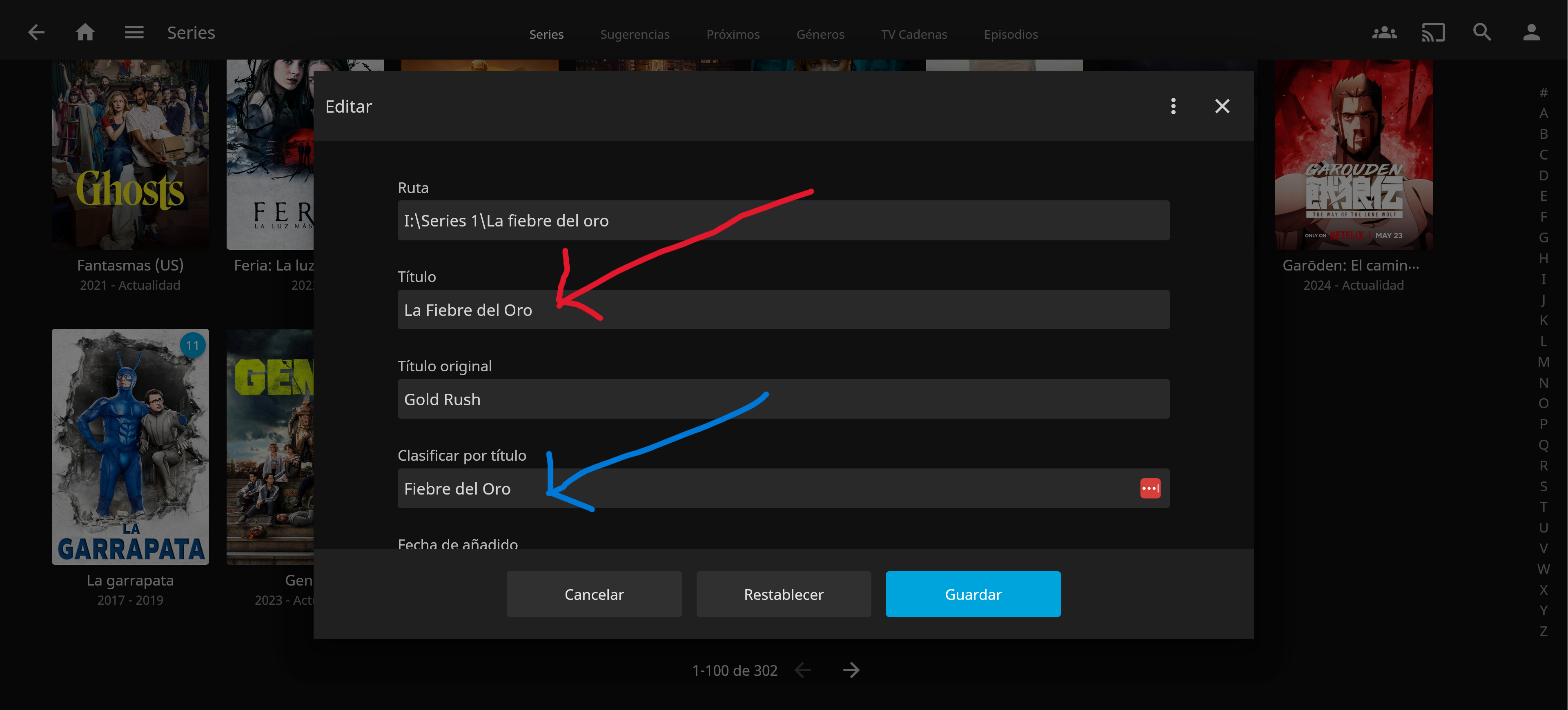

Adjunto nuevamente una captura, un saludo.

Can you show screenshots of what exactly you did?
coyotecabreado
Edited by coyotecabreado
Can you show screenshots from the Emby web app? Thanks.
