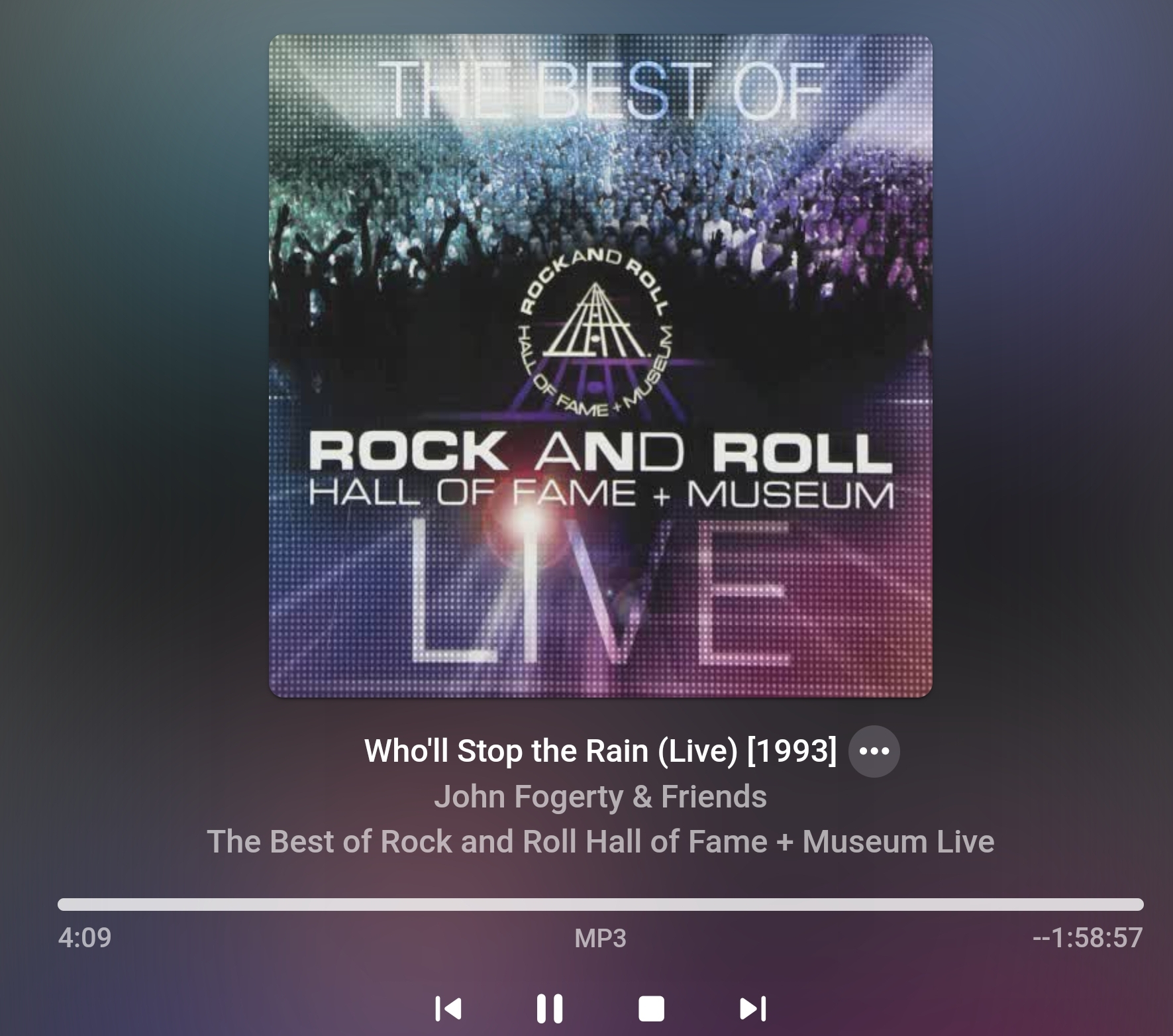

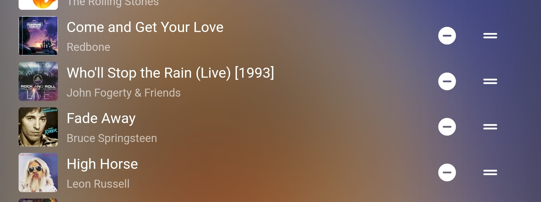

Bigmack3000 108 Posted May 30, 2023 Author Posted May 30, 2023 No, still happening. It's definitely an issue with emby updating any changes made to a playlist. It's hard to take a screenshot of it happening, but I'll try with these: So let's say "Come and get your Love" is playing when i make a change to the upcoming songs. Maybe i remove "High Horse" from the list. When that song ends, it moves to "Who'll stop the rain", which plays fine. But, when it goes "Fade Away" it looks like this: Notice. It keeps the metadata from the previous song, plus that weird time remaining bar. Then when "Fade Away" ends, it updates to the correct image and metadata for "Fade Away" and plays the song again. This same exact process is what happens anytime you alter the upcoming songs.

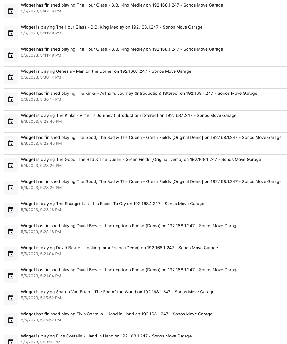

Bigmack3000 108 Posted June 2, 2023 Author Posted June 2, 2023 So, it's different, but kind of worse now. Basically it still does this part: On 5/30/2023 at 3:36 PM, Bigmack3000 said: So let's say "Come and get your Love" is playing when i make a change to the upcoming songs. Maybe i remove "High Horse" from the list. When that song ends, it moves to "Who'll stop the rain", which plays fine. But, when it goes "Fade Away" it looks like this: Notice. It keeps the metadata from the previous song, plus that weird time remaining bar. Then when "Fade Away" ends, it updates to the correct image and metadata for "Fade Away" and plays the song again. Except, instead of playing the song again with the correct metadata, it just stops playing. the song ends with that type of time remaining bar, but just sits. Then when I hit next, it repeats the last song with the correct metadata. You can even see in the activity log which songs it happens to because they don't have a "finished playing" update: I've also attached logs incase there's anything in there. embyserver (1).txt
