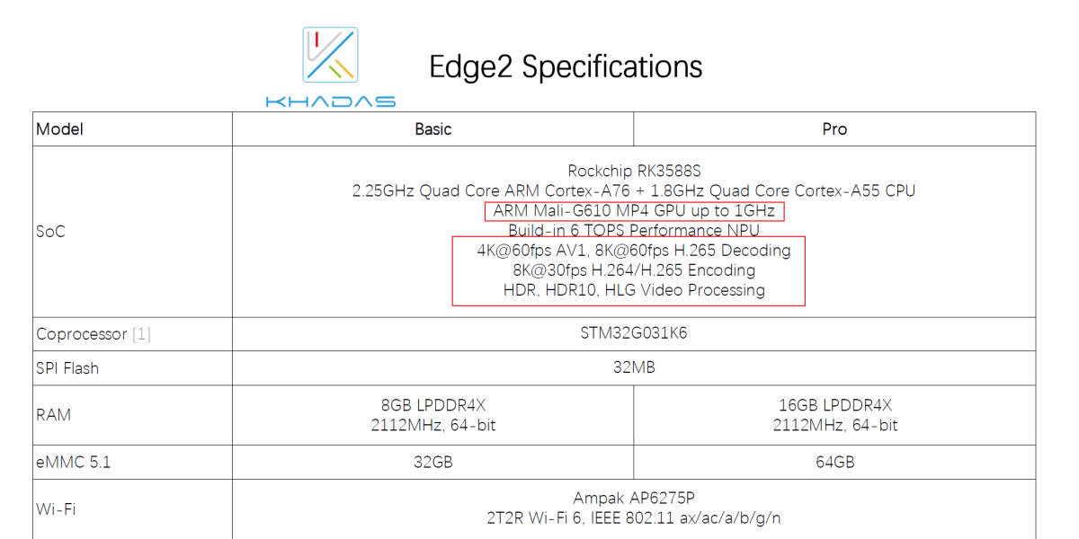

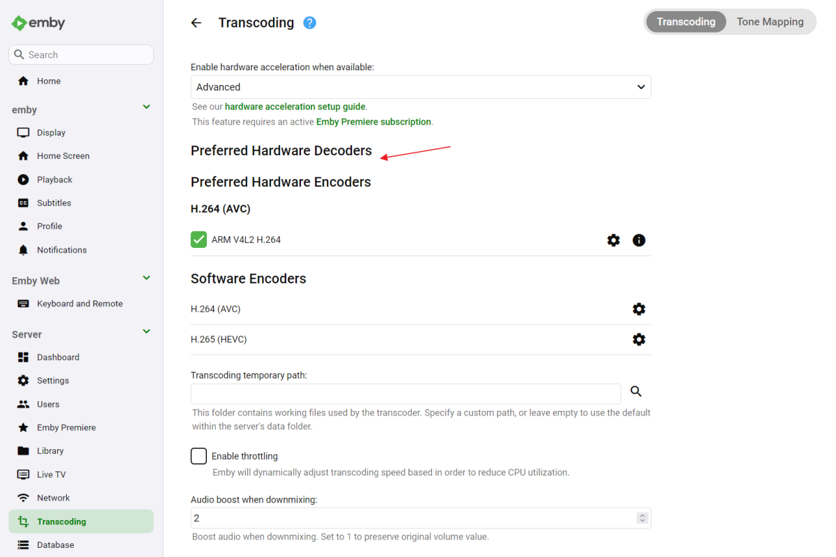

chj915 10 Posted May 5, 2023 Posted May 5, 2023 I have Emby Premiere purchased and I installed Emby server on my Windows 11 machine for hosting my own media library. I do rely on the graphic card H.264 hardware decoding a lot. On windows machine it is using Intel Graphic card so there is no issue. Recently, I have bought a Single Board Computer - Khadas Edge 2. It is a fast board and has factory shipped with Android, Ubuntu Desktop, and Ubuntu Server as OS options. I am interested in getting my Emby server application ported over to this board and run as a docker container in Ubuntu OS. The setup is easy but only thing that I cannot figure out: the graphic card hardware decoding support. According to the product specifications, it has ARM Mali-G610 which is claimed to have H.265 encoding and decoding. As of now, my Emby server runs via Docker container on this Single Board Computer, but there is no option to have the hardware decoding for H.265. I know my question here is very specific to a graphic card device from ARM based Single Board Computer, it might not have lots of users out there. I just want to see if Emby community would have any answers. Thanks

chj915 10 Posted May 7, 2023 Author Posted May 7, 2023 I have downloaded the ARM 64 version Emby package for linux and installed it. It has the same result: no preferred hardware decoder option.
chj915 10 Posted May 7, 2023 Author Posted May 7, 2023 tried the 4.8 beta native deb installation, it gives me the same result. see logs in attachment. emby_logs.zip

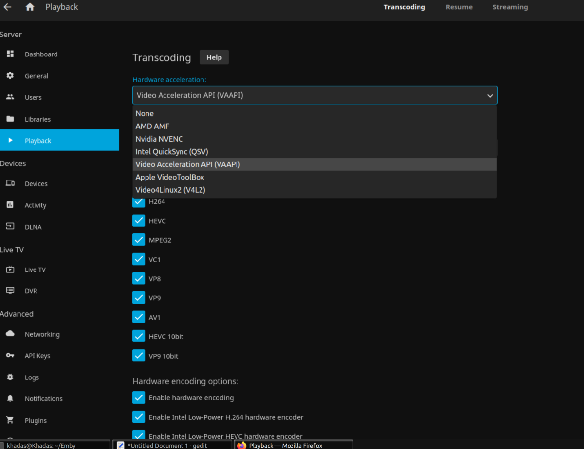

chj915 10 Posted May 13, 2023 Author Posted May 13, 2023 Just to give an update: I have tried Jellyfin (docker), the hardware decoding is supported smoothly. In Emby, there is no option under the Preferred Hardware Decoder support for the Mali G610, thus the CPU usage was always at 90%. In Jellyfin (docker), the hardware decoder option items are all provided. Not sure if the Jellyfin has detected any hardware available or it just lists out everything it supports. Anyway, when playing H.265 video with trans-coding, my Khadas Edge 2 (Rockchip 3588S) CPU usage is down to 20~30%.
softworkz 5133 Posted June 2, 2023 Posted June 2, 2023 On 5/13/2023 at 10:38 PM, chj915 said: Just to give an update: I have tried Jellyfin (docker), the hardware decoding is supported smoothly. What makes you think though? Can you provide an ffmpeg log from them, to see whether that's true? On 5/13/2023 at 10:38 PM, chj915 said: In Emby, there is no option under the Preferred Hardware Decoder support In Jellyfin (docker), the hardware decoder option items are all provided. Not sure if the Jellyfin has detected any hardware available or it just lists out everything it supports. JF is based on old Emby code - which was always showing all possible hw accels. Emby performs detailed detection, not only about available acceleration methods, it precisely detects decoders, encoders, with detail capabilities and available filtering operations. JF cannot do that, it shows you everything (I mean, you obviously don't have Nvidia or Apple hardware in that device...) On 5/13/2023 at 10:38 PM, chj915 said: Anyway, when playing H.265 video with trans-coding, my Khadas Edge 2 (Rockchip 3588S) CPU usage is down to 20~30%. The reason for this could also be that they have some kind of throttling on by default, which you need to activate manually in case of Emby (iirc). The general prerequisite for us to provide hw acceleration is that ffmpeg supports it. If you can find an ffmpeg version which supports your device, your OS and your GPU and you are able to get this working on your device - then we might be able to integrate that in Emby.
