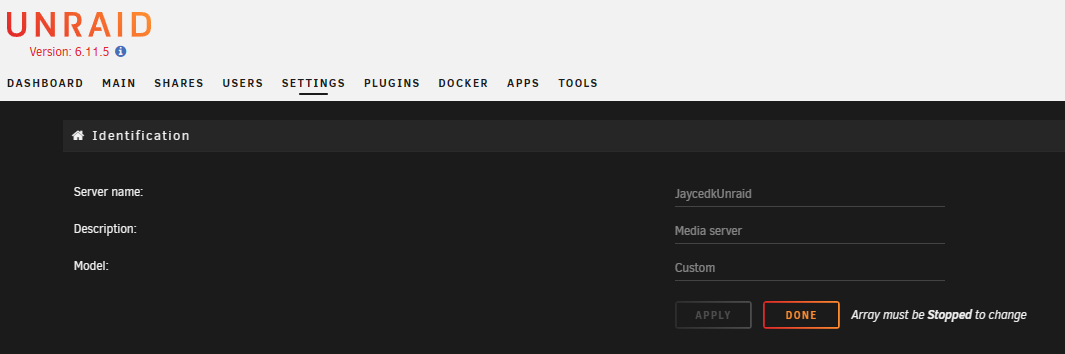

Neminem 1984 Posted May 6, 2023 Posted May 6, 2023 (edited) Have you set Server name under settings -> Identification Edited May 6, 2023 by jaycedk
kkhan 16 Posted May 7, 2023 Author Posted May 7, 2023 Yes I have. I can access the shares from an external device no problem using the server name.

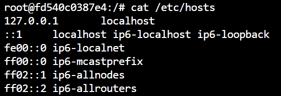

kkhan 16 Posted May 14, 2023 Author Posted May 14, 2023 @rbjtech. @luke; everyone: Thanks for your help. Much appreciated. My understanding was that I could modify the emby container hosts file by, and I quote from a previous post above "I also tried to add an extra parameter in the emby container (under advanced view) --add-host servername: IPAddress. That also did not work". But I will try editing the container host file as suggested by @seanbuff and report back. But as Luke has stated, it is likely not going to work so I will probably revert to just using \\localhost\myshares etc as library paths as that will give exact equivalence between the main and backup emby environments allowing me to keep the backup synchronized to the main on a scheduled. Thanks all.
kkhan 16 Posted May 14, 2023 Author Posted May 14, 2023 This is the hosts file for the emby container. I added three entries at the bottom to test whether emby would resolve either Flower or testname but it does not when trying to select media shares. I used "--add-host Flower:192.168.1.7 --add-host Flower:127.0.0.1 --add-host testname:127.0.0.1" in the Extra Parameters section (under Advanced View) in the emby container. / # cat /etc/hosts 127.0.0.1 localhost ::1 localhost ip6-localhost ip6-loopback fe00::0 ip6-localnet ff00::0 ip6-mcastprefix ff02::1 ip6-allnodes ff02::2 ip6-allrouters 192.168.1.7 Flower 127.0.0.1 Flower 127.0.0.1 testname / #

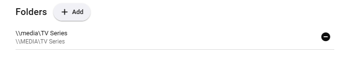

Solution rbjtech 5404 Posted May 14, 2023 Solution Posted May 14, 2023 Agreed - if the base OS is resolving them, but Emby is not - then the question needs to be answered by the Emby Dev's .. Can you do a screen grab of exactly what you have put in the library fields ? Mine below - Note optional path has the host in Caps as this is required from my Android Shield for mounting in Direct File play mode Media is actually the local storage (I just choose to access it via a share), but this works equally as well with a remote SMB share from another server.
MrMackey 37 Posted May 14, 2023 Posted May 14, 2023 I have just roughly followed the topic. I also use unraid and for me it looks like this:
