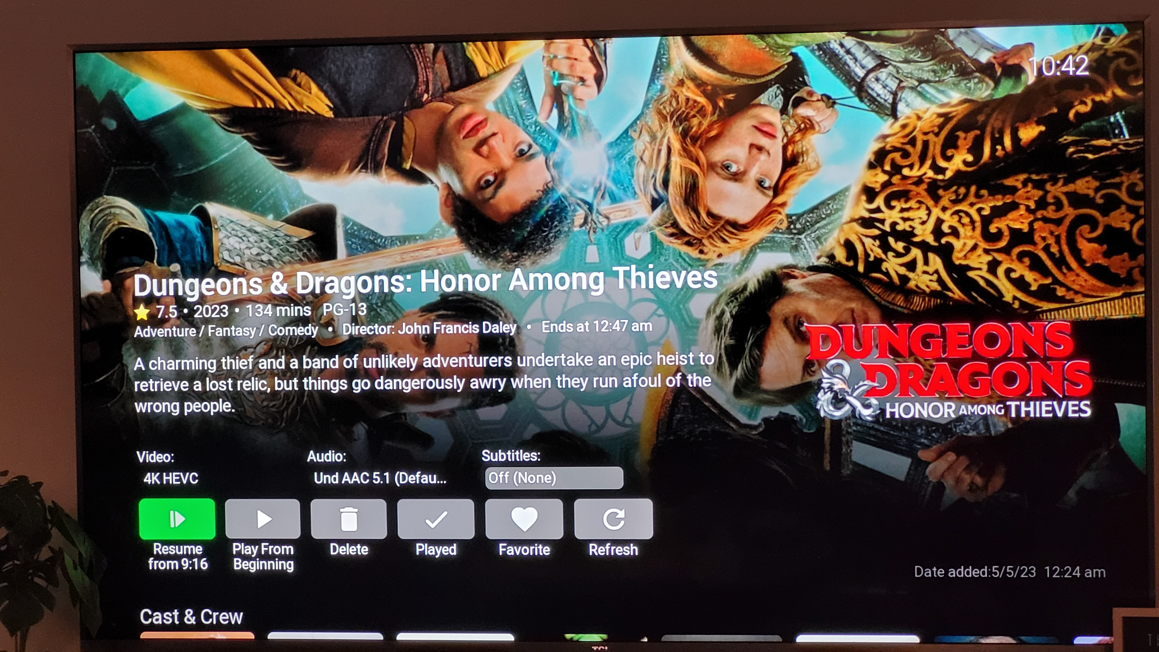

Familia Chapin 12 Posted May 7, 2023 Author Posted May 7, 2023 Ok here is the rundown: 1. This is the movie page/library 2. I chose dungeons and dragons 3. I messed up the shot here but was supposed to show that there is no resume option as this is the first time I'm attempting to play this file 4. This shows it started from the beginning. 5. This is where i stopped playing it using the back button on my remote. 6. This shows the resume playback feature is correctly showing it stopped at 9:16 7. Now i chose the movie 65 from the continue watching section (this behavior is the same regardless of where i choose the content). 8. It shows that 65 should resume at front stamp 51:41. 9. This shot shows that emby is starting video from 65 media page 10. As you can see dungeons and dragons played at the timestamp of 51:41 which was the stamp for 65. The original timestamp of dungeons and dragons was 9:16 (screenshot 6). 11. When i stopped the media using the back button on remote, it returned me to 65 page, even though you saw it was playing dungeons and dragons. 12. When i went back to the dungeons and dragons page, the timestamp is now showing 51:48 which is where it stopped when it got played from the 65 page. Hopefully that wasn't too much but you can see something funny is going on (not just my bad taste in movies lol). This doesn't happen if the first and all subsequent videos are resume play initiated. This only happens when a new movie is played from the beginning. Almost as if the identifier use to mark that movie overwrites everything else. 1
