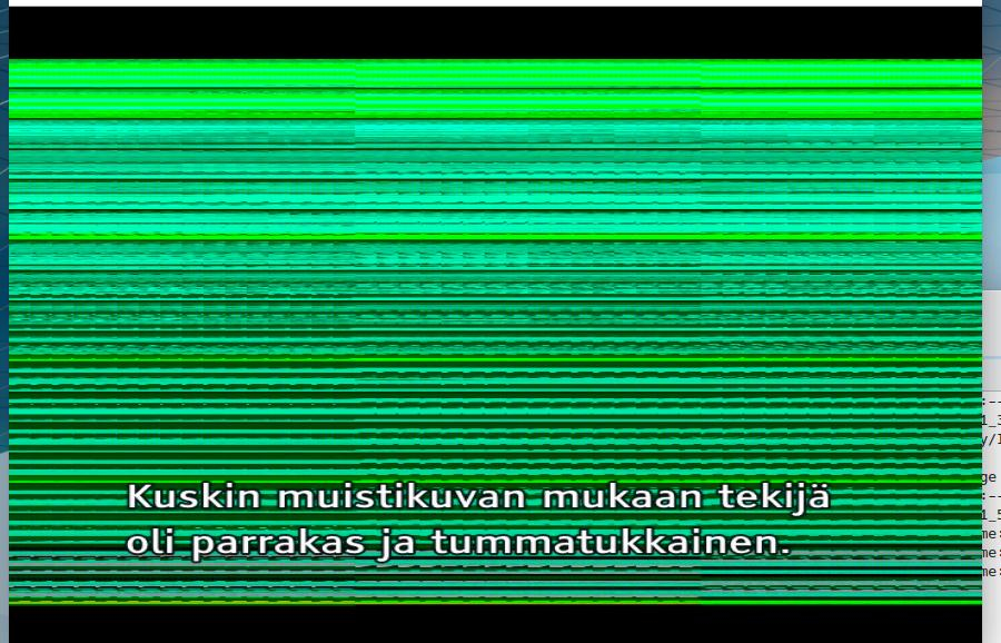

Karsta62 3 Posted May 27, 2023 Author Posted May 27, 2023 Another issue encountered. Many SD channels look like the uploaded image. Sound and dvb subtitles are fine, but image is scrambled. The channels are free to air. When starting the stream the picture is ok about 0,5-1 second.
Karsta62 3 Posted May 27, 2023 Author Posted May 27, 2023 (edited) Another issue encountered. Many SD channels look like the uploaded image. Sound and dvb subtitles are fine, but image is scrambled. The channels are free to air. When starting the stream the picture is ok about 0,5-1 second. This issue is only when using chrome on a computer so far. Edited May 27, 2023 by Karsta62

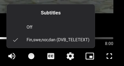

Karsta62 3 Posted June 2, 2023 Author Posted June 2, 2023 22 hours ago, Luke said: HI, are you still seeing this with 4.7.13? Just updated and yes, the same scramble effect using chrome on linux. As well the teletext subtitles behave the same showing all four languages one after the other rapidly. The cc-settings availabe here:
Luke 42245 Posted June 29, 2023 Posted June 29, 2023 On 6/2/2023 at 12:51 PM, Karsta62 said: Just updated and yes, the same scramble effect using chrome on linux. As well the teletext subtitles behave the same showing all four languages one after the other rapidly. The cc-settings availabe here: @Karsta62you're seeing that because that's the language code in the actual stream: 12:03:43.719 Stream #0:3[0x80c](fin,swe,nor,dan): Subtitle: dvb_teletext ([6][0][0][0] / 0x0006), 492x250, Start-Time 19580.052s Does that answer that question?
Luke 42245 Posted June 29, 2023 Posted June 29, 2023 The next questions I have are: If you use Emby to create a small recording, does the recording have this problem when playing in another application such as VLC? If no, does the recording have this problem when playing from Emby?
Karsta62 3 Posted July 1, 2023 Author Posted July 1, 2023 On 6/29/2023 at 8:58 PM, Luke said: The next questions I have are: If you use Emby to create a small recording, does the recording have this problem when playing in another application such as VLC? If no, does the recording have this problem when playing from Emby? Using emby to watch an emby recording has the same scrambled result. But when I disable dvb subtitles on emby, the video is fine. That is when using chrome on linux. With VLC the emby recording is fine. So it's related to DVB subtitles and emby on chrome I think. When ever a channel has anything teletext, emby brings it on by default (chrome/linux).

Karsta62 3 Posted July 3, 2023 Author Posted July 3, 2023 Right. Dumbass I am. Setting it to Smart fixed the teletext on by default issue. Though still when I activate dvb-subs, the image gets scrambled. HD Pay TV channels don't work. They would have teletext subs. Unable to test more just yet.
Karsta62 3 Posted July 3, 2023 Author Posted July 3, 2023 11 minutes ago, Karsta62 said: Right. Dumbass I am. Setting it to Smart fixed the teletext on by default issue. Though still when I activate dvb-subs, the image gets scrambled. HD Pay TV channels don't work. They would have teletext subs. Unable to test more just yet. Couldn't edit But false info was the pay HD channels. I had a second paytv chanel open and the box can only handle one. But still the issue of getting all teletext languages on continuously. As in the images above, I can choose only them all or off. Using VLC it automatically chooses Finnish, as I want
