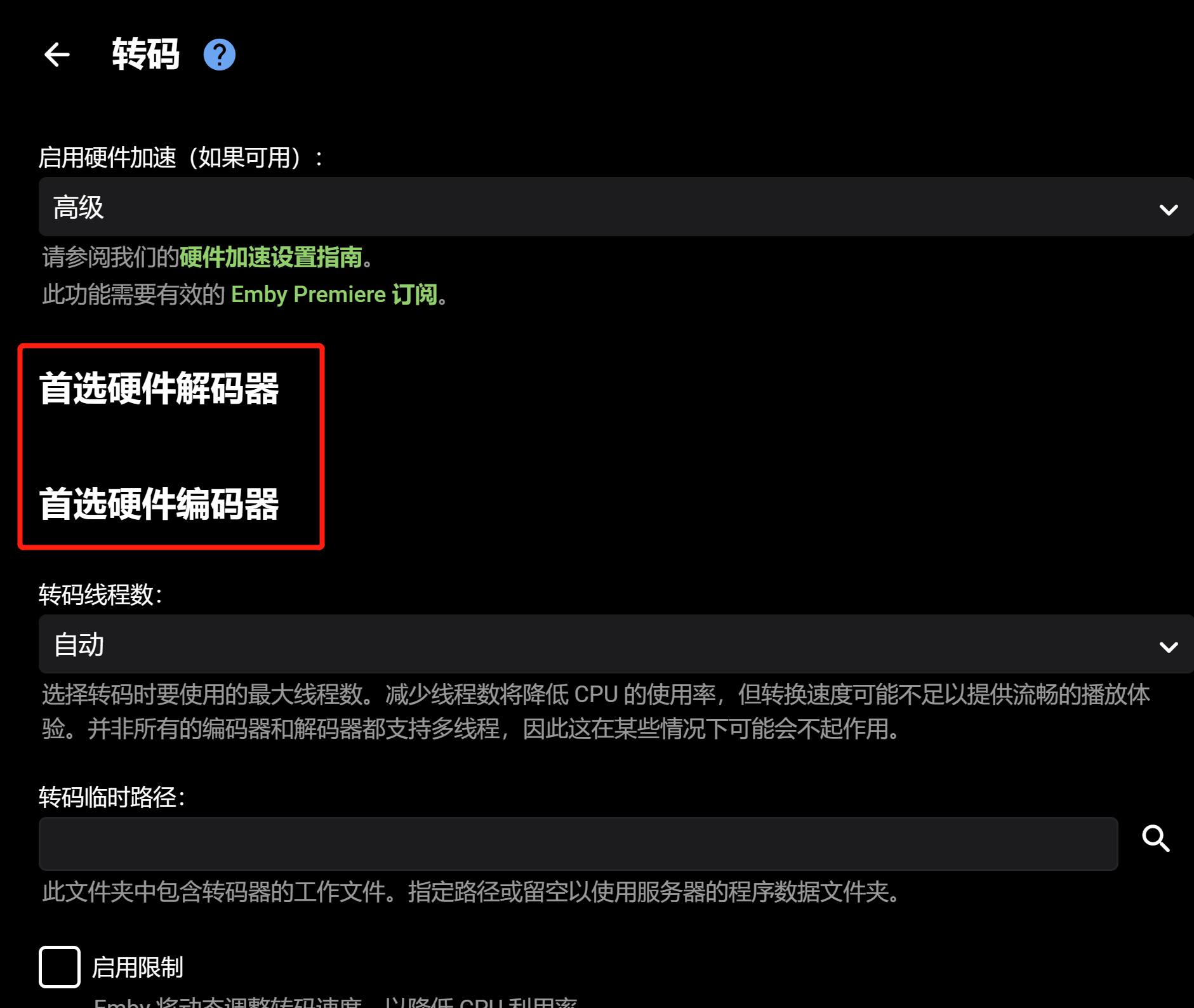

tianhaocheng 1 Posted May 3, 2023 Author Posted May 3, 2023 (edited) I just found an issue where there is no decoder option in transcoding Edited May 3, 2023 by tianhaocheng
tianhaocheng 1 Posted May 4, 2023 Author Posted May 4, 2023 Now I find that in the advanced transcoding settings, there is no decoder option. Attach the server logs. ffmpeg-transcode-d5030b86-a0ca-4f6b-91d8-10680a7bb72c_1.txt embyserver.txt
