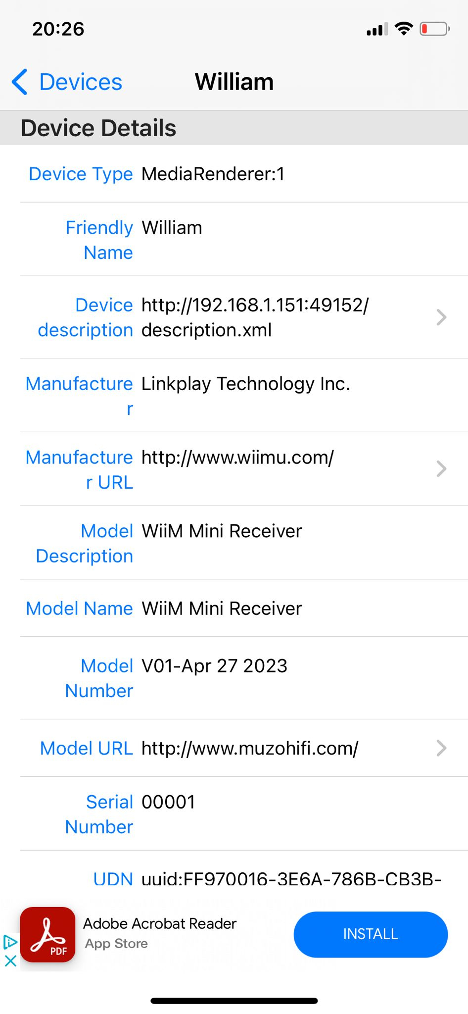

felahughes 2 Posted April 30, 2023 Posted April 30, 2023 Hi All I've set up Emby to serve music files to my Wiim Mini Streamer and it's frustratingly working nearly perfectly! When using the Wiim app, I can pull up the music and it all plays fine, at the full bitrate. I can also control the Emby server from the app no problem. However, the Emby app is much better so I'd like to get that to work. The problem is when I play from that it transcodes the stream to MP3 despite my setting up a DLNA device profile for the Wiim Mini. Looking at the logs, I can't tell if it's not seeing the device profile I've set up or seeing it and not getting the right settings. I was hoping the DeviceProfileID would help me find out what profile it was using (default or my custom one) but it seems to change with every server restart. Either way, the log says "TranscodeReasons=AudioCodecNotSupported". For the device profile, I've put the "Friendly Name" that I gave the Wiim as the identification data and confimed it's correct using a uPNP utility. I've added the audio codecs its supports and upped the max bitrate too. Any suggestions? 1

felahughes 2 Posted April 30, 2023 Author Posted April 30, 2023 And the xml for the device setup and how it's reported by a sniffer William.xml
