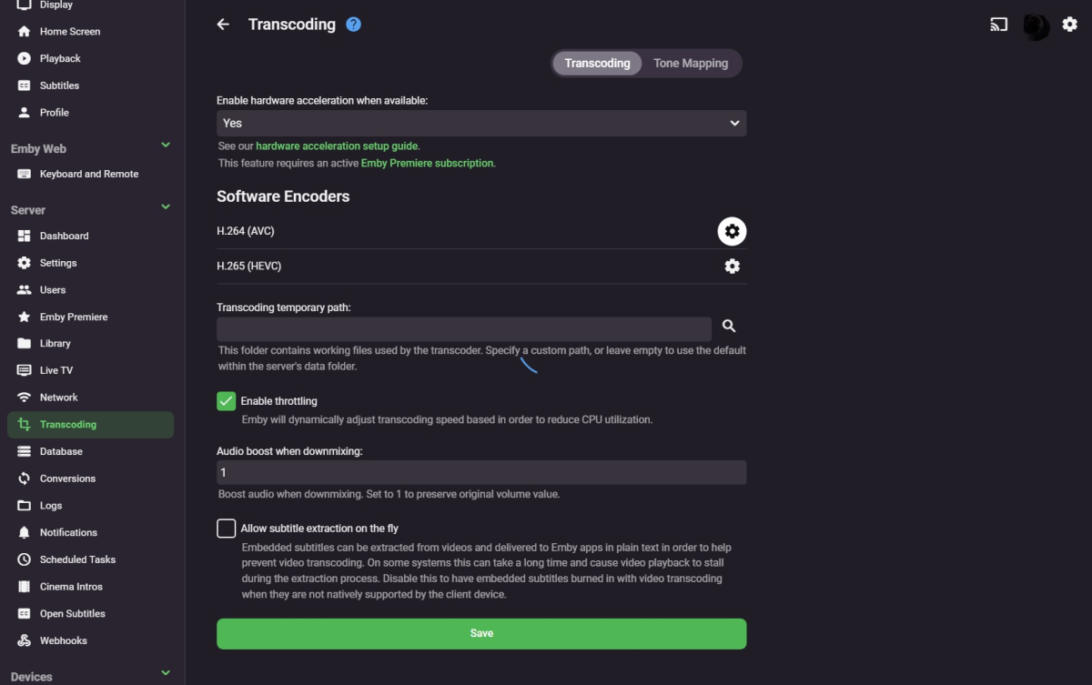

csadoian 36 Posted April 28, 2023 Author Posted April 28, 2023 20 minutes ago, Luke said: It's hard to pinpoint an obvious problem. If you turn off hardware transcoding in server transcoding settings, how does that compare? When I turn off hardware transcoding on the Server status screen under "Stream" it shows MPEGTS, second line shows HLS, third line says "Converting to compatible container". After a few seconds the last two messages go away and all that is left is MPEGTS and then the Roku displays the red banner "No compatible streams" and gives up. Interesting, on my Server Config Page, under Transcoding, I have Hardware transcoding set to NO. If I go down to the Software encoders and try to click on either one of the gear icons I get a spinning circle on my screen which goes on and on. Might there be something screwed up on my server? I've had my Emby server for a long time, at least 5 years of updates.

csadoian 36 Posted April 28, 2023 Author Posted April 28, 2023 19 minutes ago, Luke said: Can we see log examples of that? Thanks. 1. Restarted Emby Server 2. After about a minute I used Emby for Windows to go to the server dashboard. 3. Clicked on Trancoding, then clicked on the gear icon under Software Encoders, H.264 (AVC) 4. Spinning circle in the center of the screen. After about a minute I went back to the home screen, still had the spinning circle. 5. Shut down both Emby Server and restarted Emby Theater. 6. I should also mention I get the spinning circle when doing the same thing on Emby Theater on Linux Mint. embyserver-63818215217.txt

Solution Luke 42185 Posted May 1, 2023 Solution Posted May 1, 2023 On 4/28/2023 at 2:21 PM, csadoian said: Secondly, any thoughts on why I am get the spinning circle when attempting to configure the software Encoder? I originally set up my server back in 2018, so I'm thinking a fresh install might be in order. Thanks. What exactly are you doing? Is this with your built-in web app?
csadoian 36 Posted May 1, 2023 Author Posted May 1, 2023 13 minutes ago, Luke said: What exactly are you doing? Is this with your built-in web app? On the server dashboard, then transcoding. There is a section titled "Software Encoders", with H.264 and H.265 listed. They both have gear icons next to them, implying I can configure them. If I click on either one of the gear icons all I get is a spinning circle in the middle of my screen. This happens when using Emby Theater or through a browser like Chrome. However, the "Software Encoders" section is missing on Emby for Android 3.2.92. Perhaps it's not supposed to be there any more?
csadoian 36 Posted May 1, 2023 Author Posted May 1, 2023 28 minutes ago, Luke said: Is this your built in web app? Not sure what you mean by "built-in" web app. I am using Emby Theater for Windows 10 (downloadable, not the one through the Microsoft Store), and the other example was simply using Chrome to access the Emby Server dashboard/configuration. As mentioned in the previous message, if I go to my Android tablet and use Emby for Android to access the server dashboard, the section "Software Encoders" does not appear.
Luke 42185 Posted May 1, 2023 Posted May 1, 2023 OK those buttons should not be there for 4.7. We'll take a look at that.
