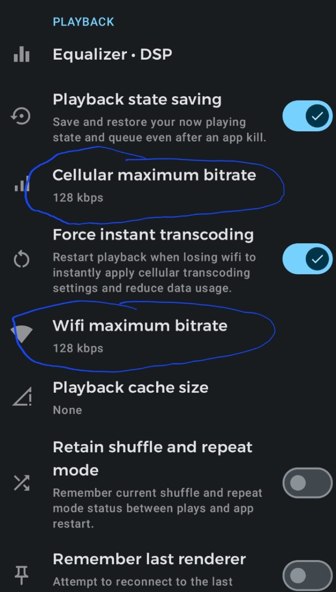

hendrysetiadi 1 Posted April 26, 2023 Posted April 26, 2023 Hi... It seems all my FLAC audio not transcoded into MP3 with lower bitrate. As you can see, it still played with FLAC format. Even i set on symfonium apk to play with only 128kb bitrate. But it still took high bandwidth. Thanks
hendrysetiadi 1 Posted April 26, 2023 Author Posted April 26, 2023 but i change it into 128kb bitrate, and check on the emby server seems not transcode all my FLAC files. what's wromg ?
hendrysetiadi 1 Posted April 26, 2023 Author Posted April 26, 2023 (edited) from this log, i see the flac files i played never being transcoded into mp3. this is the setting from symfonium apk ffmpeg-transcode-8b339352-c071-4c52-bda7-985c13ed81b8_1.txt Edited April 26, 2023 by hendrysetiadi

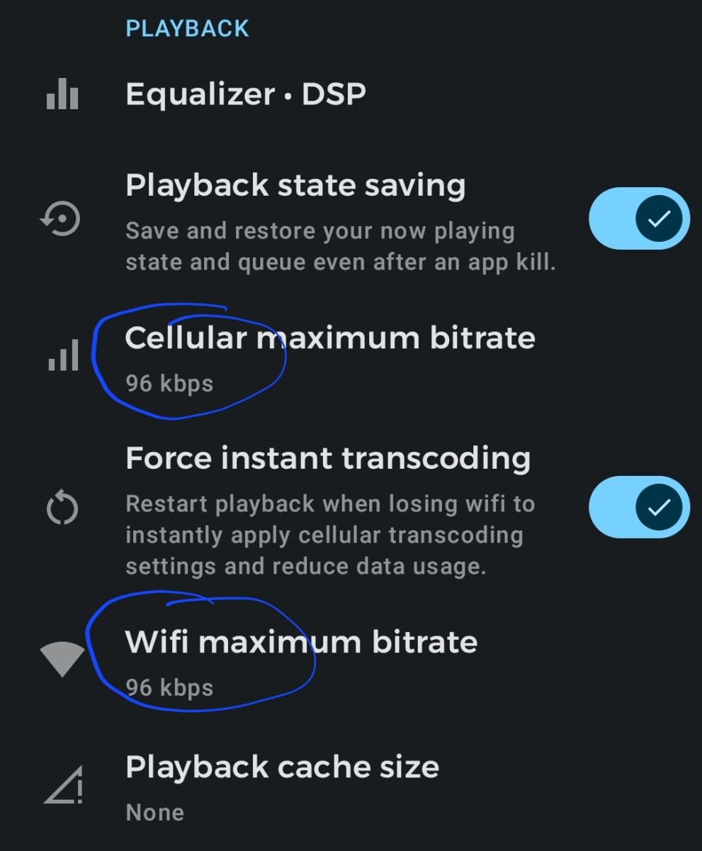

hendrysetiadi 1 Posted April 27, 2023 Author Posted April 27, 2023 10 hours ago, Luke said: Hi, you changed what exactly? Where? Here, from symfonium setting i set 96kbps bitrate for playing music files. But why on the emby screen showing only direct play not transcoding.. i'm afraid it still using full FLAC format which took much bandwidth for my mobile data. How to make sure it's really transcoded or not?
hendrysetiadi 1 Posted April 27, 2023 Author Posted April 27, 2023 6 hours ago, Tolriq said: Found this by luck via Google alert You should always contact me directly when issues with Symfonium. From the transcode logs there's proper transcoding, the Emby dashboard should say that it's transcoding. I'd need logs please open an issue at https://support.symfonium.app/c/support/5 and fill the template. So this issue related to emby server not from symfonium app side? What i need to know is, how to make sure it is really transcoded into mp3 or not? Because i search from the log didn't find mp3. On the emby page only show direct play not transcode.. it makes me worry to play FLAC files while it will force to use high bandwidth on my mobile data usage.

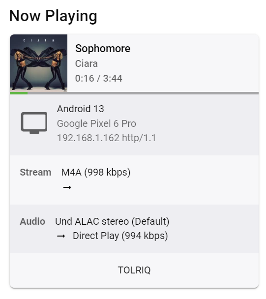

Tolriq 146 Posted April 27, 2023 Posted April 27, 2023 Ok so @Lukewas able to trigger a bug. When transcoding is ultra fast and finish before the first playback report the dashboard will fail. (Notice how the Stream does not display any value after the ->) 2023-04-27 09:24:36.890 Info Server: http/1.1 Response 200 to host1. Time: 1ms. http://192.168.1.80:8096/Items/148057/PlaybackInfo?UserId=6196d32f642f4a29886eefaef1ae5518&AutoOpenLiveStream=true&StartTimeTicks=0&MaxStreamingBitrate=131072 2023-04-27 09:24:36.970 Info Server: http/1.1 GET http://192.168.1.80:8096/audio/148057/stream.ogg?DeviceId=6CD5513EAB54D9DCCC60D70E7B25E44B&MediaSourceId=0d118f63f45be5987421e35f22b27fe9&PlaySessionId=4c2e5f3f06ea4d1f8d39b1bf2b16c353&AudioCodec=opus&AudioBitrate=131072&AudioStreamIndex=0&TranscodingMaxAudioChannels=6. UserAgent: Lavf/59.27.100 2023-04-27 09:24:36.977 Info App: ProcessRun 'StreamTranscode bc46c5' Execute: C:\Prog\Emby\system\ffmpeg.exe -loglevel +timing -y -print_graphs_file "C:\Prog\Emby\logs\ffmpeg-transcode-bc46c53a-84db-46c2-b4b9-cc92d72ec332_1graph.txt" -f mov,mp4,m4a,3gp,3g2,mj2 -c:v:0 mjpeg -i "F:\FakeLibrary2\02. Sophomore.m4a" -map 0:0 -vn -sn -c:a:0 libopus -ab:a:0 131072 -ac:a:0 2 "C:\Prog\Emby\transcoding-temp\D69F21\D69F21.ogg" 2023-04-27 09:24:38.067 Info Server: http/1.1 Response 200 to host1. Time: 1097ms. http://192.168.1.80:8096/audio/148057/stream.ogg?DeviceId=6CD5513EAB54D9DCCC60D70E7B25E44B&MediaSourceId=0d118f63f45be5987421e35f22b27fe9&PlaySessionId=4c2e5f3f06ea4d1f8d39b1bf2b16c353&AudioCodec=opus&AudioBitrate=131072&AudioStreamIndex=0&TranscodingMaxAudioChannels=6 2023-04-27 09:24:38.192 Info Server: http/1.1 GET http://192.168.1.80:8096/audio/148057/stream.ogg?DeviceId=6CD5513EAB54D9DCCC60D70E7B25E44B&MediaSourceId=0d118f63f45be5987421e35f22b27fe9&PlaySessionId=4c2e5f3f06ea4d1f8d39b1bf2b16c353&AudioCodec=opus&AudioBitrate=131072&AudioStreamIndex=0&TranscodingMaxAudioChannels=6. UserAgent: Symfonium/5.2.0 (Linux;Android 13) 2023-04-27 09:24:38.227 Info App: AppendExtraLogData - Read graph file: C:\Prog\Emby\logs\ffmpeg-transcode-bc46c53a-84db-46c2-b4b9-cc92d72ec332_1graph.txt 2023-04-27 09:24:38.227 Info App: AppendExtraLogData - Deserialized GraphData fileStream: 6 709,00 bytes Graph Count: 1 2023-04-27 09:24:38.227 Info App: AppendExtraLogData - File Deleted 2023-04-27 09:24:38.228 Info App: ProcessRun 'StreamTranscode bc46c5' Process exited with code 0 - Succeeded 2023-04-27 09:24:38.319 Info Server: http/1.1 POST http://192.168.1.80:8096/Users/6196d32f642f4a29886eefaef1ae5518/PlayingItems/148057/Progress?PositionTicks=0&MediaSourceId=0d118f63f45be5987421e35f22b27fe9&PlayMethod=Transcode&IsPaused=False&PlaySessionId=4c2e5f3f06ea4d1f8d39b1bf2b16c353. UserAgent: Symfonium/5.2.0 (Linux;Android 13) ffmpeg-transcode-bc46c53a-84db-46c2-b4b9-cc92d72ec332_1.txt

Tolriq 146 Posted April 27, 2023 Posted April 27, 2023 As I said you see on Symfonium side, it will display OPUS as the codec when it transcode. And yes the file is transcoded.

Tolriq 146 Posted May 1, 2023 Posted May 1, 2023 I use the one Emby provides from PlaybackInfo with a proper profile usually in the TranscodingUrl field. But the issue I explain in that post is really a race condition. Everything works, it's just that if the client app does not call PlayingItems before the transcoding is finished then the dashboard will failed as shown in the screenshot and logs. This can happen on fast servers for some apps like Symfonium that only start reporting playback when the playback actually starts and not during preparation / buffering. (Mostly for support of others servers that can fails during preparation but would still count a play count ... (not Emby))
