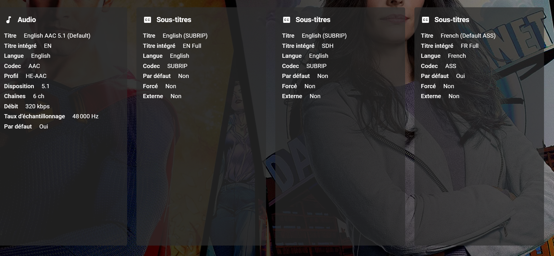

SamES 1084 Posted May 23, 2023 Posted May 23, 2023 14 hours ago, Moreje said: My LG app is still unable to play this codec : many image freezes. playback is OK on my PC (web player), so it sould not be on the server side. is there a future update of LG app who could fix that? Could you post the full mediainfo including all audio and subtitle streams? Is it just this file having an issue or are you having trouble with many/all files?
Moreje 16 Posted May 23, 2023 Author Posted May 23, 2023 This is the rest of mediainfo. this issue with all the episodes of this specific release... I suppose it is the way they are encoded. I have other h265 files that play well
SamES 1084 Posted May 23, 2023 Posted May 23, 2023 33 minutes ago, Moreje said: This is the rest of mediainfo. this issue with all the episodes of this specific release... I suppose it is the way they are encoded. I have other h265 files that play well Yes, if they are all from the same release then I would say you are right in that the issue is the way they are encoded. I can't see anything in the media info that should cause a problem. Try using MkvToolnix and copy all the streams to a new mkv file. It will be a quick stream copy and won't affect the quality, but rewriting the container might resolve the issue.
