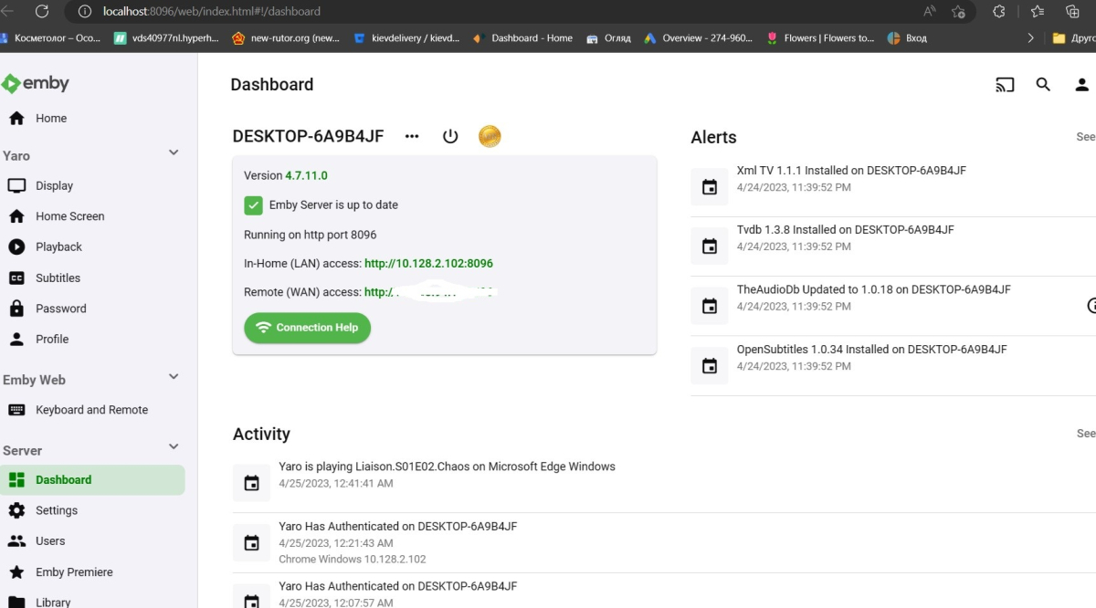

jarokruts 0 Posted April 25, 2023 Author Posted April 25, 2023 Hello. Thank you for the attention. Well, I do not know where and how to see the LAN address. This is the screenshot from Emby server configuration. If I need to look somewhere else - please let me know where and how.

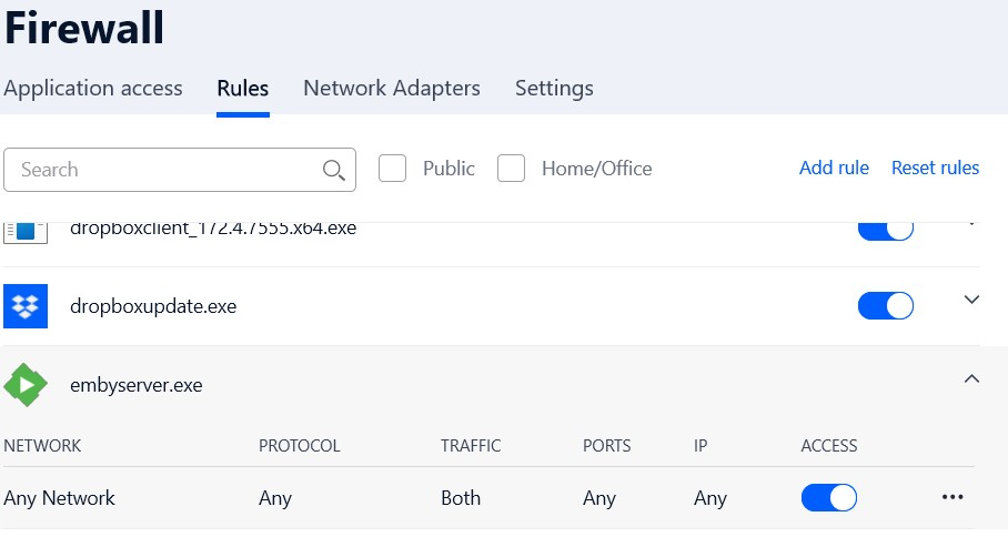

jarokruts 0 Posted April 25, 2023 Author Posted April 25, 2023 I do not see any problems. I have Bitdefend Security antivirus . I see its firewall granted access to all processes . What should I enter to "host:" when I try connect to server manually (as emby connect does not work, I click emby connect, then I enter login and password and it returns me to the same page )

jarokruts 0 Posted April 25, 2023 Author Posted April 25, 2023 I am trying to set up emby on Iphone. Please tell me if I am doing set up correct. I am attaching screen from my Iphone and also from Firewall

Luke 42185 Posted April 25, 2023 Posted April 25, 2023 22 minutes ago, jarokruts said: OK. Please be understanding that the answer to this is something specific to your environment and/or the hotel network, so you'll have to forgive me when I say "I don't know". But this typically comes down to firewall blocking the incoming connection. I would probably suggest completely turning off BitDefend to rule it out as a source of the issue.

Luke 42185 Posted April 25, 2023 Posted April 25, 2023 2 minutes ago, jarokruts said: Hello again. You said For now the easiest test I would focus on is without Emby Connect and just putting the in-home address into the browser address bar of a different device What kind of address to put ? What is in-home address ? I have iphone and ipad . In the first screenshot you provided at the top of this page, in the server dashboard where it says In-Home (LAN) address...put that into the address bar of your web browser on your smart phone. Make sure the phone is connected to the same wifi network.
