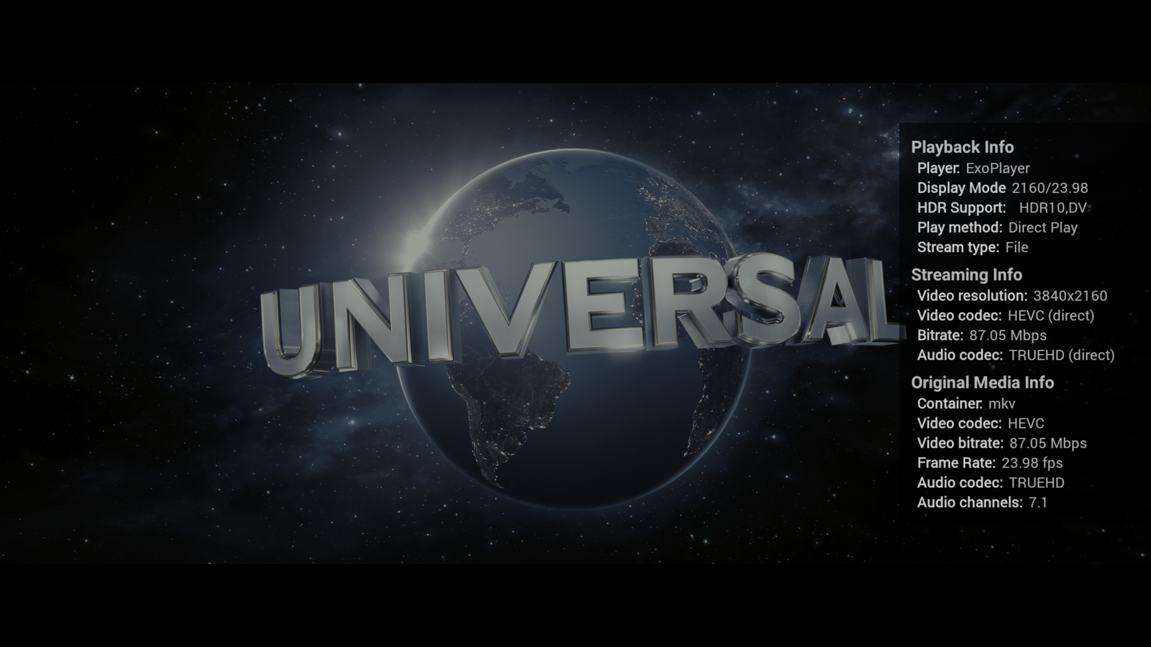

rbjtech 5345 Posted April 24, 2023 Posted April 24, 2023 (edited) 16 hours ago, justinrh said: I need some nerdy explanation about stats for nerds. I use the Android TV app on my Shield. It shows the output for the video. Is this output what Emby is sending, what the player is playing, or what the TV system is actually doing? SFN in AndroidTV shows more useful info then SFN on the Standard Android App - especially for TV usage. The Original Media Info is shown (how it appears in MediaInfo), Streaming Info (showing what emby is doing to it - if anything) and importantly, it also shows the Playback Info - including the capabilities of the TV, Display mode incl Refresh Rate being used - and the Stream type. So if you have Refresh rate matching on for example - it should be showing the Display mode as 2160/23.98 for example. Stream Type is also important for me to show 'File' as opposed to 'http'. Everything should say 'Direct' in Streaming Info - if not, then for me there is an issue as the playback is being modified. I think some of this extra info has been requested to be added to the Standard App. Quick comparison below of the 3 Android Clients playing a 4K remux at maximum capability - a) - Android TV (single Press and Hold of the OK Button) b) Android c) WMV for Android imo - AndroidTV still reigns supreme but it is nice that Android shows the track Titles - that is useful if they are present, consistent and correct .. Edited April 24, 2023 by rbjtech 1 2

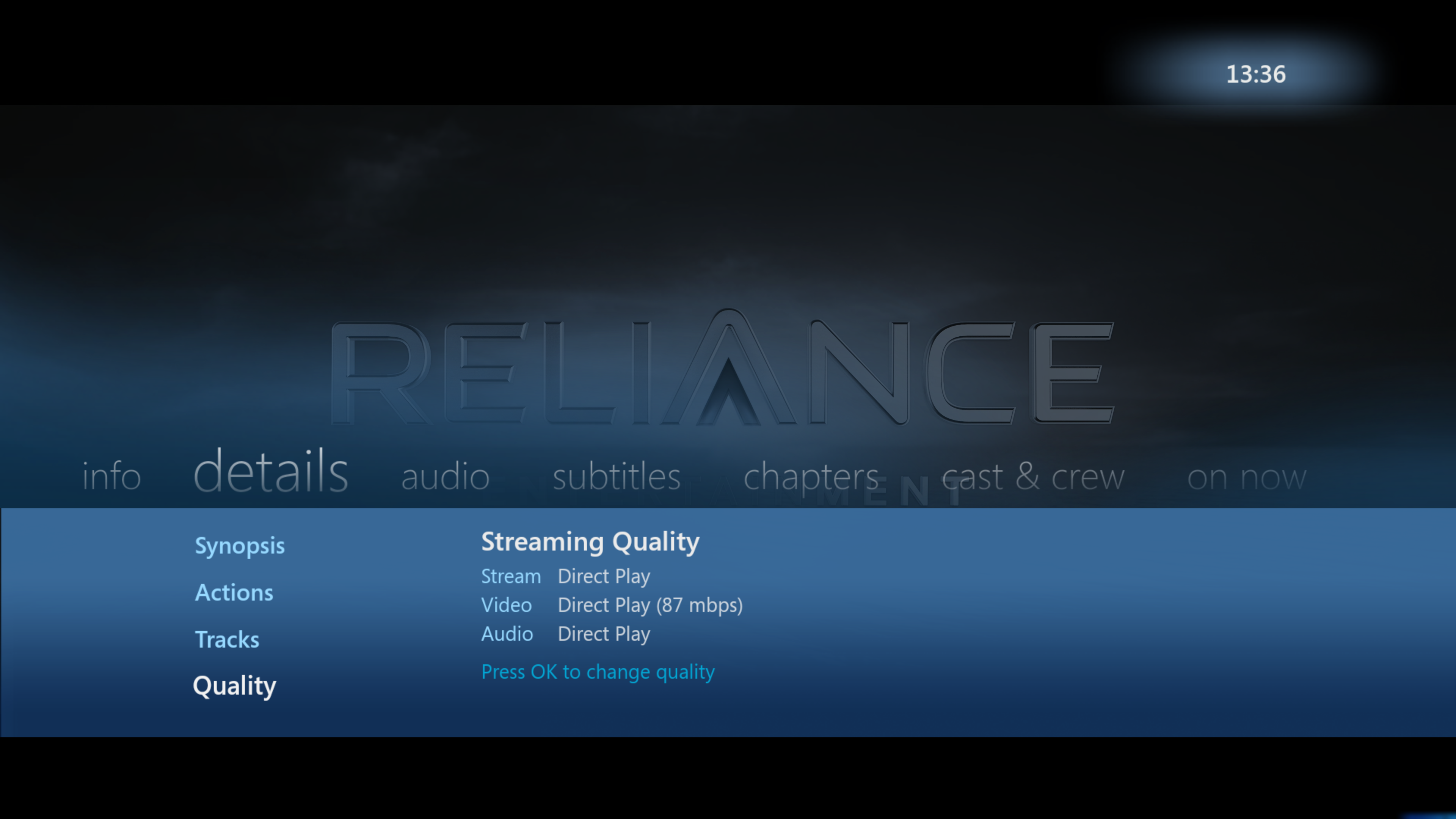

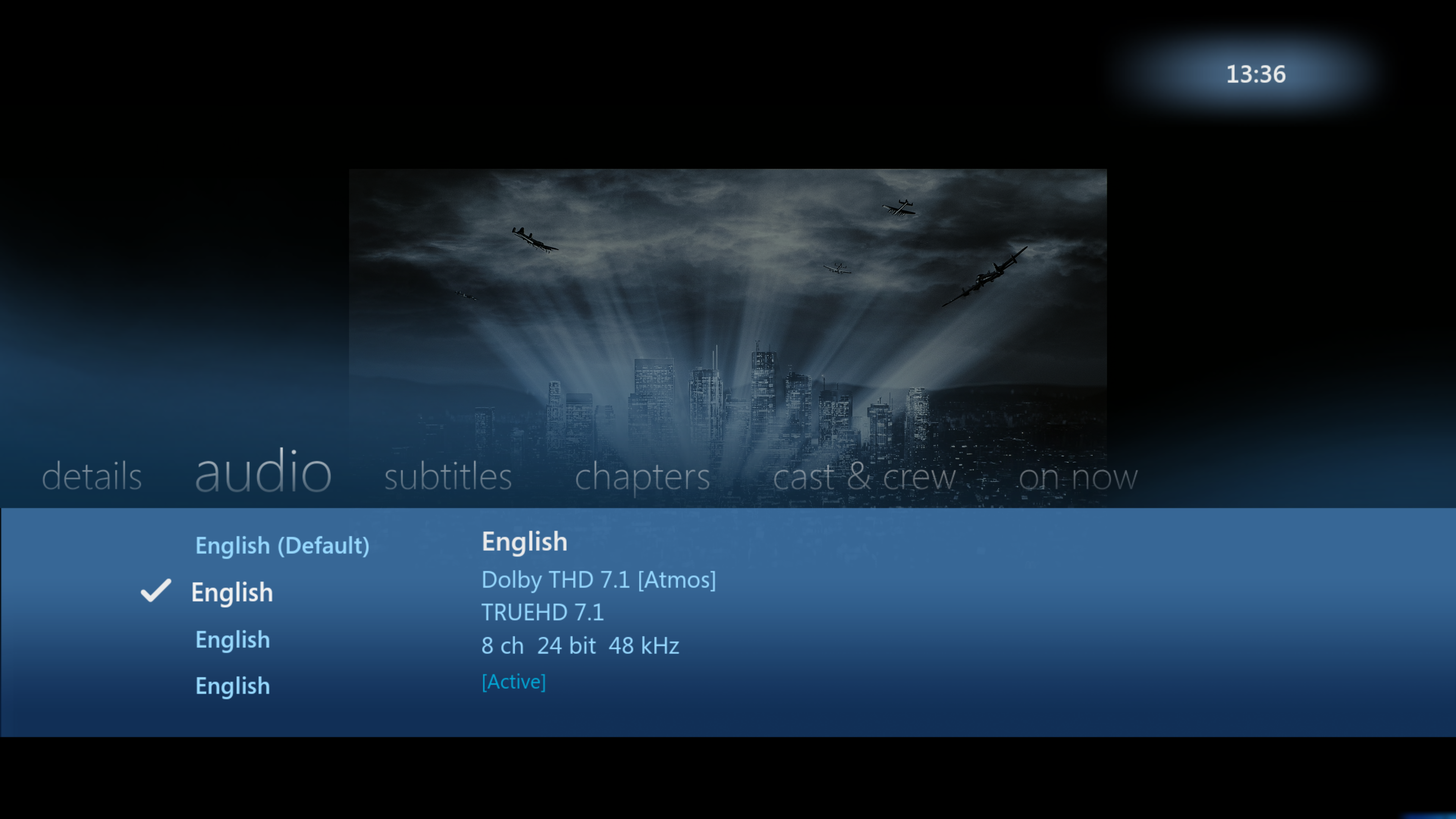

arrbee99 1836 Posted April 24, 2023 Posted April 24, 2023 ATV app is superior in pretty much everything... WMV is this - 2 1 1
