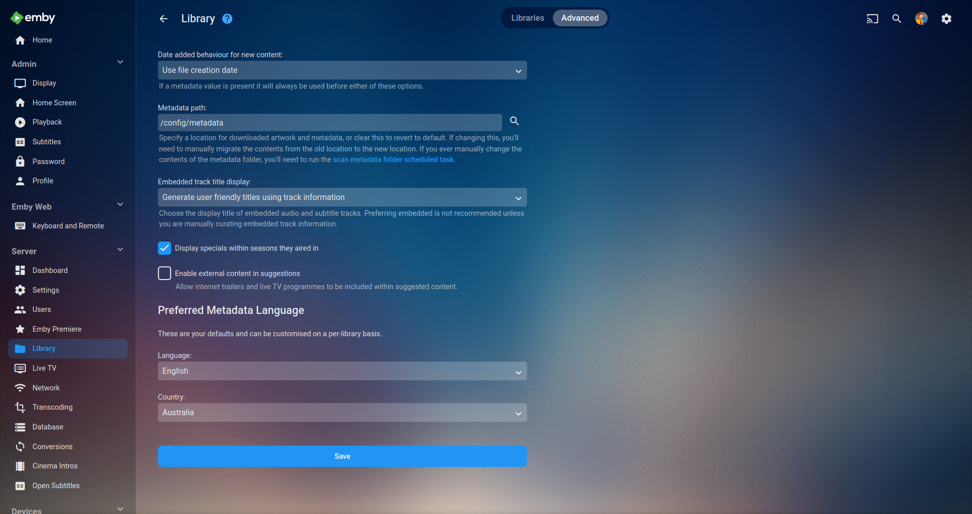

gothicaria 5 Posted April 23, 2023 Posted April 23, 2023 Hi There, I have my rating classification country set to AU and for the meta data to grab AU ratings but alot of my movies are still rated using US ratings so when I try to use the parental feature to block anything AU-RA18+ and above from my sons account it will hide anything without an AUS classification. Im not sure what im doing wrong here as from what I have read it should still take the rating into account regardless of the rating local? Your help is appreciated

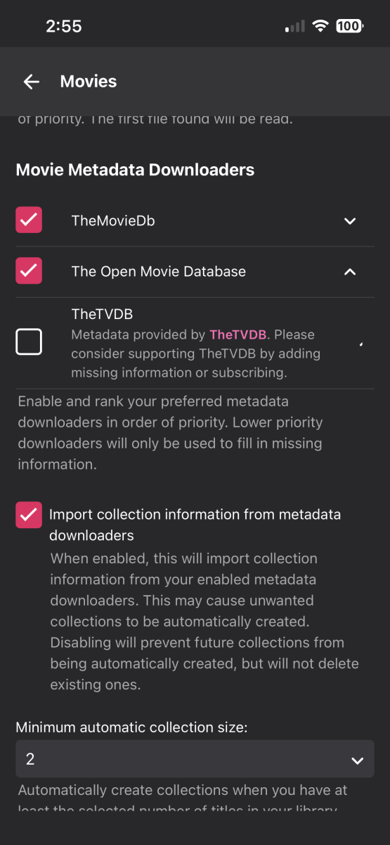

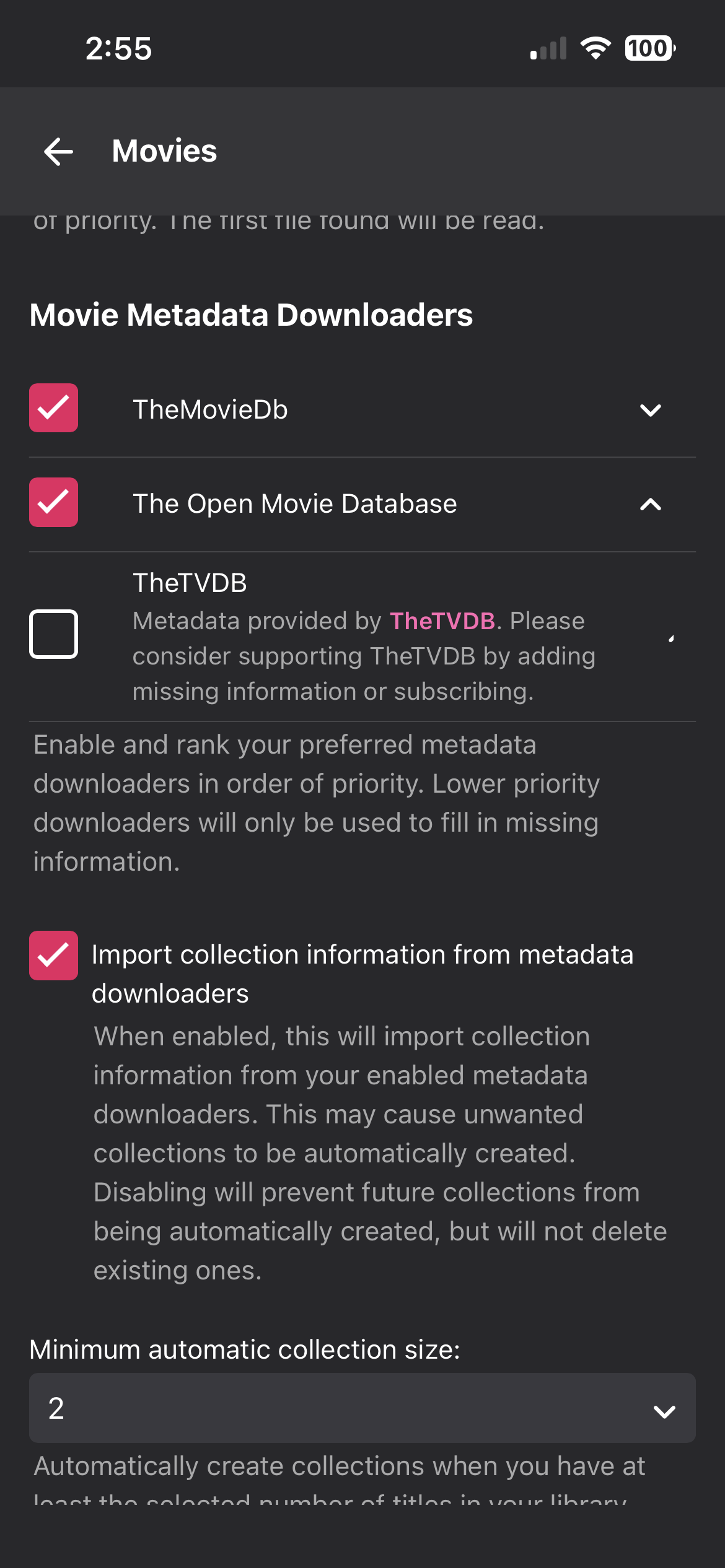

gothicaria 5 Posted April 23, 2023 Author Posted April 23, 2023 1 minute ago, seanbuff said: Grim is right, no one provider will have all movie ratings in AU, but TMDB does have majority (which provider do you have set for priority?) I have spent countless hours contributing to TMDB for titles that did not have AU ratings so that others may benefit. Are you saying none of your movies are pulling down AU ratings? Do you have some examples? Some of them do but still a lot of them with US ratings. This is my movie priority settings
Junglejim 385 Posted April 23, 2023 Posted April 23, 2023 52 minutes ago, gothicaria said: Hi There, I have my rating classification country set to AU and for the meta data to grab AU ratings but alot of my movies are still rated using US ratings so when I try to use the parental feature to block anything AU-RA18+ and above from my sons account it will hide anything without an AUS classification. Im not sure what im doing wrong here as from what I have read it should still take the rating into account regardless of the rating local? Your help is appreciated Yeah I have the same problem, especially with TV Shows. It usually grabs the US ratings if there is no AU (TV-PG, TV-MA.. etc.). Not so much with movies, they usually get the right AU rating. It's a pain with some tvshows though. 42 minutes ago, GrimReaper said: That's how it's supposed to work, ratings get weight assigned and are practically country-independent for processing, so if it doesn't work for you specific example would be needed. As @gothicariastated I don't think this works as intended (ratings get weight assigned and are practically country-independent for processing), at least for AU ratings anyway.

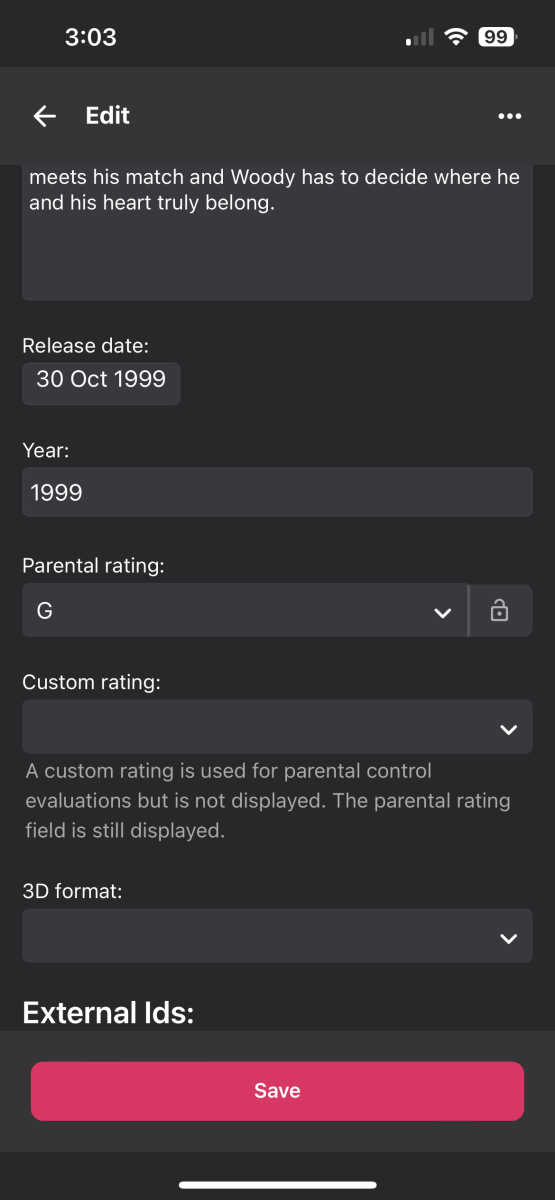

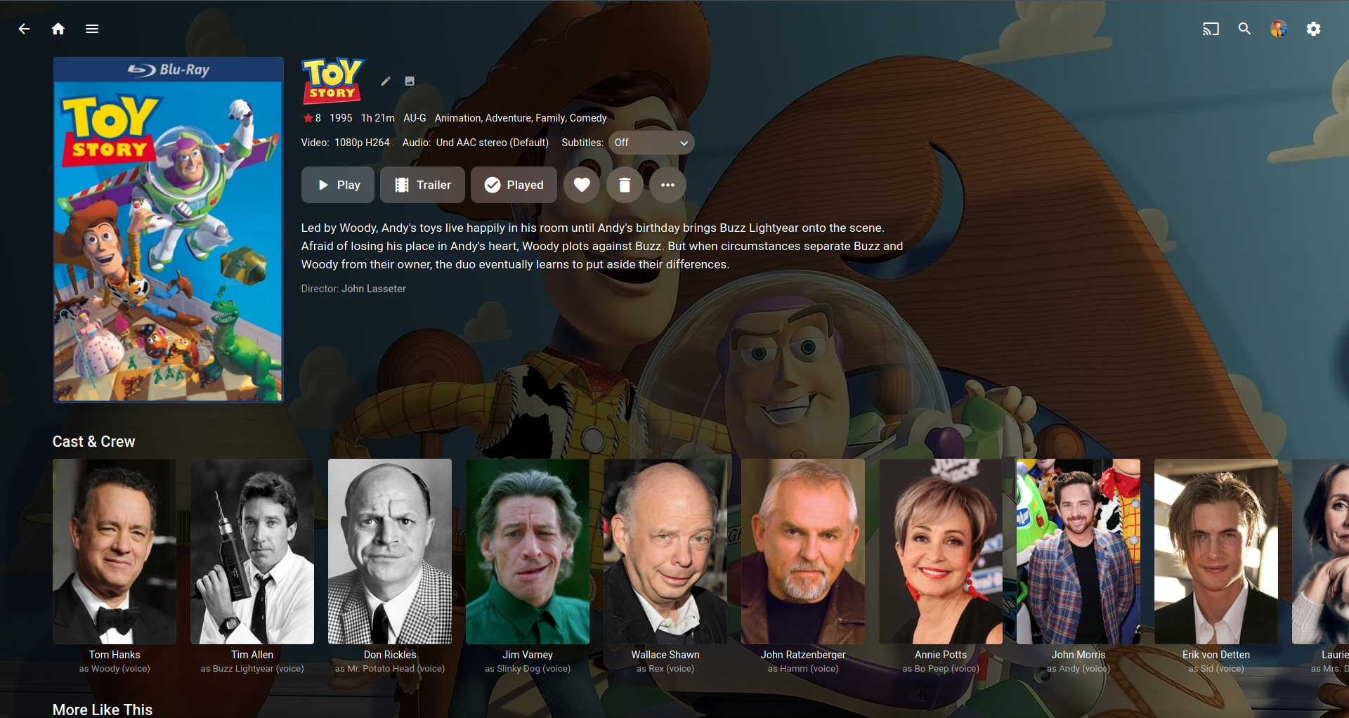

gothicaria 5 Posted April 23, 2023 Author Posted April 23, 2023 5 minutes ago, seanbuff said: So Toy Story has pulled G instead of AU-G
gothicaria 5 Posted April 23, 2023 Author Posted April 23, 2023 16 minutes ago, seanbuff said: Grim is right, no one provider will have all movie ratings in AU, but TMDB does have majority (which provider do you have set for priority?) I have spent countless hours contributing to TMDB for titles that did not have AU ratings so that others may benefit. Are you saying none of your movies are pulling down AU ratings? Do you have some examples? I can’t see TMDB as an option for Metadata in plugins? Is there another way to set up to use it?
seanbuff 1360 Posted April 23, 2023 Posted April 23, 2023 2 minutes ago, gothicaria said: I can’t see TMDB as an option for Metadata in plugins? Is there another way to set up to use it? You're already using it TheMovieDb = TMDB
gothicaria 5 Posted April 23, 2023 Author Posted April 23, 2023 1 minute ago, seanbuff said: You're already using it TheMovieDb = TMDB Oh ok cool

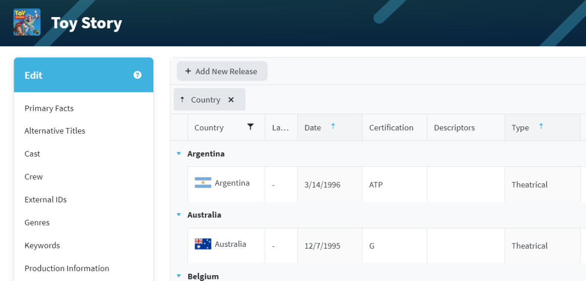

seanbuff 1360 Posted April 23, 2023 Posted April 23, 2023 5 minutes ago, gothicaria said: So Toy Story has pulled G instead of AU-G That's odd, as that title definitely has the correct AU metadata and rating on TMDB. And you have this set in your 'Movies' library settings?
Junglejim 385 Posted April 23, 2023 Posted April 23, 2023 1 minute ago, seanbuff said: That's odd, as that title definitely has the correct AU metadata and rating on TMDB. And you have this set in your 'Movies' library settings? I don't do per library settings and just use the advanced setting, is that maybe a problem?
gothicaria 5 Posted April 23, 2023 Author Posted April 23, 2023 6 minutes ago, seanbuff said: That's odd, as that title definitely has the correct AU metadata and rating on TMDB. And you have this set in your 'Movies' library settings? Yep that’s exactly how I have it
gothicaria 5 Posted April 23, 2023 Author Posted April 23, 2023 3 minutes ago, Junglejim said: I don't do per library settings and just use the advanced setting, is that maybe a problem? I have both set up just in case
seanbuff 1360 Posted April 23, 2023 Posted April 23, 2023 I just added this movie to a test library of mine, and it just pulled in the correct metadata without mods Quote <rating>8.3</rating> <year>1995</year> <sorttitle>Toy Story</sorttitle> <mpaa>AU-G</mpaa> <imdbid>tt0114709</imdbid> <tmdbid>862</tmdbid> <premiered>1995-10-30</premiered> <releasedate>1995-10-30</releasedate> Not sure what else it could be?

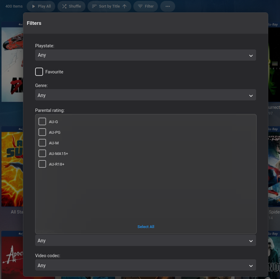

seanbuff 1360 Posted April 23, 2023 Posted April 23, 2023 As a test, under a users profile - what list of ratings do you have in 'Parental Control' tab?
Junglejim 385 Posted April 23, 2023 Posted April 23, 2023 5 minutes ago, seanbuff said: As a test, under a users profile - what list of ratings do you have in 'Parental Control' tab? My 'Parental Control' tab looks exactly the same as yours. 1
Junglejim 385 Posted April 23, 2023 Posted April 23, 2023 (edited) Not sure why there is a "AU-M15+" classification, there is no such AU rating and I have no movies with that rating. Edited April 23, 2023 by Junglejim
seanbuff 1360 Posted April 23, 2023 Posted April 23, 2023 6 minutes ago, Junglejim said: Not sure why there is a "AU-M15" classification, there is no such AU rating and I have no movies with that rating. Yeah true, not sure where that one came from 1
GrimReaper 4927 Posted April 23, 2023 Posted April 23, 2023 (edited) 1 hour ago, gothicaria said: So Toy Story has pulled G instead of AU-G Do a Refresh Metadata>Replace All on that item, maybe there wasn't AU rating at the time of initial import and someone like Sean added it at a later point for community benefit. Edited April 23, 2023 by GrimReaper 1
gothicaria 5 Posted April 23, 2023 Author Posted April 23, 2023 14 minutes ago, GrimReaper said: Do a Refresh Metadata>Replace All on that item, maybe there wasn't AU rating at the time of initial import and someone like Sean added it at a later point for community benefit. I did the latest refresh today with no changes My parental ratings are the same as both of you guys as well. Could radarr be messing with these values?
Junglejim 385 Posted April 23, 2023 Posted April 23, 2023 1 hour ago, gothicaria said: So Toy Story has pulled G instead of AU-G Just added this movie to test the AU classification and it pulled the AU rating for me, same as @seanbuff...
