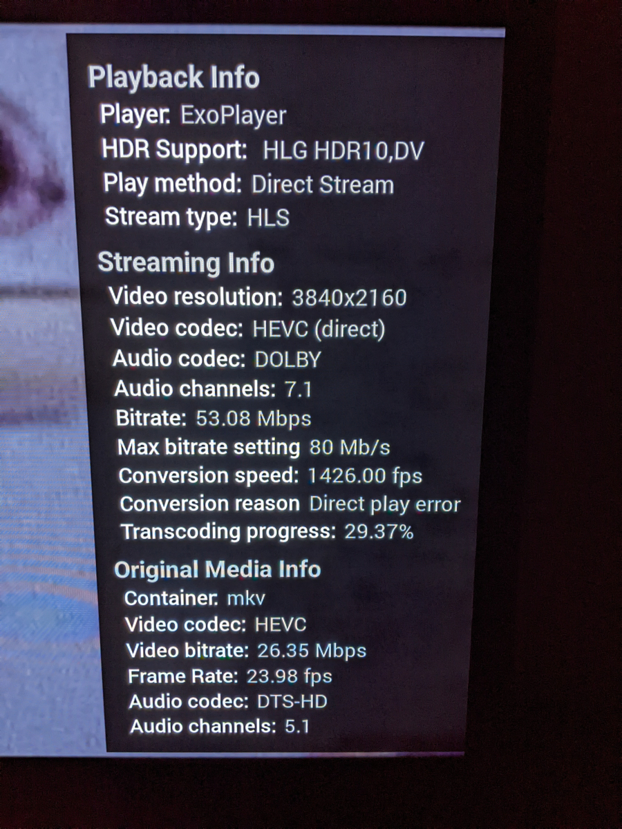

musicmafia 38 Posted April 22, 2023 Posted April 22, 2023 (edited) FINALLY got a 4K TV (woohoo!) but ran into a hiccup. I mostly use Fire Stick 4K on my TV and I have strong signal and more than enough speed for 4K. Netflix and others are streaming fine in 4K via Fire Stick. I went to test my Emby 4K files (which I also play on TV via Fire Stick) and I've only tested 4 files so far, but one (Babylon) only played audio. For troubleshoot, I went to my PC and the same file plays fine in VLC and plays fine on Emby on the desktop. I'll be testing more 4K files today and hoping this was an isolated incident. Until then, any ideas what might be going on? Thanks Edited April 22, 2023 by musicmafia

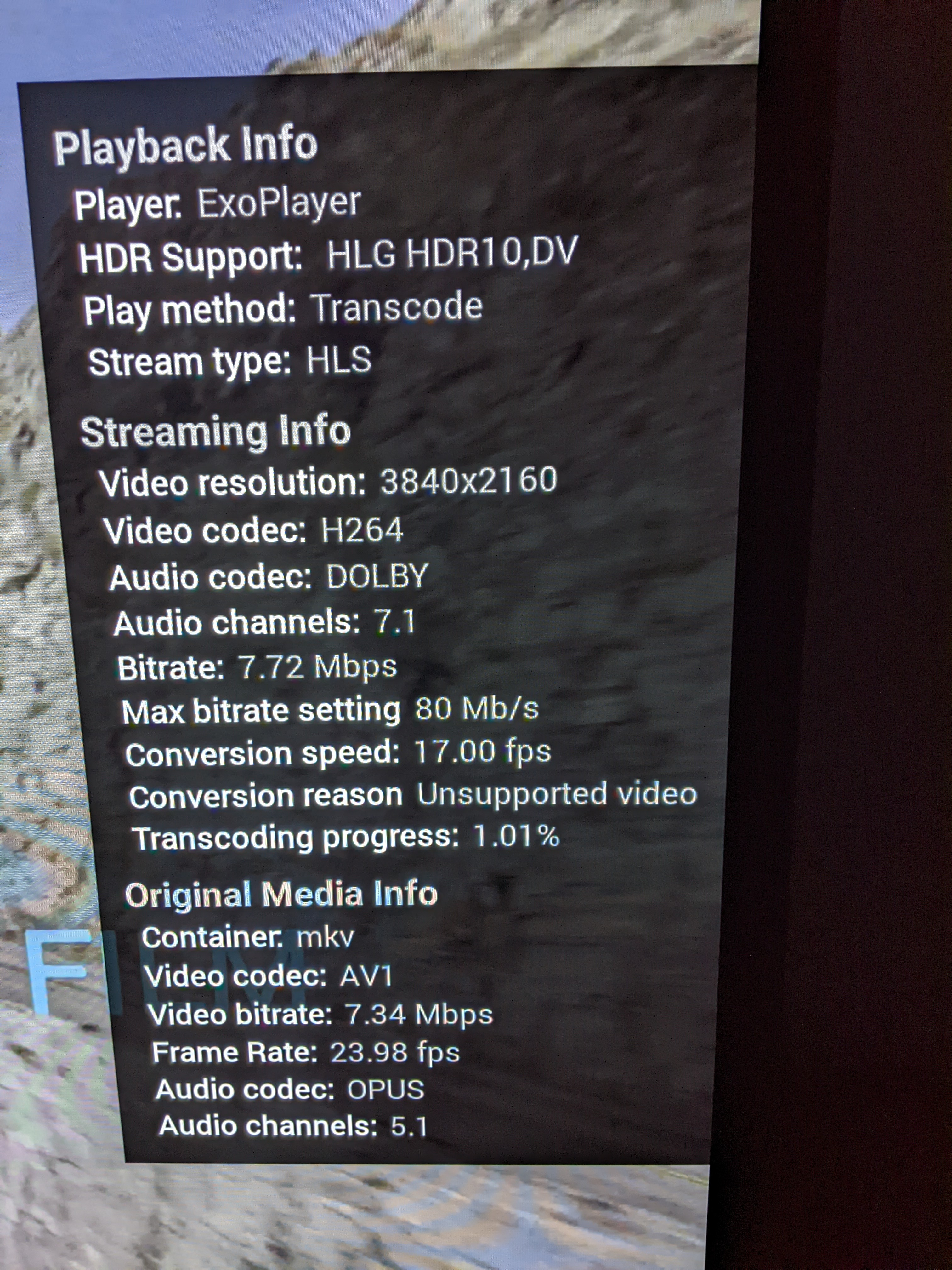

musicmafia 38 Posted April 24, 2023 Author Posted April 24, 2023 (edited) 21 hours ago, rbjtech said: The FireTV (AndroidTV) client has no issues playing 4K in general, so it may be the files and/or emby server configuration. Did emby try and transcode the file or was it direct playing ? (look in stats for nerds, press and hold the FireTV 'ok' button - same again to remove it). Here are the stats on those two files. Thanks for your help. Edited April 24, 2023 by musicmafia
rbjtech 5347 Posted April 24, 2023 Posted April 24, 2023 ok - so in the first example - it can't play the video for some reason and the transcode speed is too low to sustain proper playback (fps is less than the source file). In the 2nd the video is Direct, but the Audio is being transcoded from DTS-HD to AC3. Try using more stream friendly sources - with EAC3 Audio and maybe lower bitrate HEVC Video. (or convert them).
VirulentPip 93 Posted April 24, 2023 Posted April 24, 2023 Yeah 1st is due to it being AV1 and the current build not correctly sending info that AV1 can be HW Decoded, so instead of falling back to SW Decoding on the stick (which would be bad) it's now transcoding it, which is the correct behaviour, however your server seems to not be able to do this well. Hopefully the issues with AV1 are sorted soon with the Firestick Max and Cube Gen 3 - Unless it's not the Max you have, then there's nothing wrong as it cannot decode AV1.

VirulentPip 93 Posted April 27, 2023 Posted April 27, 2023 AV1 in general is a tricky one at the moment, since getting a 4K Max and Cube Gen 3 I've had no end of issues with AV1 being detected as being able to be played back via Hardware Decoding, it either transcodes to H264 or enables software decoding which then juddering occurs. As far as your HEVC file which is much more supported, it's the DTS-HD audio that wasn't on your device. So it all depends what you want, AV1 should work eventually with Emby properly with devices that support it, however HEVC is much better supported (and the default codec for 4K), the Nvidia Shield Pro 2019 although doesn't support AV1 it does support pretty much every audio codec you throw at it and it also has a Gigabit Ethernet port so that high bitrate 4K (HEVC/H265) files aren't an issue. 1
rbjtech 5347 Posted April 27, 2023 Posted April 27, 2023 3 hours ago, VirulentPip said: AV1 in general is a tricky one at the moment, since getting a 4K Max and Cube Gen 3 I've had no end of issues with AV1 being detected as being able to be played back via Hardware Decoding, it either transcodes to H264 or enables software decoding which then juddering occurs. As far as your HEVC file which is much more supported, it's the DTS-HD audio that wasn't on your device. So it all depends what you want, AV1 should work eventually with Emby properly with devices that support it, however HEVC is much better supported (and the default codec for 4K), the Nvidia Shield Pro 2019 although doesn't support AV1 it does support pretty much every audio codec you throw at it and it also has a Gigabit Ethernet port so that high bitrate 4K (HEVC/H265) files aren't an issue. Agree - I had a dabble with AV1 and while I got the Fire TV 4K Max to Direct play - it was only on the Android App and that was the only device in my household that could. The Shield attempted it in s/w - but it was so slow it was unusable - and that was @ 1080p - so useless for 4K. On the flipside, HEVC 4K direct plays on everything I have on all Apps with zero issues ..
