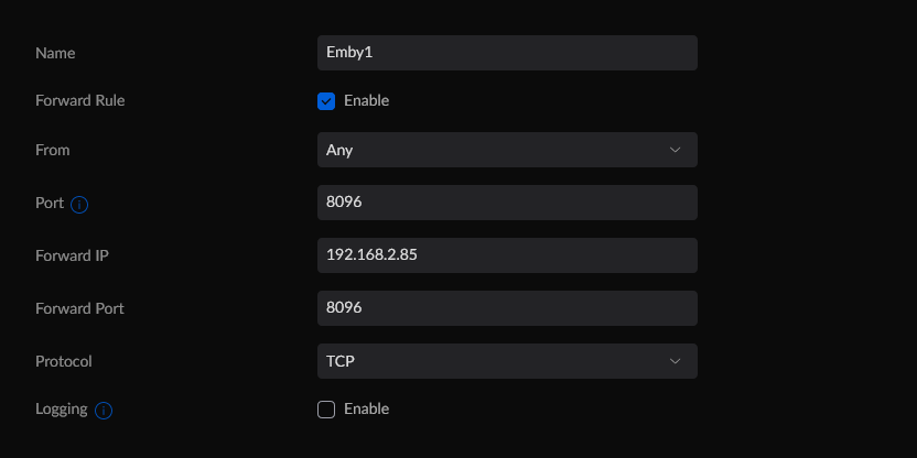

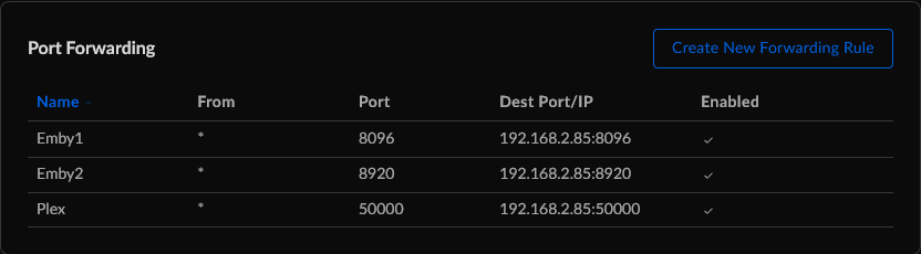

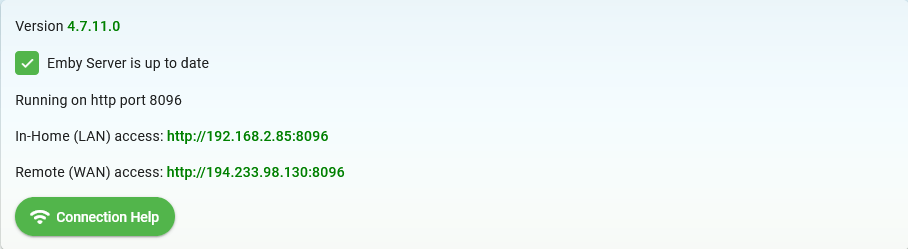

Luke 42185 Posted April 22, 2023 Posted April 22, 2023 How did you locate your external address? Can you show a screenshot of the port forwarding you configured in your router?
Big Daddy A 2 Posted April 24, 2023 Author Posted April 24, 2023 From the dashboard. I wasn't clear on whether the port forwarding needing to be on the LAN or WAN (figured LAN though) address....but tried with both.

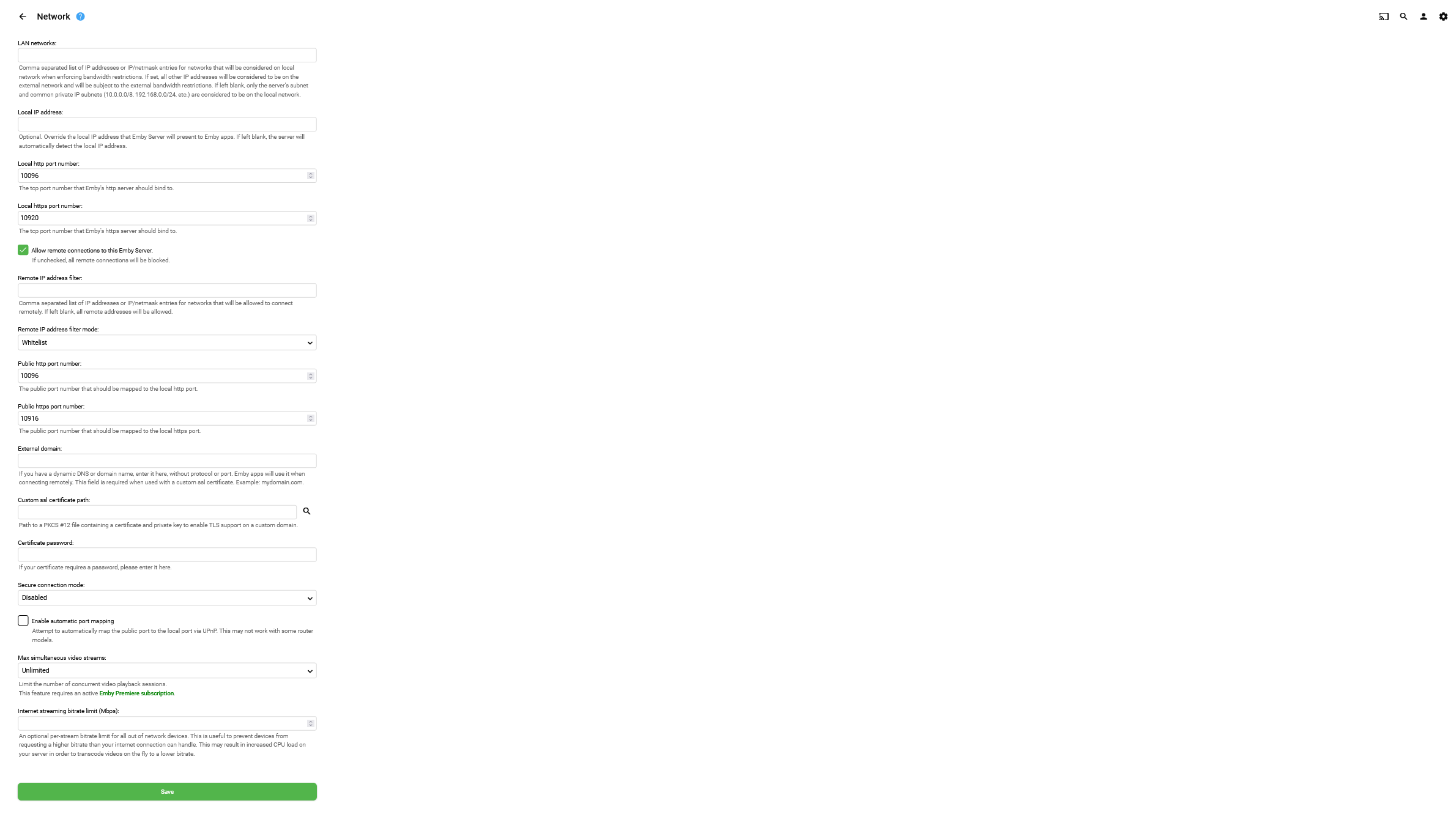

Luke 42185 Posted April 26, 2023 Posted April 26, 2023 Have you customized any emby server network settings?
Big Daddy A 2 Posted April 26, 2023 Author Posted April 26, 2023 Not other what I put in my initial post. I did just try changing the ports to see if that would help....it didn't. And yes I did change them in the port forwarding also.

Guest Posted April 29, 2023 Posted April 29, 2023 A few things to try/look at. First, reboot the server machine and see if the IP has changed. Second, in the UDM, check the rules and make sure that it's accepting. Third, turn on allow logging. I see you have it disabled.
