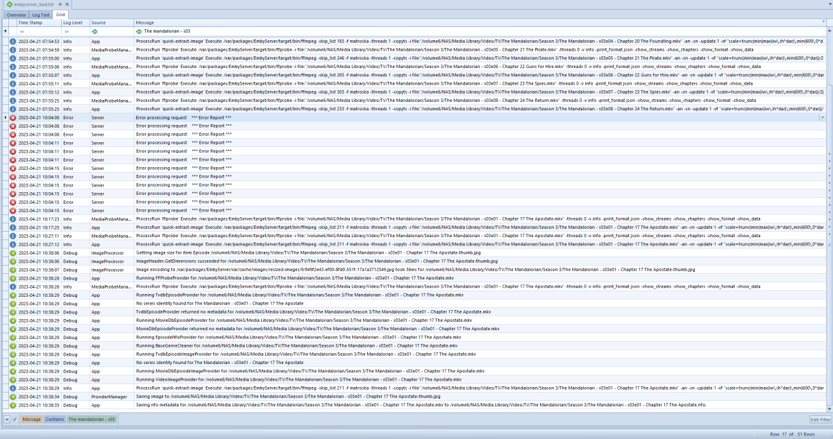

ChrisJ60 13 Posted April 21, 2023 Posted April 21, 2023 Having a problem getting Emby to find the metadata for The Mandalorian Season 3. We have Season 1 and 2 already and the automatic metadata lookup worked fine for those. We added Season 3 (files are same type and have the same naming conventions as S1/S2 etc.) but the queries to TheTVDB seem to not find a nothing (as far as I can discern from the debug log). Yet if I go to TheTVDB site the series is there. We're able to add other show series/episodes and the metadata lookup works just fine. Only The Mandalorian Season 3 seems to have an issue. It's perplexing. Debug log attached (issue is near the end). Anyone have any ideas? Thanks! embyserver_bad.txt

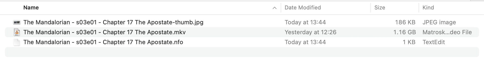

ChrisJ60 13 Posted April 21, 2023 Author Posted April 21, 2023 Those messages are old and represent Emby trying to delete files that had already been removed external to Emby. Attached is a new debug log - look at the entries from '2023-04-21 13:43:21.525'. Everything looks fairly normal other than that the metadata lookups return 'no metadata found'. Emby quite happily reads the file (the various ffprobe commands succeed) and writes extracted artwork and an NFO file, so no permissions issues. embyserver.txt

rbjtech 5335 Posted April 21, 2023 Posted April 21, 2023 Hmm - very odd - emby itself is picking up the files fine, but it's reporting the Providers cannot identify it. Do you have an NFO's etc - worth deleting ALL files except for the video files. I would also remove, run scan library and scan metadata (in schedule), trim/vaccum the db, restart and then try and add again.

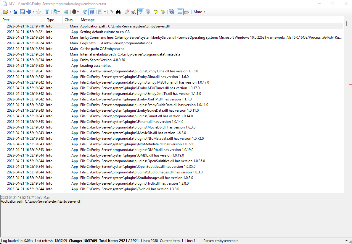

rbjtech 5335 Posted April 21, 2023 Posted April 21, 2023 4 hours ago, GregMo said: That's a very slick looking viewer you're using. What is it? Emby Official Support Tools ... but there are many alternatives that I use - Advanced Log Viewer with an emby log parser is actually much more powerful, but the Emby Support Tools are integrated with the forums to auto download the log files - making it all very quick .. The good news is the logs are a pretty generic 'standard' so most log viewers can likely read (and filter) them live. 1
