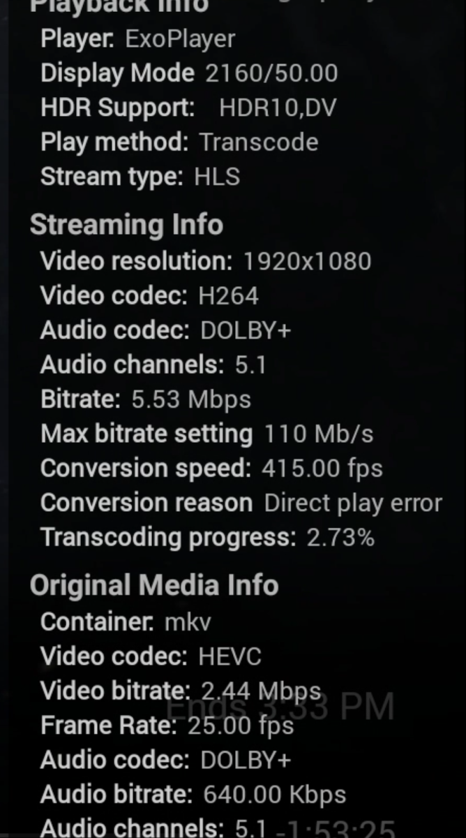

unmovable 20 Posted April 18, 2023 Posted April 18, 2023 Emby on shield is transcoding some DV/HDR titles. Logcat shows exoplayer errors, but nothing to work on from there. Same title works properly with Kodi Logs: https://gist.github.com/grapexy/17b8cea553822ef8fc085f75e56b2614#file-ffmpeg-directstream-14f483ec-53f4-409b-82e0-8f6bfce10668_1-txt https://gist.github.com/grapexy/17b8cea553822ef8fc085f75e56b2614#file-ffmpeg-transcode-283e6d92-b4d0-4c24-8111-9300328dfd56_1-txt https://gist.github.com/grapexy/17b8cea553822ef8fc085f75e56b2614#file-logcat-txt

ebr 16337 Posted April 18, 2023 Posted April 18, 2023 There is some sort of unspecified loading error when we try to direct play it. As a wild guess, if you remux this item to NOT have like 40 subtitle tracks, does that make a difference?
unmovable 20 Posted April 18, 2023 Author Posted April 18, 2023 2 hours ago, ebr said: There is some sort of unspecified loading error when we try to direct play it. As a wild guess, if you remux this item to NOT have like 40 subtitle tracks, does that make a difference? Remuxed, leaving just 1 subtitle stream, but the issue persists.
