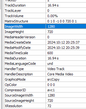

Teredactle 39 Posted October 22, 2024 Author Posted October 22, 2024 Ok, so I did a bit more digging - on a video from iPhone without any type of re-encoding, it's in MP4 format. If I take a look at this file under ExifTool(GUI) I see the following: and under Emby I see this: There is a -90 rotation flag there. Where does emby get this, I haven't been able to find this in any of the headers for the this file. In a browser this plays correctly (portrait mode) On the shield this plays correctly (portrait mode) On the MiBox(es) this plays: -in portrait mode, but the video is squished to fit into the 1280x720 format, so the rotation flag seems ignored -in landscape mode (but no squishing) if I use VLC player (external)
