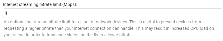

ellisd4 78 Posted April 17, 2023 Posted April 17, 2023 Is it possible to limit the TOTAL upload speed for all users when streaming remotely? For instance, I have a relatively low upload bandwidth from my ISP. I want to make sure ALL users stay under this limit, not just individual streams. Right now I only see the per-stream bitrate limit in Network Settings. I have it set at 4 Mbps in the case multiple users stream at a time, but would be nice to set at my actual upload speed to reduce transcoding when unnecessary.
ebr 16307 Posted April 17, 2023 Posted April 17, 2023 Hi. You can use that existing setting along with the setting to limit the number of concurrent streams to kind of create the same effect. The problem with trying to make a "total" max bitrate is what happens when that is reached and, how is the bandwidth doled out before it is reached?

ebr 16307 Posted April 17, 2023 Posted April 17, 2023 Just now, pwhodges said: the sharing won't be fair. But it would be if you set, say the per-stream limit to 5 and max streams to 4. That would ensure good streaming for 4 devices assuming a cap of 20mb/s. If, instead, you just set a global cap of 20 now you could have support for only one device - the first one who may grab all 20mb available.

ebr 16307 Posted April 17, 2023 Posted April 17, 2023 I would think with limited bandwidth you'd want to be sure and support more than one device but everyone's situation is different, I guess. Keep in mind that, if you had a particular user who you wanted to have higher bandwidth, you could have that. I actually have this same situation with only 20 up but two kids and a couple friends and myself who may be remote. So I give myself a larger bandwidth cap than the others to be sure I get good bandwidth when away but be sure that the others still can stream if they want to.
ellisd4 78 Posted April 17, 2023 Author Posted April 17, 2023 (edited) 1 hour ago, ebr said: I would think with limited bandwidth you'd want to be sure and support more than one device but everyone's situation is different, I guess. Keep in mind that, if you had a particular user who you wanted to have higher bandwidth, you could have that. I actually have this same situation with only 20 up but two kids and a couple friends and myself who may be remote. So I give myself a larger bandwidth cap than the others to be sure I get good bandwidth when away but be sure that the others still can stream if they want to. I'm dealing with only 8mbps up So I want to provide all 8... My in-laws use my server daily, but my parents will find the app and binge a series in a night and not watch anything for 2 months... so hard to do the limiting that way. Most of the TV Shows in my library are 6-8 mpbs bitrate, so I'd prefer not to throttle if I can. I do have my kids limited at 1mbps... because they really can't tell the difference. Edited April 17, 2023 by ellisd4
