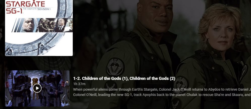

snozinho 1 Posted April 15, 2023 Posted April 15, 2023 1 hour ago, scb99 said: @Emby Support is there really no better solution than this??? I think Emby supports multi-episodes ; for instance the pilot episode of Stargate SG-1 is a two-part episode, and I renamed the file "Stargate SG-1 (1997)_S01E01E02.mkv" On emby its displayed like this : 1

GrimReaper 4848 Posted April 15, 2023 Posted April 15, 2023 24 minutes ago, snozinho said: I think Emby supports multi-episodes ; for instance the pilot episode of Stargate SG-1 is a two-part episode, and I renamed the file "Stargate SG-1 (1997)_S01E01E02.mkv" On emby its displayed like this : OP is not about multi-episode files but multi-part episodes - split video files/file stacking. That is currently not supported at episode level, the only options at present time are mentioned above.
