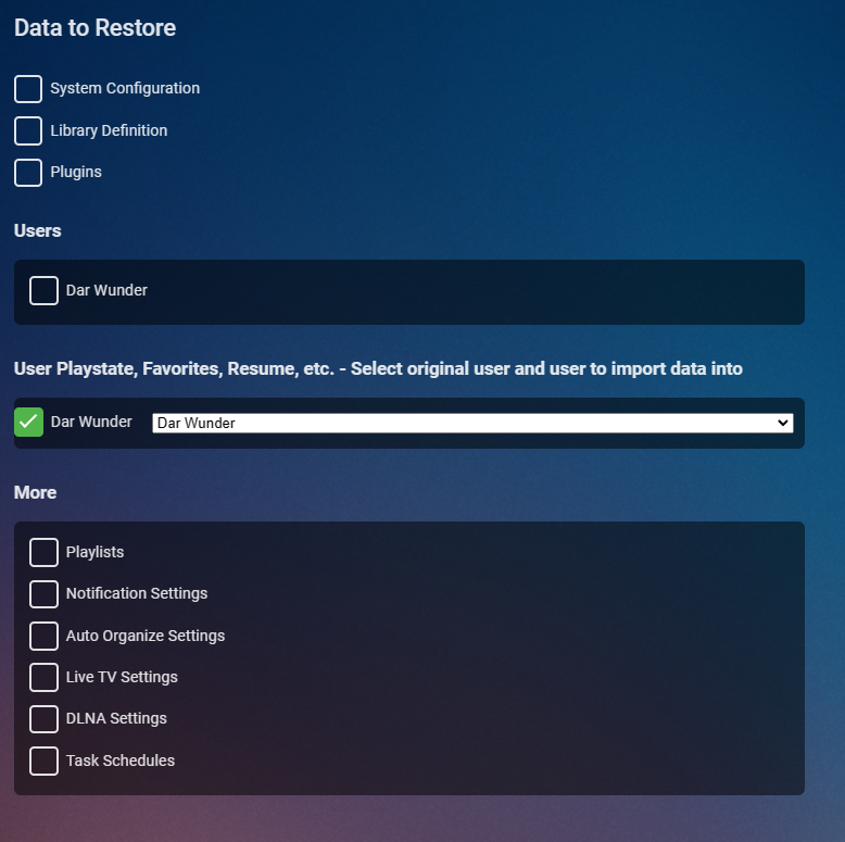

DarWun 357 Posted April 14, 2023 Posted April 14, 2023 2 hours ago, Luke said: Hi, @DarWun may have some tips. I'll try. This is probably not exactly what you are looking for @rsvg. It is not going to help you with how to share the actual content between two servers in remote locations. Unfortunately I have no experience with that. I do have two Emby servers (primary is a Synology NAS, secondary is my Windows PC) that I regularly sync playback status between, which is why I think @Luketagged me. But the storage location of all my media/data is the same for both. So if I delete content or add content on one Emby server, the changes are automatically picked up on the other when I do a library scan. The only thing that doesn't get synced is the play back status. Even though I suspect this is not going to fully answer your question, it might give you one piece of the puzzle. I use Emby on my NAS server to play all content, and once a week I sync the playstates between the NAS and PC servers using the "Backup & Restore" plugin. I'm able to use the plug-in to create a backup on my Synology NAS. I then copy the backup file to my Windows Server. From Emby on the Windows Server, I run the plugin to restore just the playstates. If the User Name is the same on both servers, playstates are updated to reflect those in the backup. In your case you would have to find a way to shuttle the backup files back and forth between locations. But that should be fairly easy to do. Hopefully someone will chime in with some suggestions on how to sync the actual data between two remote locations.
