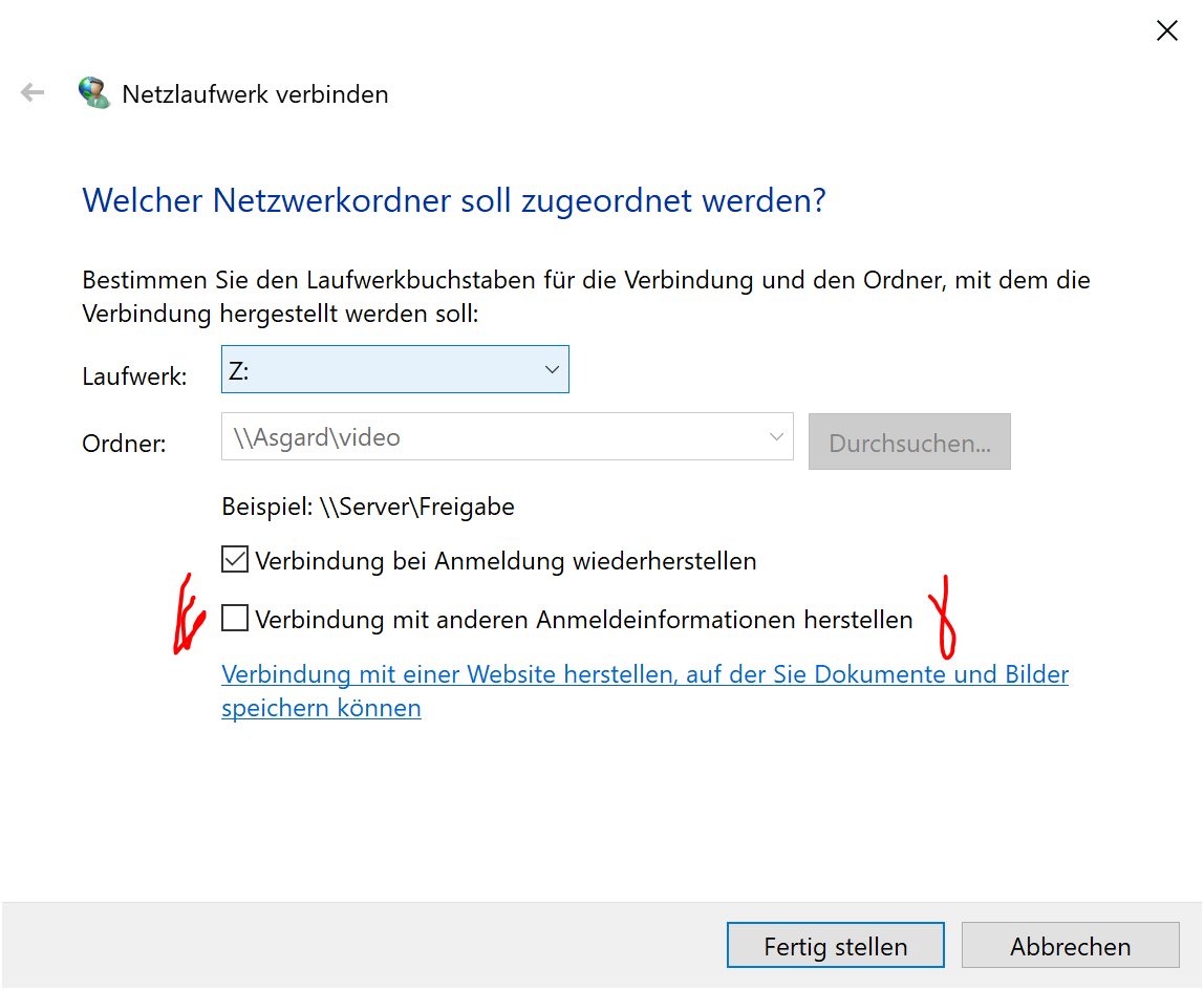

The login credentials arent needed by emby, the mapping is done by OS.
Second picture shows where to put in the synology credentials for the mapping.
That's the gui based method, can be done via cmd or ps too.
