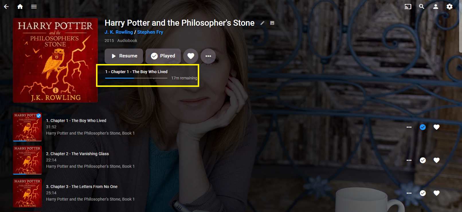

stephen_hill 46 Posted April 13, 2023 Posted April 13, 2023 Hi I have this problem that quite often Emby will try to resume an audio book from a previous chapter, even if that chapter has been marked as played, and there is progress in the next chapter. Here is an audio book I am listening to and Emby thinks that this is where I want to continue from. However, I have listened to this chapter in full and thus, Emby marked it as Played. However, if we look at the list of chapters, you will see that I am actually part way through chapter 17. Are you aware of this issue and is there anything that can be done to fix it? For info, I'll add that I listen to my audiobooks in the car using the Android app. I stream the audio over 4G internet. And the audio is via bluetooth to my car. Cheers Stephen

Happy2Play 9800 Posted April 13, 2023 Posted April 13, 2023 (edited) There will always be issues when there are multiple resume points. Resume will be linked to the first item. You have to fix the issue by clearing the resume point so there is only one by toggling played or start from the beginning and stop playback one the already played item. Then the next resumable item will be used. Edited April 13, 2023 by Happy2Play
stephen_hill 46 Posted April 13, 2023 Author Posted April 13, 2023 1 hour ago, Happy2Play said: There will always be issues when there are multiple resume points. Resume will be linked to the first item. You have to fix the issue by clearing the resume point so there is only one by toggling played or start from the beginning and stop playback one the already played item. Then the next resumable item will be used. Do you know why multiple resume points are being created in the first place? More often than not, for example, if I resume chapter 5 from 50% and listen through to chapter 6 until 75%, the result will be that - Chapter 5 remains at 50% - Chapter 5 is marked as played - Chapter 6 is at 75% Shouldn't Emby clear the progress of Chapter 5 when it is marking it as played? I often jump in the car, click resume, start driving and then realise I've already listened to it. I either have to stop or put up with it. I'm happy to convert all my audio books to single files, but was wondering if the underlying bug could be fixed?
Happy2Play 9800 Posted April 13, 2023 Posted April 13, 2023 5 minutes ago, stephen_hill said: Shouldn't Emby clear the progress of Chapter 5 when it is marking it as played? It does unless it is replayed at least in all my tests/plays. But could be a client specific issue.
