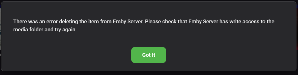

vaise 340 Posted April 12, 2023 Posted April 12, 2023 This is Just one for the back burner. This error has been there forever. If you are watching an in progress recording, (chase play) and the show has ended but it is still recording the post padding, then you press delete on it (as it is ended), then it throws the error : VolleyError.com.android.volley.ServerError. it has always done this. I guess it’s a file in use. Maybe cam capture it and send a message to say ‘still being recorded, delete when finished’, or maybe stop the recording, then delete it?
ebr 16337 Posted April 12, 2023 Posted April 12, 2023 What happens if you try the same thing in the web app?
vaise 340 Posted April 14, 2023 Author Posted April 14, 2023 web throws this if the file is currently being recorded :
vaise 340 Posted April 14, 2023 Author Posted April 14, 2023 Maybe change that error to say 'or the media may be in use if a live Tv recording, try again later' - then have that happen for all platforms.
vaise 340 Posted April 14, 2023 Author Posted April 14, 2023 Should be easy for you to simulate this on each platform. Record a live TV show, while recording, go to recorded TV, then try to delete it.
