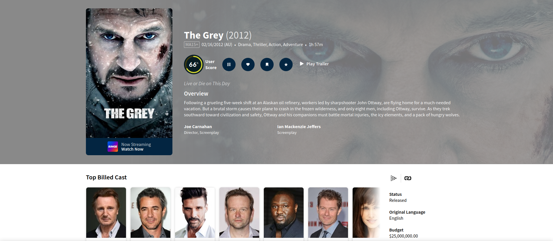

Junglejim 385 Posted April 5, 2023 Posted April 5, 2023 9 hours ago, GrimReaper said: There's no movie American Pie 1 (1999). Remove that "1", rescan. What are those ****? Do they stand for Year or? Maybe he means this, https://www.themoviedb.org/movie/75174-the-grey. But just a guess. Not sure why he put **** instead of the actual year, strange...

Junglejim 385 Posted April 6, 2023 Posted April 6, 2023 (edited) Is it this movie? If it is try (2012)... That could fix it maybe Edited April 6, 2023 by Junglejim

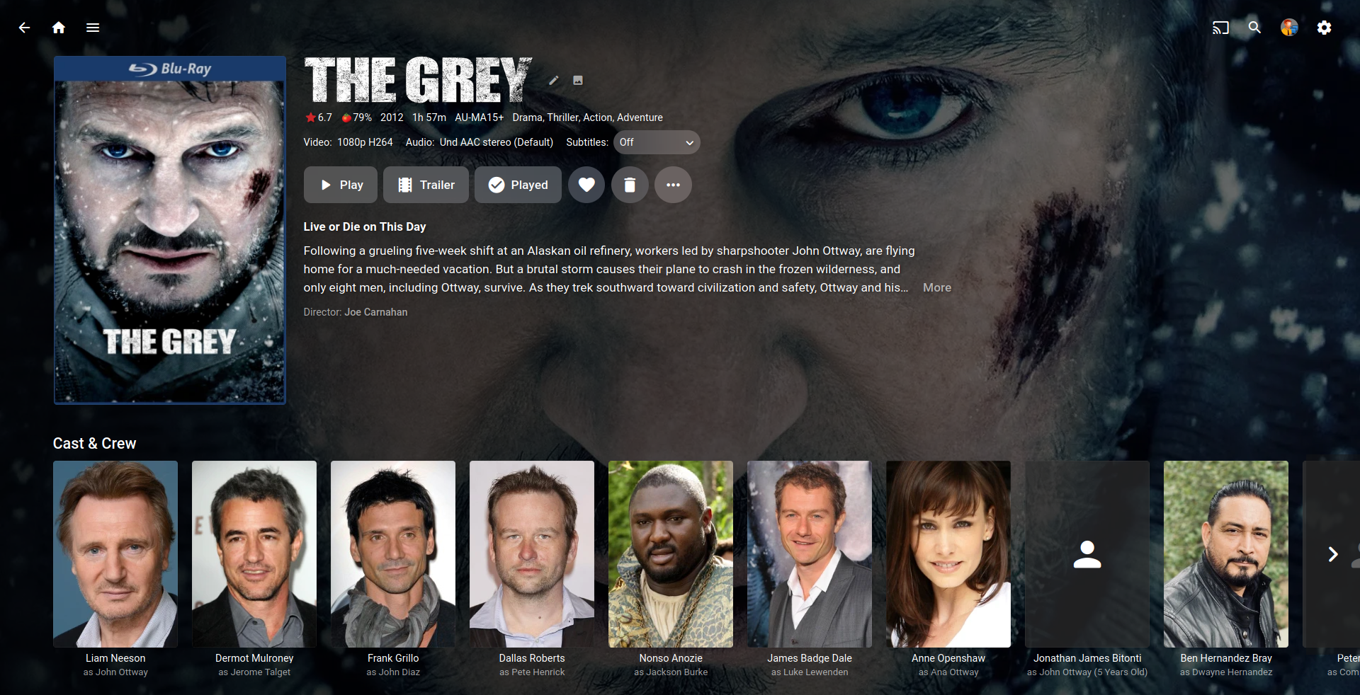

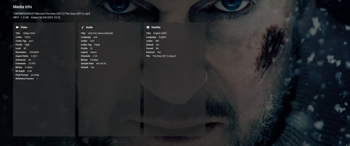

Junglejim 385 Posted April 6, 2023 Posted April 6, 2023 (edited) That's weird, I just DL the movie "The Grey (2011)" (mybad ) to test and it scraped fine with the same naming as you "The Grey (2011)/The Grey (2011).mp4" Notice the year is scraped 2012 from TMDB even though I named the movie 2011.. How are your Movie Metadata Downloaders ordered? Edited April 6, 2023 by Junglejim
