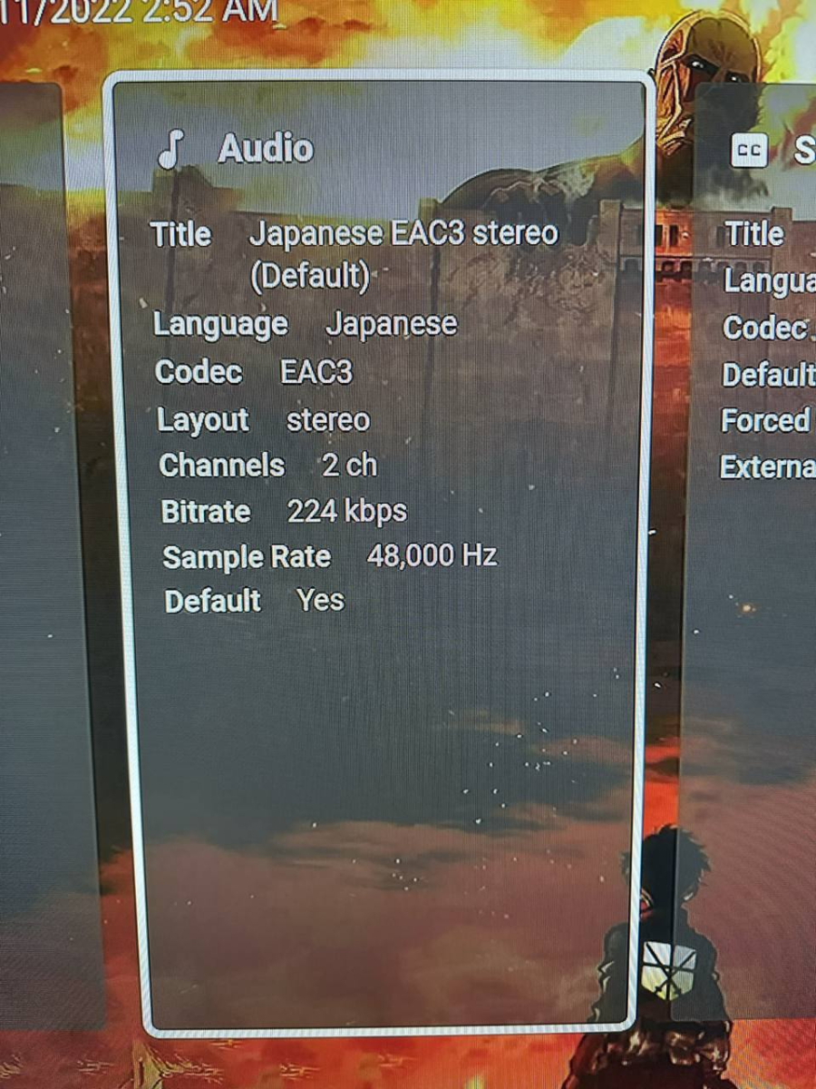

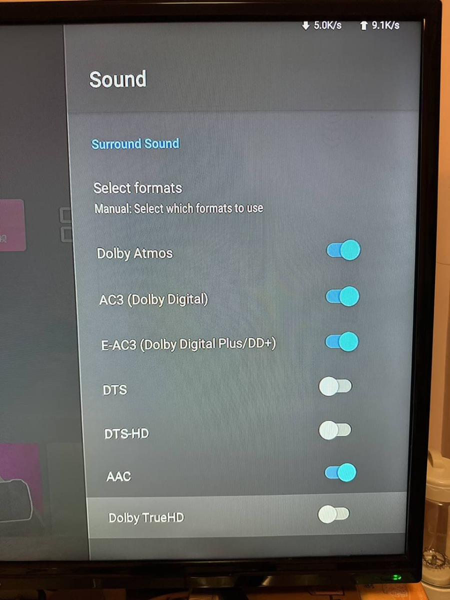

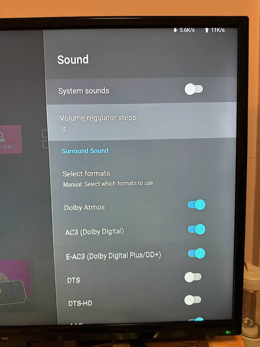

DreamSeason 5 Posted April 4, 2023 Author Posted April 4, 2023 (edited) 50 minutes ago, GrimReaper said: Not knowing neither your TV model nor your Android box model, but since your box should be "aware" of your TV capabilities, I would assume that it would either decode audio locally or Emby would remux audio server-side and DirectStream to your device. Also, have you checked your Android box audio system settings (not Emby client app settings) what options do you have? I'm back with all the information I could provide with. First of all, I want to point out that the server is set to NOT transcode any media. So it would only be my android box who decode the media file. Secondly, the tv is a no namer brand tv. Let's simply ignore it and treat it as computer display which doesn't have SOC nor wifi, etc. It can only output video and audio signal throught the HDMI cable. Here's my android box audio setting: picture 1-2 are my android tv box audio settings. I've tried both manual and auto. Neither is working for ETA, but both work for Emby for ATV. Pic 3 is my AIDA64 codec. Pic 4 is the media file which I've problems with. As is clearly shown, it's encoded with EAC3 codec. And AIDA64 shows support for it. But using ETA my TV is outputing nothing at all. Only Emby for Android TV works. Edited April 4, 2023 by DreamSeason

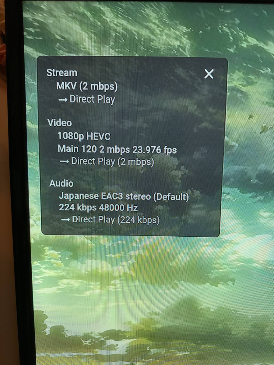

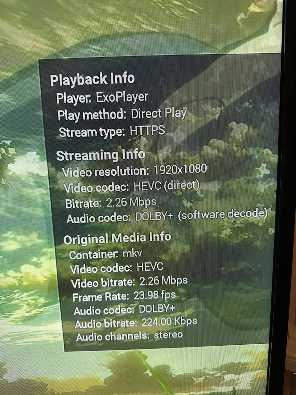

DreamSeason 5 Posted April 4, 2023 Author Posted April 4, 2023 (edited) 1 hour ago, GrimReaper said: Not knowing neither your TV model nor your Android box model, but since your box should be "aware" of your TV capabilities, I would assume that it would either decode audio locally or Emby would remux audio server-side and DirectStream to your device. Also, have you checked your Android box audio system settings (not Emby client app settings) what options do you have? Both are playing the same episode. P1 is from ETA, no audio. P2 is from Emby for ATV, working audio. It does show it's using software docoding. Maybe it's because I've enabled that downmix option. Edited April 4, 2023 by DreamSeason
GrimReaper 4898 Posted April 4, 2023 Posted April 4, 2023 24 minutes ago, DreamSeason said: First of all, I want to point out that the server is set to NOT transcode any media. That is not recommended, as it will likely lead to other issues down the line. But even if you're keen on keeping it that way, you should restrict it to disabled video transcoding only and enable audio transcoding, as that is inexpensive CPU task, you'll hardly notice CPU usage increase on audio remux. What are your transcoding settings under Settings>Users>edit desired user? 26 minutes ago, DreamSeason said: picture 1-2 are my android tv box audio settings. I'd disable all formats there save AAC and AC3, play again via standard Android app and see how does that compare?
DreamSeason 5 Posted April 4, 2023 Author Posted April 4, 2023 1 hour ago, GrimReaper said: That is not recommended, as it will likely lead to other issues down the line. But even if you're keen on keeping it that way, you should restrict it to disabled video transcoding only and enable audio transcoding, as that is inexpensive CPU task, you'll hardly notice CPU usage increase on audio remux. What are your transcoding settings under Settings>Users>edit desired user? I'd disable all formats there save AAC and AC3, play again via standard Android app and see how does that compare? Tried. Same results. I even turned off all of the codec in sound settings. Emby for ATV is still fine while ETA not working. That's the reason why lots of people stick to the Emby for ATV. ETA breaks things for us Emby ATV users.

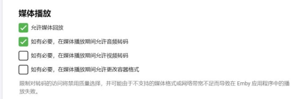

GrimReaper 4898 Posted April 4, 2023 Posted April 4, 2023 1 hour ago, GrimReaper said: What are your transcoding settings under Settings>Users>edit desired user?
DreamSeason 5 Posted April 7, 2023 Author Posted April 7, 2023 On 4/6/2023 at 8:46 PM, Luke said: @DreamSeason? On 4/4/2023 at 10:42 PM, GrimReaper said: Sorry for the delay. Here's the setting for my account in the server. Only audio transcoding is enabled.
