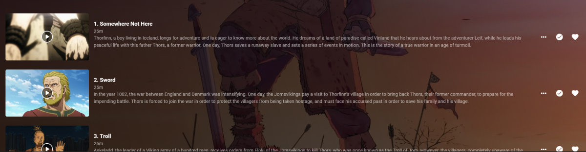

ST4R3 3 Posted April 4, 2023 Posted April 4, 2023 I'm trying to import Vinland Saga, Emby recognizes season 1 entirely correct and normally. But then for season 2 all the episodes show up with season 1 metadata. Normally id just attribute this to some folder structure or naming error, or just emby being weird and me needing to add all the TVDB IDs myself. But no, it did find all the correct TVDB IDs by itself and continues to do so if i rerun everything or delete the metadata. This also means that i can't fix the issue by just adding the TVDB IDs myself (I've tried deleting all the metadata except that, it doesn't work), I would need to enter all of the metadata myself. It is also not an issue of TVDB not having the metadata btw. That is all there. The folder structure is this as recommended: \TV \Vinland Saga (2019) \Season 1 Vinland Saga S01E01.mkv Vinland Saga S01E02.mkv \Season 2 Vinland Saga S02E01.mkv Vinland Saga S02E02.mkv The Image is taken from the season 2 folder in Emby. The TVDB IDs for the 3 episodes (IN EMBY, FETCHED BY EMBY) are as follows: 9040137; 9524421; 9524422 And this is correct but the metadata does not match this, as you can see.

Happy2Play 9800 Posted April 4, 2023 Posted April 4, 2023 But does not explain why a season 2 media is identified as season 1. Also need to see the server log for when this was imported. Only other suggestion would be removing the show, doing a full scan, ensuring there is no metadata with media and readding the show.
Solution ST4R3 3 Posted April 4, 2023 Author Solution Posted April 4, 2023 I actually found the problem now, when i was looking for which log file to send and doing further troubleshooting. AniDB was set to higher priority for *Episode Metadata* than TVDB. And AniDB has Season 2 as a seperate entry. So when looking for only the episode metadata Emby couldn't fetch the right metadata but found the right TVDB IDs and so on. After adjusting this it has found the right metadata. 1 2
