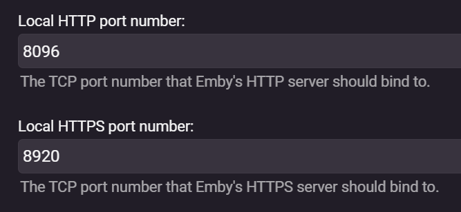

seanbuff 1356 Posted April 1, 2023 Posted April 1, 2023 5 minutes ago, SirJMD said: Looking at "emby.subdomain.conf" in nginx it says "in emby settings, under "Advanced" change the public https port to 443, leave the local ports as is". But above recommendation were to leave it at 8920. Howcome? In that conf I've changed: server_name emby.*; The text in the file is correct. I would leave the "Internal" ports as default, i.e: But you should change the "Public" ports to: Then in the emby.subdomain.conf file: Quote location / { include /config/nginx/proxy.conf; include /config/nginx/resolver.conf; set $upstream_app <Emby Local IP>; set $upstream_port 8096; set $upstream_proto http; proxy_pass $upstream_proto://$upstream_app:$upstream_port; Update it to the IP of Emby, or your container name if using Docker. Then in your router, you need to Port Forward both 80 and 443 to your Reverse Proxy IP and internal ports you chose
SirJMD 17 Posted April 1, 2023 Author Posted April 1, 2023 @seanbuffChanged the ports as suggested, and set set $upstream_app 192.168.20.3. In my router I've forwarded both port 80 and 443 to the nginx server's IP (192.168.20.7) - that's what you meant, right? Still getting "This site can’t be reached". I've of course restarted the docker containers after making the changes Tested http://emby.duckdns.org:8096/ and it works fine (closed that port afterwards again).
