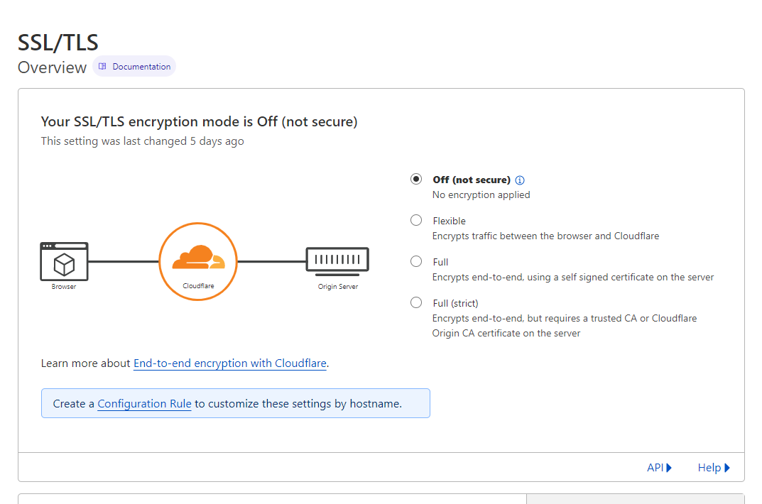

gnollo 17 Posted April 5, 2023 Author Posted April 5, 2023 18 hours ago, KegTapper said: I used the guide you posted to set up CF, pretty easily if I recall. But that was a few years ago. I then moved onto caddy2. And migrated once again to a CF tunnel a few months ago The guide has no pictures anymore, and CF changed a bit This is what I see as options. Are you using full or full (strict)?

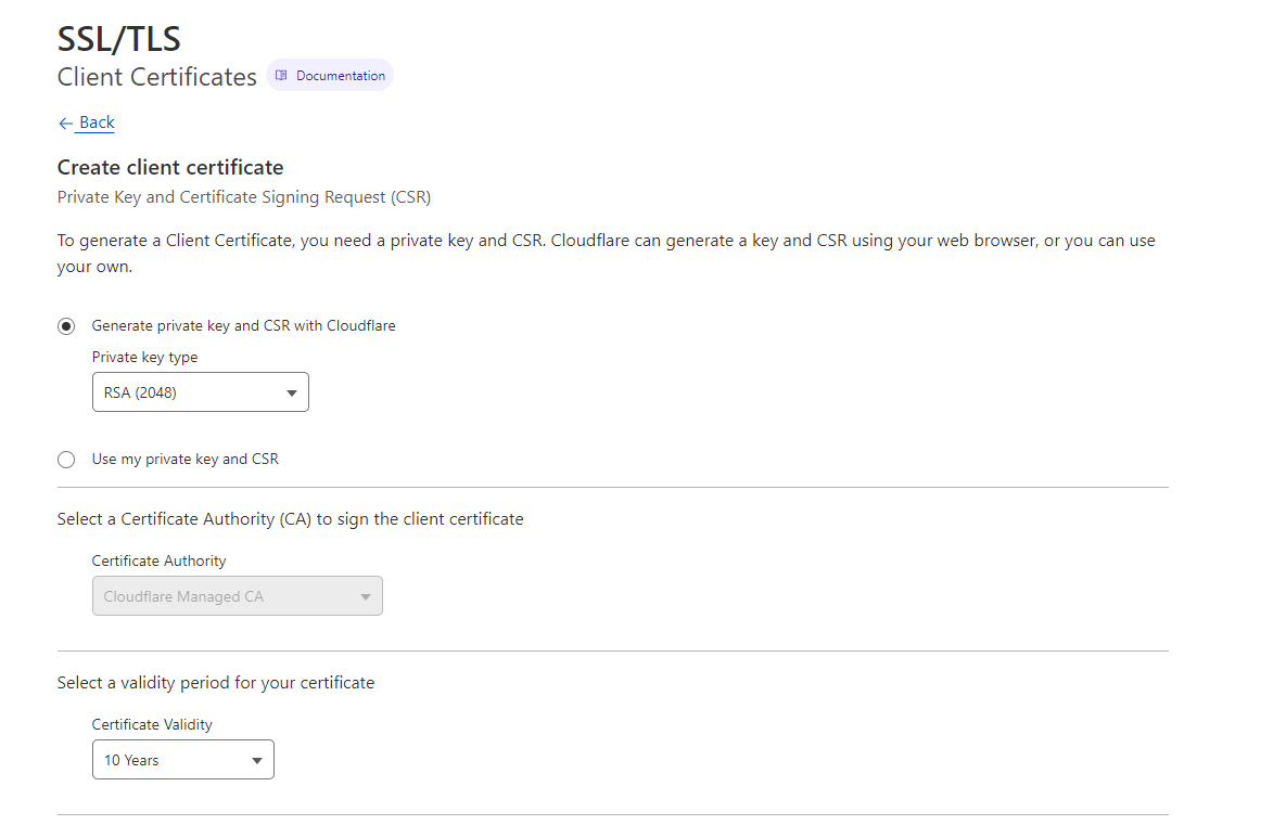

gnollo 17 Posted April 5, 2023 Author Posted April 5, 2023 also the guide says "Click Create Certificate, on the next screen leave everything default and click next." I went to the create client certificate option under SSL/TSL and left everything as it is, see below
gnollo 17 Posted April 5, 2023 Author Posted April 5, 2023 Operating system: Linux version 5.19.14-Unraid (root@Develop) (gcc (GCC) 12.2.0, GNU ld version 2.39-slack151) #1 SMP PREEMPT_DYNAMIC Thu Oct 6 09:15:00 PDT 2022 Framework: .NET 6.0.8 OS/Process: x64/x64 Runtime: system/System.Private.CoreLib.dll Processor count: 4 Data path: /config Application path: /system System.InvalidOperationException: System.InvalidOperationException: Certificate [sequenceofnumbersremove] cannot be used as an SSL server certificate. It has an Extended Key Usage extension but the usages do not include Server Authentication (OID 1.3.6.1.5.5.7.3.1). at Microsoft.AspNetCore.Server.Kestrel.Https.Internal.HttpsConnectionMiddleware.EnsureCertificateIsAllowedForServerAuth(X509Certificate2 certificate) at Microsoft.AspNetCore.Server.Kestrel.Https.Internal.HttpsConnectionMiddleware..ctor(ConnectionDelegate next, HttpsConnectionAdapterOptions options, ILoggerFactory loggerFactory) at Microsoft.AspNetCore.Hosting.ListenOptionsHttpsExtensions.<>c__DisplayClass12_0.<UseHttps>b__0(ConnectionDelegate next) at Microsoft.AspNetCore.Server.Kestrel.Core.ListenOptions.Build() at Microsoft.AspNetCore.Server.Kestrel.Core.KestrelServerImpl.<>c__DisplayClass30_0`1.<<StartAsync>g__OnBind|0>d.MoveNext() --- End of stack trace from previous location --- at Microsoft.AspNetCore.Server.Kestrel.Core.Internal.AddressBinder.BindEndpointAsync(ListenOptions endpoint, AddressBindContext context, CancellationToken cancellationToken) at Microsoft.AspNetCore.Server.Kestrel.Core.ListenOptions.BindAsync(AddressBindContext context, CancellationToken cancellationToken) at Microsoft.AspNetCore.Server.Kestrel.Core.AnyIPListenOptions.BindAsync(AddressBindContext context, CancellationToken cancellationToken) at Microsoft.AspNetCore.Server.Kestrel.Core.Internal.AddressBinder.EndpointsStrategy.BindAsync(AddressBindContext context, CancellationToken cancellationToken) at Microsoft.AspNetCore.Server.Kestrel.Core.Internal.AddressBinder.BindAsync(IEnumerable`1 listenOptions, AddressBindContext context, CancellationToken cancellationToken) at Microsoft.AspNetCore.Server.Kestrel.Core.KestrelServerImpl.BindAsync(CancellationToken cancellationToken) at Microsoft.AspNetCore.Server.Kestrel.Core.KestrelServerImpl.StartAsync[TContext](IHttpApplication`1 application, CancellationToken cancellationToken) at Microsoft.AspNetCore.Hosting.WebHost.StartAsync(CancellationToken cancellationToken) at Microsoft.AspNetCore.Hosting.WebHost.Start() at Emby.Server.Implementations.HttpServer.KestrelHost.KestrelListener.OnAddPrefixesComplete() at Emby.Server.Implementations.ApplicationHost.Init() at EmbyServer.HostedService.StartAsync(CancellationToken cancellationToken) Source: Microsoft.AspNetCore.Server.Kestrel.Core TargetSite: Void EnsureCertificateIsAllowedForServerAuth(System.Security.Cryptography.X509Certificates.X509Certificate2) Info Main: Shutdown complete [cont-finish.d] executing container finish scripts... [cont-finish.d] done. [s6-finish] waiting for services. [s6-finish] sending all processes the TERM signal. [s6-finish] sending all processes the KILL signal and exiting. ** Press ANY KEY to close this window **
gnollo 17 Posted April 5, 2023 Author Posted April 5, 2023 again Emby crashes if I use the certificate. If I remove it, emby will start again. I am stuck.
pwhodges 2023 Posted April 5, 2023 Posted April 5, 2023 58 minutes ago, gnollo said: System.InvalidOperationException: System.InvalidOperationException: Certificate [sequenceofnumbersremove] cannot be used as an SSL server certificate. It has an Extended Key Usage extension but the usages do not include Server Authentication As the error message says, you are using a client certificate, not a server certificate which is what you need. https://cheapsslsecurity.com/blog/client-certificate-vs-server-certificate-simplifying-the-difference/ Paul

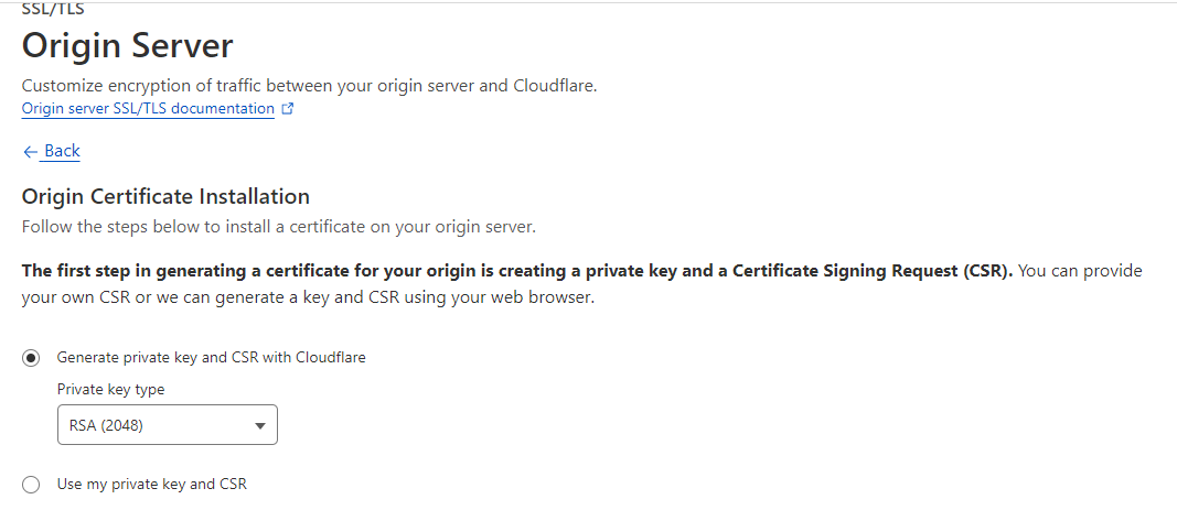

gnollo 17 Posted April 6, 2023 Author Posted April 6, 2023 15 hours ago, pwhodges said: As the error message says, you are using a client certificate, not a server certificate which is what you need. https://cheapsslsecurity.com/blog/client-certificate-vs-server-certificate-simplifying-the-difference/ Paul Thank you, I'm guessing origin server is the option to use on CF

gnollo 17 Posted April 9, 2023 Author Posted April 9, 2023 (edited) I a going to try to create another certificate this is the default optio Edited April 9, 2023 by gnollo
