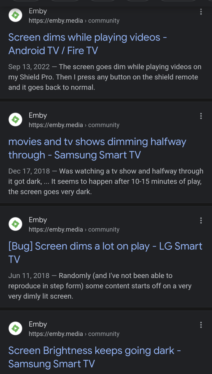

sbodley8 1 Posted April 24, 2023 Author Posted April 24, 2023 Thanks for the response. No, it only happens during playback at random it will suddenly go dark, it's not from pausing. There are others that have reported this issue, I've attached a screenshot of some reports. Thanks for the info I'll send a log, hopefully it will help identify what's going on.
ebr 16337 Posted April 24, 2023 Posted April 24, 2023 7 hours ago, sbodley8 said: it's not from pausing Hi. I understand it isn't directly from being paused. What I'm asking is have you ever paused the video during the playback session where this does occur?

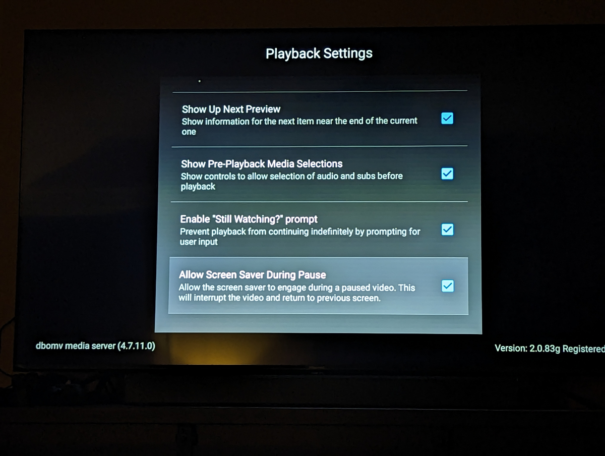

ebr 16337 Posted May 7, 2023 Posted May 7, 2023 Hi. Unfortunately, the server log won't yield any clues. Do you have the option to allow the screensaver during pause enabled? If not, try enabling it and see if this issue goes away.
sbodley8 1 Posted May 8, 2023 Author Posted May 8, 2023 19 hours ago, ebr said: Hi. Unfortunately, the server log won't yield any clues. Do you have the option to allow the screensaver during pause enabled? If not, try enabling it and see if this issue goes away. Dang. Turns out it was already enabled. I suppose I'll try disabling it instead and see if that helps? 1
sbodley8 1 Posted May 10, 2023 Author Posted May 10, 2023 Tried disabling it but the problem persists. 20 minutes into a movie the screen randomly dimmed again. Anyone have any more ideas why this could be happening? This doesn't happen with any other streaming apps.
