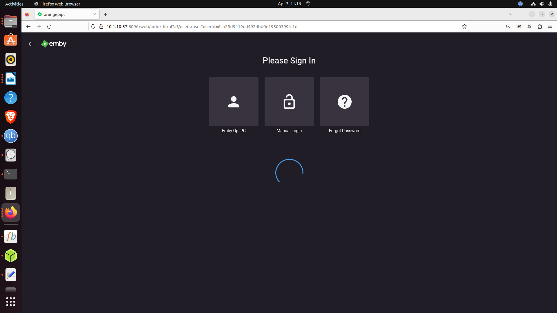

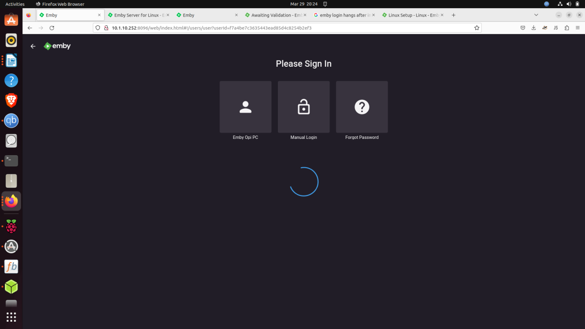

DevoteeOfEmby 4 Posted March 30, 2023 Posted March 30, 2023 Hi Everyone. I am a long time devotee of Emby and have run the server on Armbian for probably close to a decade. It is always easy. Download the .deb. sudo dpkg -i, then open up the permissions on the library drives and it just goes. So last week I tried an Orange PI PC just to see if the thing could handle munching about 500 different TV shows. And it worked great. Took about a day to index, but they worked fine. I am attempting to make a guide, so I went to test my methodology on a few other boards (a NanaPi M4, Odroid C2, an RPI 2 with Raspbian), and got the same behavior, all with that same drive, same workflow, everything the same. But now when I click on the server after setup, it hangs and spins. Happens on the IP address on localhost, and Emby apps on the TV don't even see the server. Tried sudo service emby-server restart in case it was crashing. Same behavior. Logs don't seem to have any errors, and it does appear that it munched some files as they are quite large and repeated ffmpeg calls. I'm flustered. Any help would be help. It usually does not go this way.
DevoteeOfEmby 4 Posted March 30, 2023 Author Posted March 30, 2023 Update: Just tried it with DietPi installed via the interface, not from the website, and same exact behavior, with a completely different drive, on the Odroid C2.

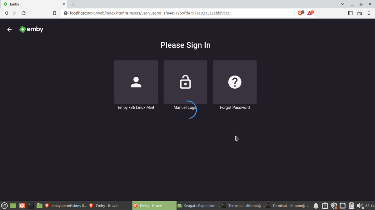

DevoteeOfEmby 4 Posted April 3, 2023 Author Posted April 3, 2023 I have now confirmed that this is a problem on x86/amd64 platforms as well. This is Linux Mint on a Dell Laptop. So whatever this bug is that was introduced, it is affecting all Linux new installs. old installs are unaffected.
DevoteeOfEmby 4 Posted April 3, 2023 Author Posted April 3, 2023 And the same computer, using a Windows partition, ran the portable just fine and is now munching the same drive. I was able to click on the initial user and the server behaved as normal. One note though. The setup.exe didn't work.

DevoteeOfEmby 4 Posted April 9, 2023 Author Posted April 9, 2023 I did find a new tip. When it sits and spins, click the manual login, and that seems to work.
