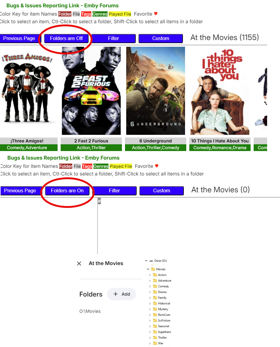

hemsimmons 0 Posted December 17, 2024 Posted December 17, 2024 I am having the same / similar issue as "the-dumb1". When I turn Folders On -- all of my content goes away -- totally blank screen. With Folders Off, I see everything --- but 1,155 movies in one list it is difficult to navigate. Could this be because it is only using the Library folders and not the actual folders on the server? The library has only 1 primary folder but 10-12 underneath on the server.
the-dumb1 136 Posted December 23, 2024 Posted December 23, 2024 On 12/17/2024 at 2:08 PM, hemsimmons said: I am having the same / similar issue as "the-dumb1". When I turn Folders On -- all of my content goes away -- totally blank screen. With Folders Off, I see everything --- but 1,155 movies in one list it is difficult to navigate. Could this be because it is only using the Library folders and not the actual folders on the server? The library has only 1 primary folder but 10-12 underneath on the server. Glad to know it's not PEBKAC or an ID-10-T error. I created a very simple small scale new library with a much more simplified folder structure and the problem persisted. If there are logs generated somewhere, we can help put a spotlight on where the issue is. A re-write like Vic wants to do may make the error OBE ... or just kick the can down the road. Here's to hoping for a quick resolution.

kbeck 64 Posted August 2, 2025 Posted August 2, 2025 On 12/17/2024 at 5:08 PM, hemsimmons said: I am having the same / similar issue as "the-dumb1". When I turn Folders On -- all of my content goes away -- totally blank screen. With Folders Off, I see everything --- but 1,155 movies in one list it is difficult to navigate. Could this be because it is only using the Library folders and not the actual folders on the server? The library has only 1 primary folder but 10-12 underneath on the server. Having the same exact problem. Thing is one Library with same folder structure sees the folder fine and one Library doesn't.
kbeck 64 Posted August 4, 2025 Posted August 4, 2025 If anyone has the problem with Folders on and only seeing a hash symbol instead of files (#), I found a workaround. My Library has 1 main folder, with about a dozen sub-folders and then the movie folders under them. I created an empty folder in the root of the Library folder, added it to the Library and everything shows. I:\Animated Shorts (Library points to here) I:\Animated Shorts\Looney Tunes I:\Animated Shorts\Looney Tunes\Folder1 I:\Animated Shorts\Looney Tunes\Folder2... I:\Animated Shorts\Disney I:\Animated Shorts\Disney\Folder1 I:\Animated Shorts\Disney\Folder2 I:\xTest (Empty folder. Added to Library) 1
