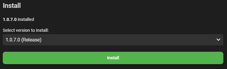

worthmo 12 Posted September 7, 2023 Posted September 7, 2023 I have the latest version of Bulky already installed (1.0.7.0). I tried uninstalling and re-installing but continue to receive the same error message.
gillmacca01 220 Posted September 7, 2023 Posted September 7, 2023 3 hours ago, worthmo said: I have the latest version of Bulky already installed (1.0.7.0). I tried uninstalling and re-installing but continue to receive the same error message. Just to confirm, I have 1.0.7.0 and I am seeing exactly the same error message in the browser console

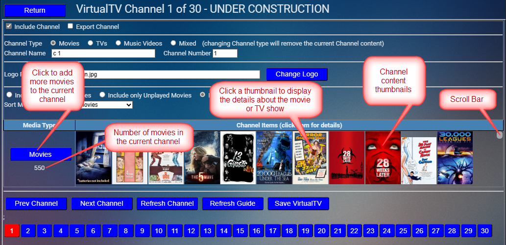

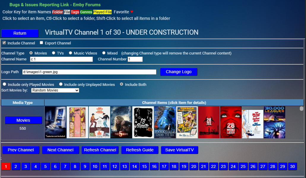

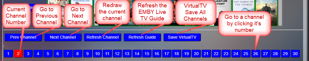

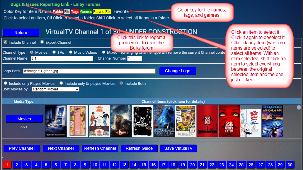

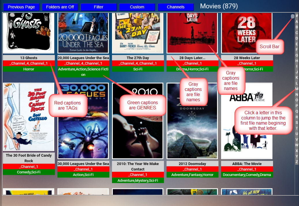

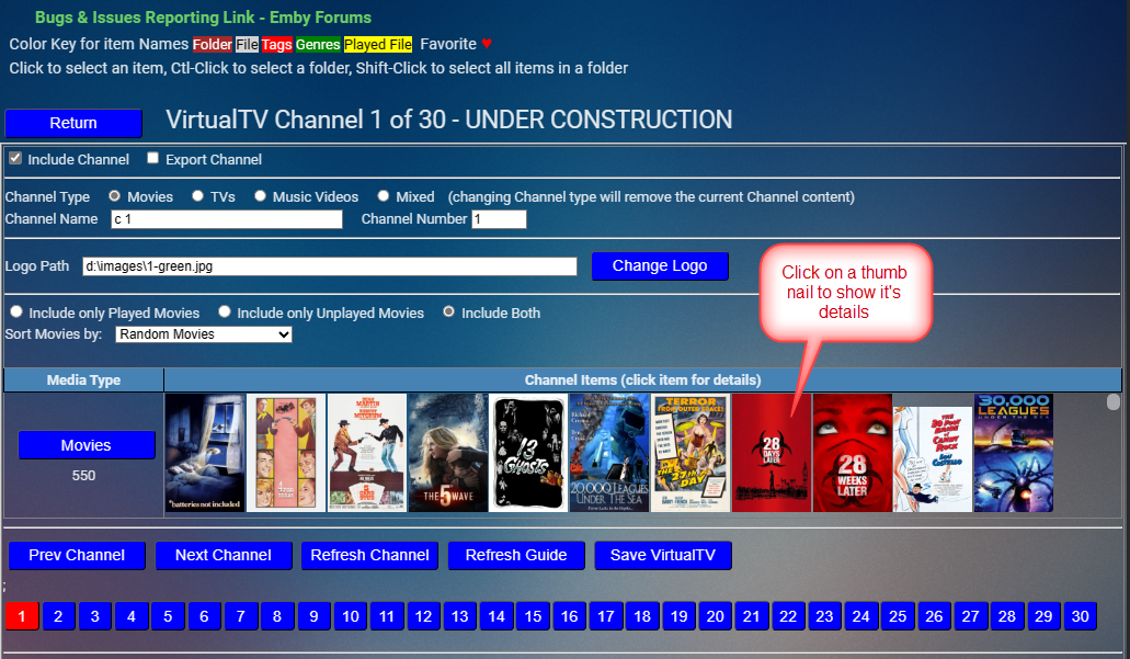

VicMoore 755 Posted September 7, 2023 Posted September 7, 2023 I have worked on the "Channels" tool in Bulky. It will read your VirtualTV channel setups. The first time you read this data the "Channels" will assume that you have no media selected for any of the 30 channels. With this tool you will select the media for each channel. Nothing is saved back into VirtualTV until you click the "Save VirtualTV" button. At the moment, processing of TV channels is slow. I will improve this soon. ..... ..... ..... ..... ..... ..... ..... ..... .... ..... ..... ..... 2
