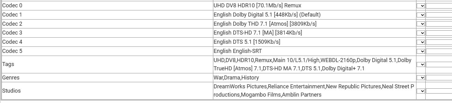

rbjtech 5345 Posted August 23, 2023 Posted August 23, 2023 13 hours ago, VicMoore said: @Grumpy1Did you try using the 'custom search' in Bulky? Go down to Codec 0 and search for '4K Dolby'. Let me know if this works. Vic This not going to currently work, because emby do not currently have the dolby vision data available to search. Infact you can't even search on HDR, yet alone DV. The data IS stored though (in the Beta version, they added DV, incl profile data - that's how it displays it DV) - but no HD Audio codecs data yet. So the reason you see the detail below in a Bulky search - is because it's reading the TRACK title - which was put there by the MediaInfo Plugin - OR you may be lucky and somebody added it during the construction of the MKV/MP4. ie - if you wanted to find all DV8 (DV profile 8 ) then you could use Codec 0 = DV8 - I agree (but again, only if the data has been put there in the first place) I'm sure Emby will eventually add these details, it's just 'on the list' like a lot of other things ... 1

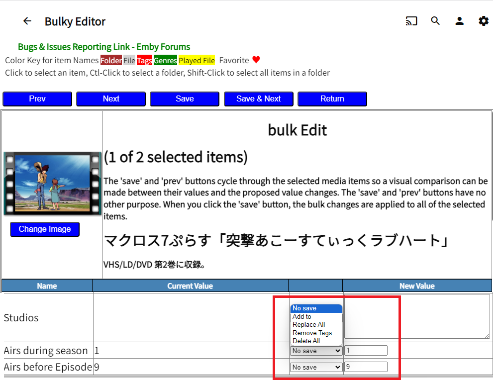

miraclesuki 1 Posted August 30, 2023 Posted August 30, 2023 On 8/29/2023 at 8:02 AM, VicMoore said: @miraclesukiAre you satisfied with the implemented solution to your request? Let me know if I can help you further. Vic Thanks for your follow up. I tried the new added feature, but it does not work in "Bulk Edit" mode. (edit in single episode is work) Here is my steps: 1. Click 2 episode, select "Bulk Edit" 2. Remove (empty) the value of "Air during season" and "Airs before episode" or tried to change the new value to 0 Refer to the screenshot, When I click "Save", it will return to the previous screen and after click to check the change, it still keep the value of 1 and 9 in the special episode. When I click "Save & Next", it will return to the previous screen and after click to check the change, it still keep the value of 1 and 9 in the special episode. (same as above) Also, I tried those values in the marked red square (Add to, Replace all, Remove Tags, Delete all), all are not working. In addition, I would like to know the steps that, how I can bulky change the selected special episodes field(s) value to a new value? For example, I would like to change all selected special episodes field "Airs before episode" value to empty. Can I do this? Thanks for your kindly reply and follow up. Cheers!

VicMoore 755 Posted August 30, 2023 Posted August 30, 2023 hello @miraclesuki... The storm is gone, the rain has stopped. No damage here at all and the power stayed on. I just uploaded the updated Plugin with the problem that you found fixed. Thanks so much for reporting this. I had a bug in the code. Give it a try now. It should work OK. If you have another problem, please let me know ASAP. Thanks again, Vic 1
miraclesuki 1 Posted August 30, 2023 Posted August 30, 2023 41 minutes ago, VicMoore said: hello @miraclesuki... The storm is gone, the rain has stopped. No damage here at all and the power stayed on. I just uploaded the updated Plugin with the problem that you found fixed. Thanks so much for reporting this. I had a bug in the code. Give it a try now. It should work OK. If you have another problem, please let me know ASAP. Thanks again, Vic Hello Vic, I tested the version of 1.0.6. The bulk edit feature is worked fine on "Air during season" and "Airs before episode" field. Once I changed both new value to 0 and click save, all selected episodes value will be updated. But, I don't know whether it is normal that these 2 fields cannot be edit again after I click "Edit" into the selected episode. (Bulk Edit as well) These 2 fields value will display as "undefined" and "Not Available" as you may refer to the below screenshot. (but I can edit it directly from emby metadata) Many thanks again for your hardworking!! Finally I can now bulky edit all special episodes which mixed with season episodes easily
VicMoore 755 Posted August 30, 2023 Posted August 30, 2023 hello @miraclesuki , these fields will have a new value of "Not Available" when the item is not a "Special" These fields only have meaning for "Specials" Vic 1
