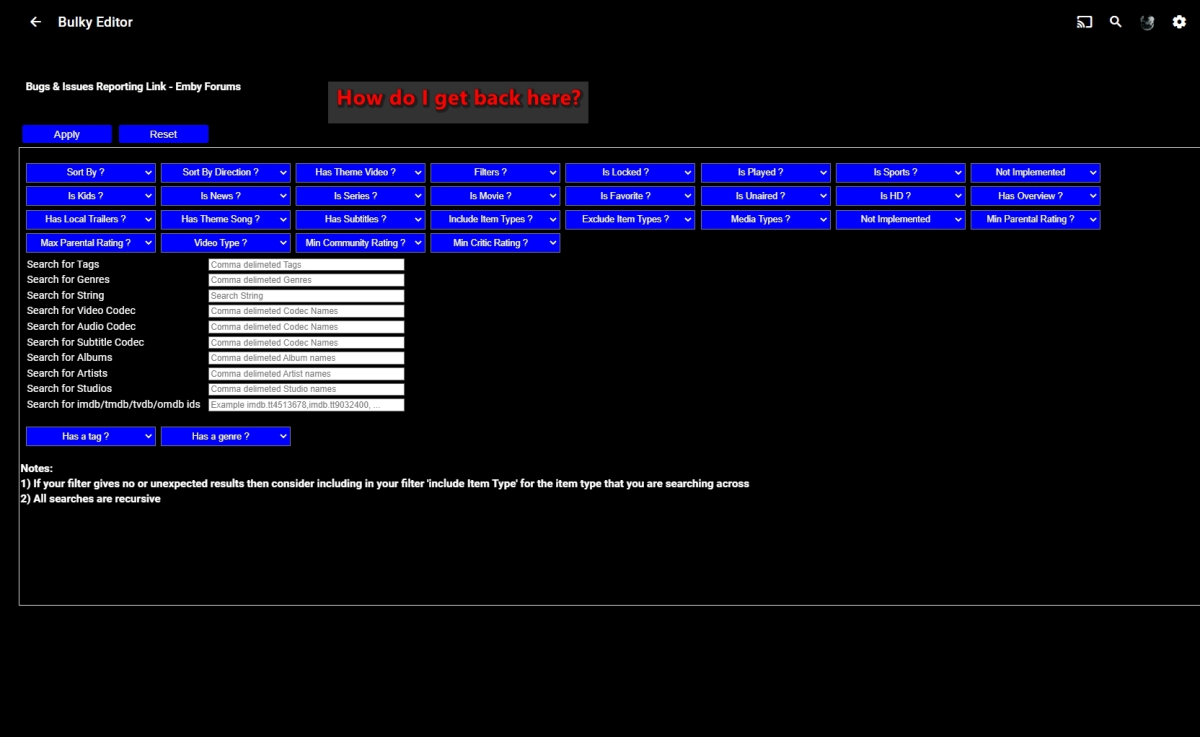

mixXxim 2 Posted June 5, 2023 Posted June 5, 2023 Thanks for the great plugin, it was and is definitely a lot of work, great. I have a small problems. How do I get back here? Thanks very much.
