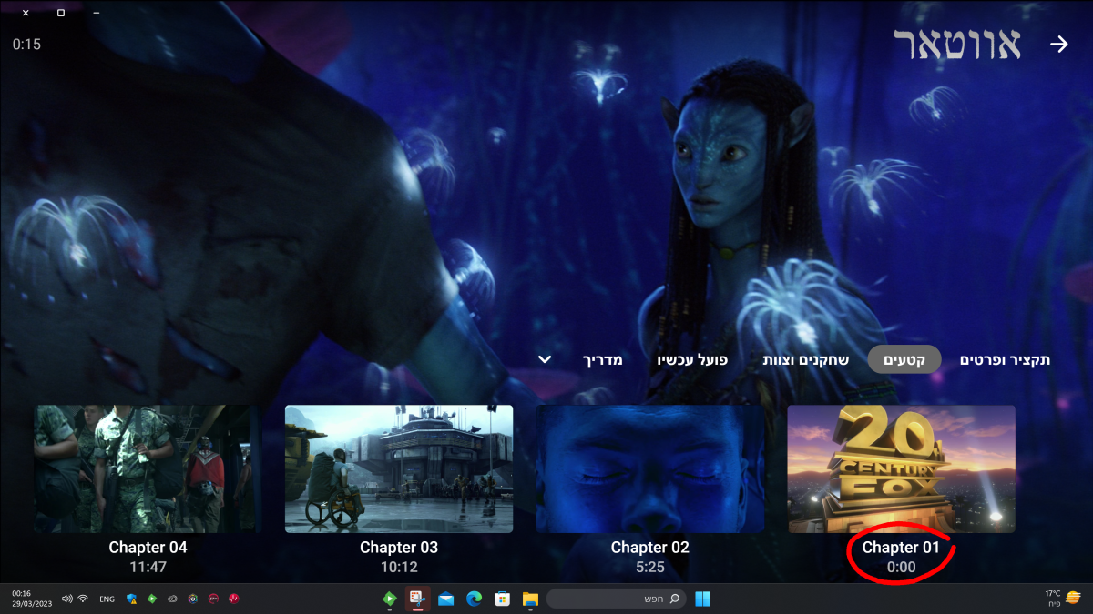

CAPRICORNX10X 68 Posted March 28, 2023 Author Posted March 28, 2023 4 minutes ago, roaku said: Haven't we already discussed how this works? Right. And I changed the chapter names in the metadata of the file via MKVToolNix. And there is no change in emby. Check and see that I am not wrong. More than that, I thought that maybe the problem was in the Hebrew language, so what I did in another movie I changed all the names of the chapter to numbers. Only the number should have appeared in Emby, right? So no - apper chapter 01 and so on.

CAPRICORNX10X 68 Posted March 29, 2023 Author Posted March 29, 2023 8 hours ago, roaku said: It's more likely that your issue has to do with needing to rescan the files after changing them. I did a refresh and there is no change in the chapter names. More than that, I added a brand new movie to the library, I changed the names of the chapters before that and the names of the chapter remain in English and number 01 and so on. In my opinion, this part of the onesky translation does not exist. Maybe Luke can explain it.

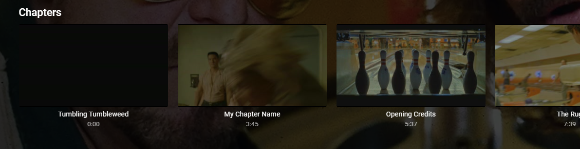

ebr 16354 Posted March 29, 2023 Posted March 29, 2023 7 hours ago, CAPRICORNX10X said: In my opinion, this part of the onesky translation does not exist No, it doesn't because the information is coming from the metadata if it exists. We don't attempt to translate text that comes from somewhere else (that would be next to impossible). Here is an example of chapter names coming from the file: Did you refresh metadata on the item you changed?

ebr 16354 Posted March 29, 2023 Posted March 29, 2023 How are you editing these chapter names? I just tested editing one:
