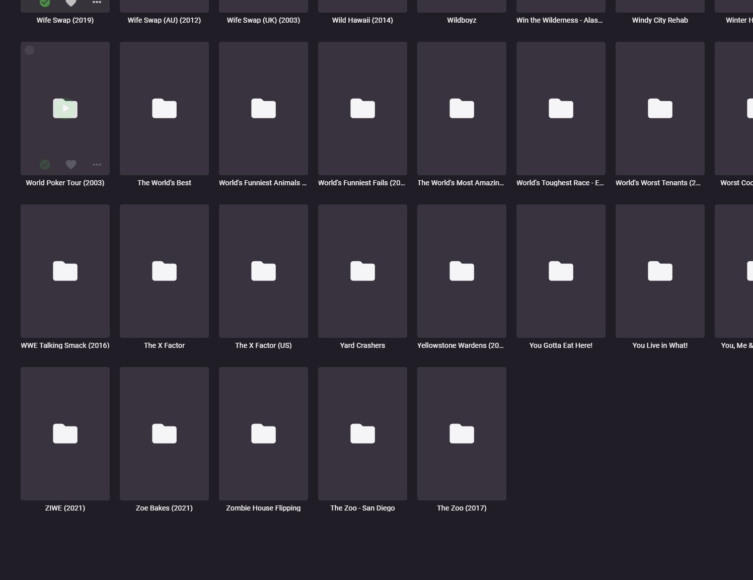

yyhemby 2 Posted April 2, 2023 Posted April 2, 2023 (edited) As shown in the figure, it would be better if a separate page can be opened like plex to display the current scanning situation. The current situation does not know how much content has been scanned, and the current scanning speed is also a little slow. Edited April 2, 2023 by yyhemby 1 1
