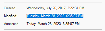

Happy2Play 9812 Posted March 29, 2023 Posted March 29, 2023 Just now, kufkis said: They are not. Apr 27 2020 Ozark.S01E01.720p.NF.WEBRip.x264-GalaxyTV.mkv. I'm investigating transmission now, the only other program that has write access to the folder as well as verifying the permissions and user:group of everything in my library just to make sure something doesn't have a weird property that causes a rescan. That would be be file created date I am guessing but what about modified date? Sorry don't know the platform. example of Modified data will trigger RTM. 2023-03-28 18:36:08.124 Info LibraryMonitor: Atomic Blonde (C:\Users\Media\Desktop\Videos\Movies - nfo\Atomic Blonde (2017)\Atomic Blonde (2017).mkv) will be refreshed.
Guest Posted March 29, 2023 Posted March 29, 2023 It's openwrt linux. I was using "ls -l" but "date -r" does the trick. display the last modification time of FILE date -r Ozark.S01E01.720p.NF.WEBRip.x264-GalaxyTV.mkv Mon Apr 27 01:08:40 MDT 2020
