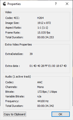

visproduction 338 Posted April 8, 2023 Posted April 8, 2023 12 Monkeys vid example above has out order frames and runs at 15.035 fps. Did the master video have this odd frame rate, or did the encoder make it because of some quality setting and hardware limitation? 1
Nitro_Zeus 11 Posted April 10, 2023 Author Posted April 10, 2023 how do you get that information, when I click properties on the movie, I cant see that kind of info is it some software you use, to obtain all that info? Keep in mind, i don't know that much about video frames and fps etc.
Nitro_Zeus 11 Posted April 11, 2023 Author Posted April 11, 2023 This is now happening with more and more files, Indiana Jones and the Temple of Doom Lara Croft Tomb Raider Goodfellas And it only happens on google chrome browser and Google TV Works fine on Edge and Firefox, it makes no sense. see the log file for today. I tried playing all three movies so it can be seen in the logs. embyserver (3).txt
pwhodges 2039 Posted April 11, 2023 Posted April 11, 2023 On 08/04/2023 at 02:36, visproduction said: 12 Monkeys vid example above has out order frames and runs at 15.035 fps. Did the master video have this odd frame rate, or did the encoder make it because of some quality setting and hardware limitation? As far as I can see, that video is not the original video being played, but a screen capture (made using Snagit, as shown by MediaInfo) showing the effect. Paul 1
Nitro_Zeus 11 Posted April 11, 2023 Author Posted April 11, 2023 9 hours ago, pwhodges said: As far as I can see, that video is not the original video being played, but a screen capture (made using Snagit, as shown by MediaInfo) showing the effect. Paul the video is not made by Snagit? a bit confused here?
pwhodges 2039 Posted April 11, 2023 Posted April 11, 2023 You posted a capture made using Snagit; so its properties do not reflect the properties of the video you have having trouble playing. That does not prevent it showing how your problem appears visually. But it does seem that there must be some problem local to your system, as no one else is reporting similar behaviour. Hopefully the logs will show something... Paul

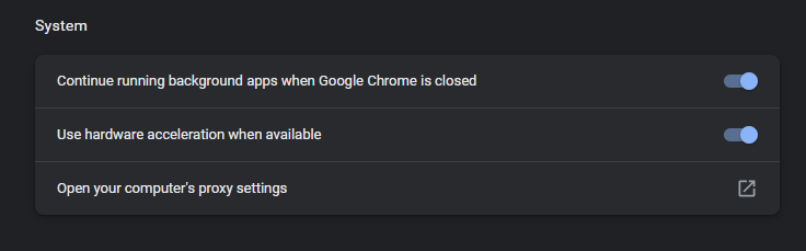

Nitro_Zeus 11 Posted April 14, 2023 Author Posted April 14, 2023 I haven't touched the settings so it's on pr. default, would you like me to turn it off and test it?
Luke 42289 Posted April 14, 2023 Posted April 14, 2023 I've seen some users who had it off, then turned it on and said video played better. But I've also seen the exact opposite happen as well, so I can't tell you which way is better for you, but since you've currently got it on, you might as well try flipping it off. 1
Nitro_Zeus 11 Posted April 15, 2023 Author Posted April 15, 2023 So it turns out on Google Chrome browser it's no longer lacking after I turned off hardware acceleration. So I assume the issue is fixed on Google chrome but it's still lacking on Google tv, tried googling if it's possible to turn off hardware acceleration on Google tv, but haven't found any usefully sites. 1
