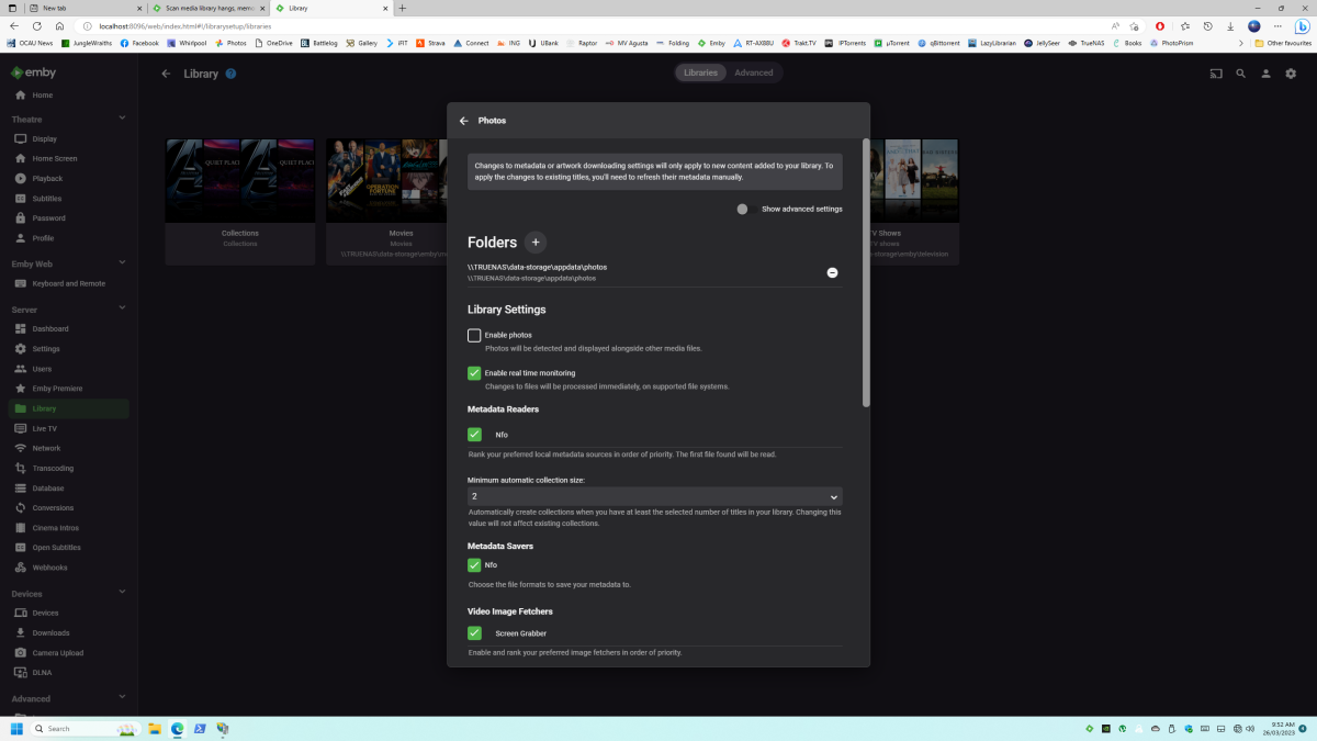

Trevor68 70 Posted March 25, 2023 Posted March 25, 2023 Same Same, attaching my log. embyserver-63815419390.txt 1
Trevor68 70 Posted March 25, 2023 Posted March 25, 2023 23 hours ago, lightsout said: Is there anything I can do for now to help? I removed the libraries that had home videos and photos as I read that could be part of the problem. But after a few hours I am having the problem again. For me my Photos library is causing the problem, if I edit that library and untick "Enable Photos" the problem goes away
lightsout 156 Posted March 25, 2023 Posted March 25, 2023 8 minutes ago, Trevor68 said: For me my Photos library is causing the problem, if I edit that library and untick "Enable Photos" the problem goes away Hmmm. I don't even think I have it enabled any more. Are you talking about the camera upload thing? Or an actual library.?
lightsout 156 Posted March 25, 2023 Posted March 25, 2023 1 minute ago, Trevor68 said: this one. I don't have that enabled, I did have one but I disabled it. After a few restarts at this time it looks to be holding without the ram going out of control. Hopefully things stay the same.
