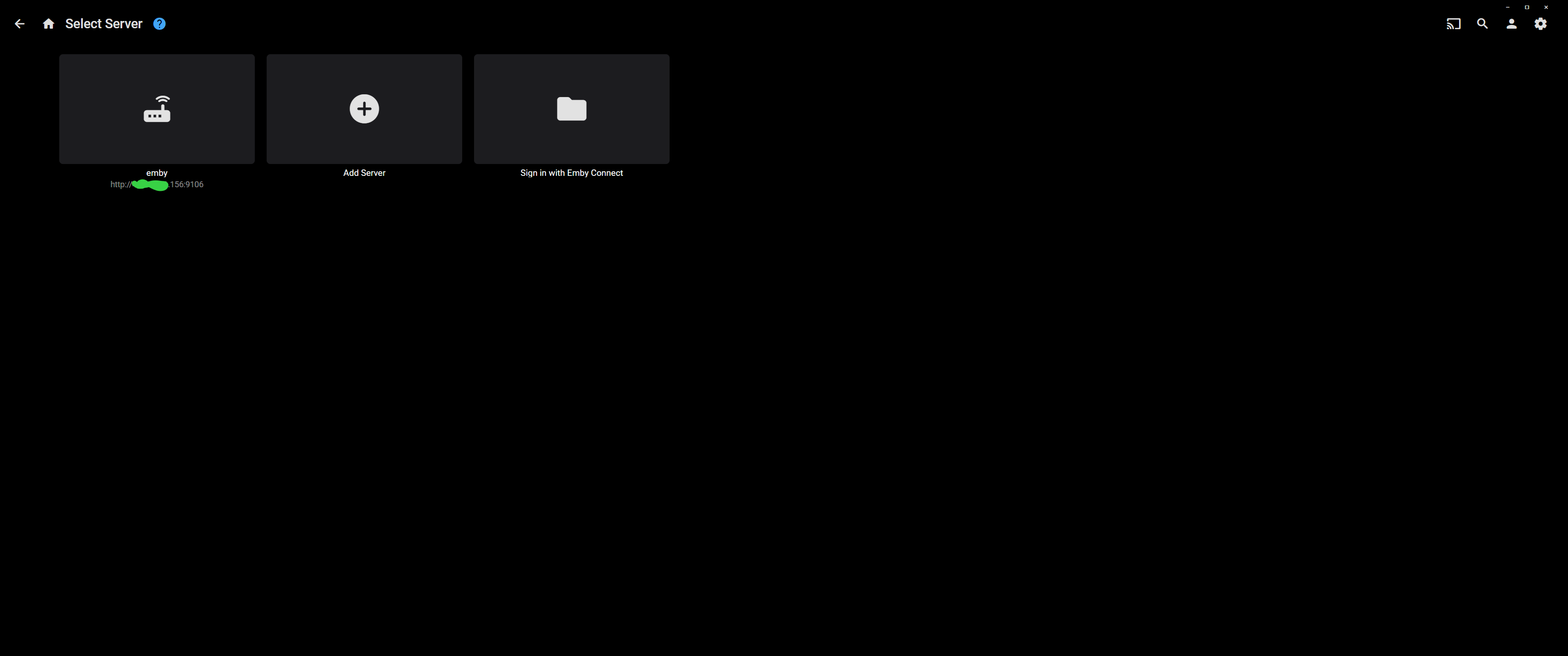

Guest chipk Posted September 13, 2023 Posted September 13, 2023 So after adding the details of both servers one at a time in Em theatre I was successfully able to connect to each server individually. I cannot have both servers show at the same time in the "change server" menu. I have to add new server every time and re-enter host and port and then sign in with chip If I am adding two different host addresses with the same port and signing into them with the same account chip, is that the way it should work bcoz it isnt

Guest chipk Posted September 13, 2023 Posted September 13, 2023 Emby theatre only one server shows up

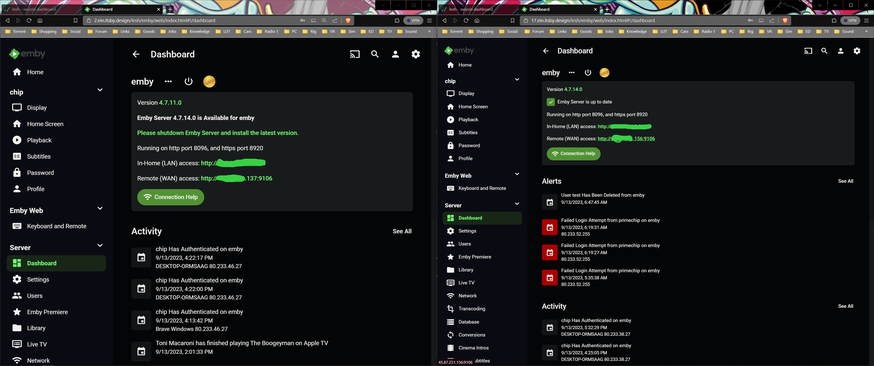

softworkz 5135 Posted September 13, 2023 Posted September 13, 2023 (edited) @chipk- Did you perhaps create the second server by copying everything from the first one? The only reason I could imagine why you are not able to add both servers would be that both servers have the same serverId. You can check the server ids via an URL like this: http://localhost:8096/emby/system/info/public (of course you need to replace host and port). This will return a json which shows the server id. Please check whether you get back different serverId values from your servers. Edited September 13, 2023 by softworkz

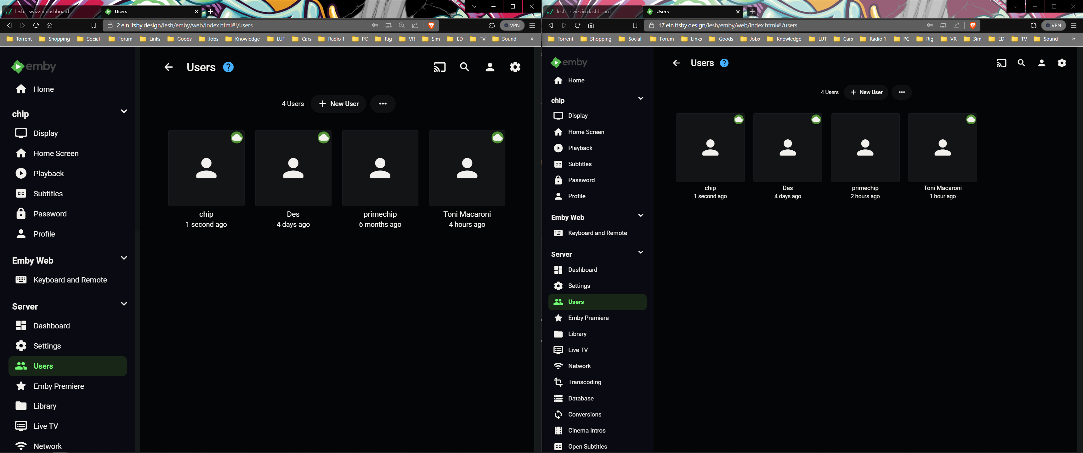

pwhodges 2039 Posted September 13, 2023 Posted September 13, 2023 You've shown us that the same users exist on the two servers; but this is beside the point, as those are users local to the server. Can you confirm that for each Connect user you have put their Emby Connect email address into their user profiles on both servers - this is the step that makes the Connect account see both servers (the names of the local accounts on each server don't even need to be the same, though obviously it's less confusing if they are!). Paul
Guest chipk Posted September 13, 2023 Posted September 13, 2023 @softworkz yes it was a straight copy of files and settings but they are two separate servers with one or two differences in the number of shows available atm on either one Yes the ID is exactly the same, only the emby ver is different between them. So that is it then, that is why I only see one server listed on Emby theatre, but if the server IDs are the same, why do I have to add different remote credentials to access each server individually It makes me + add server, add other host and port, sign in with chip
Guest chipk Posted September 13, 2023 Posted September 13, 2023 @pwhodgesyes all connect accounts have their email addresses added. Only primechip doesnt. Would theat mean primechip is my local account or is it also a connect account that isnt displaying like the others bcoz it doesnt have email address added to it ?
softworkz 5135 Posted September 13, 2023 Posted September 13, 2023 5 minutes ago, chipk said: So that is it then, that is why I only see one server listed on Emby theatre, but if the server IDs are the same, why do I have to add different remote credentials to access each server individually It makes me + add server, add other host and port, sign in with chip You just need to make sure that you have different server IDs, that's all. But I'm not sure about the impact of changing the id of a server. Let's loop in @Lukeand see what he will recommend to do.
pwhodges 2039 Posted September 13, 2023 Posted September 13, 2023 27 minutes ago, chipk said: @pwhodgesyes all connect accounts have their email addresses added. Only primechip doesnt. Would theat mean primechip is my local account or is it also a connect account that isnt displaying like the others bcoz it doesnt have email address added to it ? A local account is defined on a server; a Connect account is created at Emby and can be linked to chosen local accounts. So if primechip is an account on a server it is a local account. Accounts linked to a Connect account don't become "Connect accounts" - they remain local accounts linked to a Connect account. Paul
Luke 42288 Posted September 13, 2023 Posted September 13, 2023 The two servers are reporting the same unique identifier, so that's the reason for this issue. I would go to one of them, locate the server data folder: Emby Server Data Folder Then from there delete the /data/device.txt file and restart the server. If you do use Emby Connect then you'll need to relink all users on that server after doing this. 1
