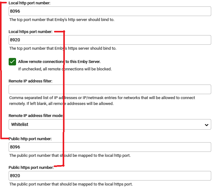

clinktone670 0 Posted March 19, 2023 Posted March 19, 2023 Do I have the correct numbers for internal and external on my router, or do I have them backwards?
Happy2Play 9814 Posted March 19, 2023 Posted March 19, 2023 You need a rule for both internal and external same port, you don't mix them. And all you need it TCP. external 8096 internal 8096 1
GrimReaper 4927 Posted March 19, 2023 Posted March 19, 2023 (edited) 6 minutes ago, clinktone670 said: Do I have the correct numbers for internal and external on my router, or do I have them backwards? Is actually neither, you have them wrong, as those are default ports for http (8096) and https (8920), you wouldn't want port forwarding set like that. Edited March 19, 2023 by GrimReaper Cross-posted 1

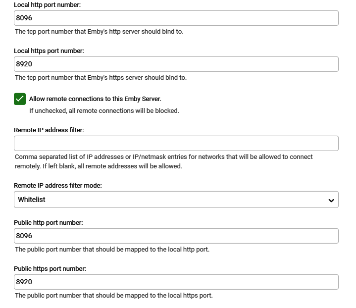

clinktone670 0 Posted March 19, 2023 Author Posted March 19, 2023 Then there should only be one port forwarding rule on my router, external 8096 and internal 8920? And this is what my Emby page looks like. Correct? REALLY appreciate the help!
GrimReaper 4927 Posted March 19, 2023 Posted March 19, 2023 3 minutes ago, clinktone670 said: Then there should only be one port forwarding rule on my router, external 8096 and internal 8920? No. 12 minutes ago, Happy2Play said: external 8096 internal 8096 If no SSL setup.
Happy2Play 9814 Posted March 19, 2023 Posted March 19, 2023 The are two separate functions as mentioned. If you are not supplying your own certificate then you only need to worry about http (8096).

Happy2Play 9814 Posted March 19, 2023 Posted March 19, 2023 Per the image is about what you are providing. If you have a ssl certificate then you would need 8920 or how ever you configured it. But if your VPN has port forwarding also then Emby would report your VPN address to clients. If your VPN service does not have port forwarding Emby connections will fail and require you to give your WAN to the Client manually.

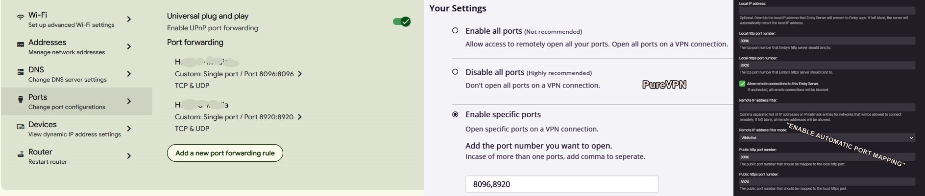

clinktone670 0 Posted March 19, 2023 Author Posted March 19, 2023 A three part photo, the first showing my Google Fiber box setting for ports, the 2nd showing my PureVPN settings, and the third showing the Emby Network page. This allows me to access Emby on both my own network here at home and when logged in remotely off of the home network. A friend also states that he can access Emby using the VPN IP address. The question now is......why would the old, non-VPN, WAN Remote Address still work???
GrimReaper 4927 Posted March 19, 2023 Posted March 19, 2023 (edited) 5 minutes ago, clinktone670 said: The question now is......why would the old, non-VPN, WAN Remote Address still work??? No. The question is why wouldn't it work? You still have ports in your router forwarded, despite twice mentioned: 3 hours ago, GrimReaper said: If all traffic would go through VPN (regardless http or https), you don't need port forwarding in your router as no open ports are needed in that scenario. 3 hours ago, GrimReaper said: Server-side (you): - Router - NO open ports required Edited March 19, 2023 by GrimReaper
clinktone670 0 Posted March 19, 2023 Author Posted March 19, 2023 I did try that, but to no avial. The remote access would not work. Is my current setup a security risk and are the remote users "anonymous"?
