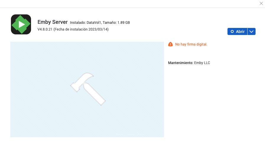

DanielMarch 2 Posted March 18, 2023 Author Posted March 18, 2023 (edited) where do I find the vein version? Edited March 18, 2023 by DanielMarch
seanbuff 1353 Posted March 19, 2023 Posted March 19, 2023 5 hours ago, DanielMarch said: where do I find the vein version? Not sure what you're asking for but you do not need to touch your Emby Server. Just follow the link that @ebrprovided above and side-load the latest BETA apk of 'Emby Android TV' on to your MiBox device, and try again. Guide: How to side-load apps 1 1
