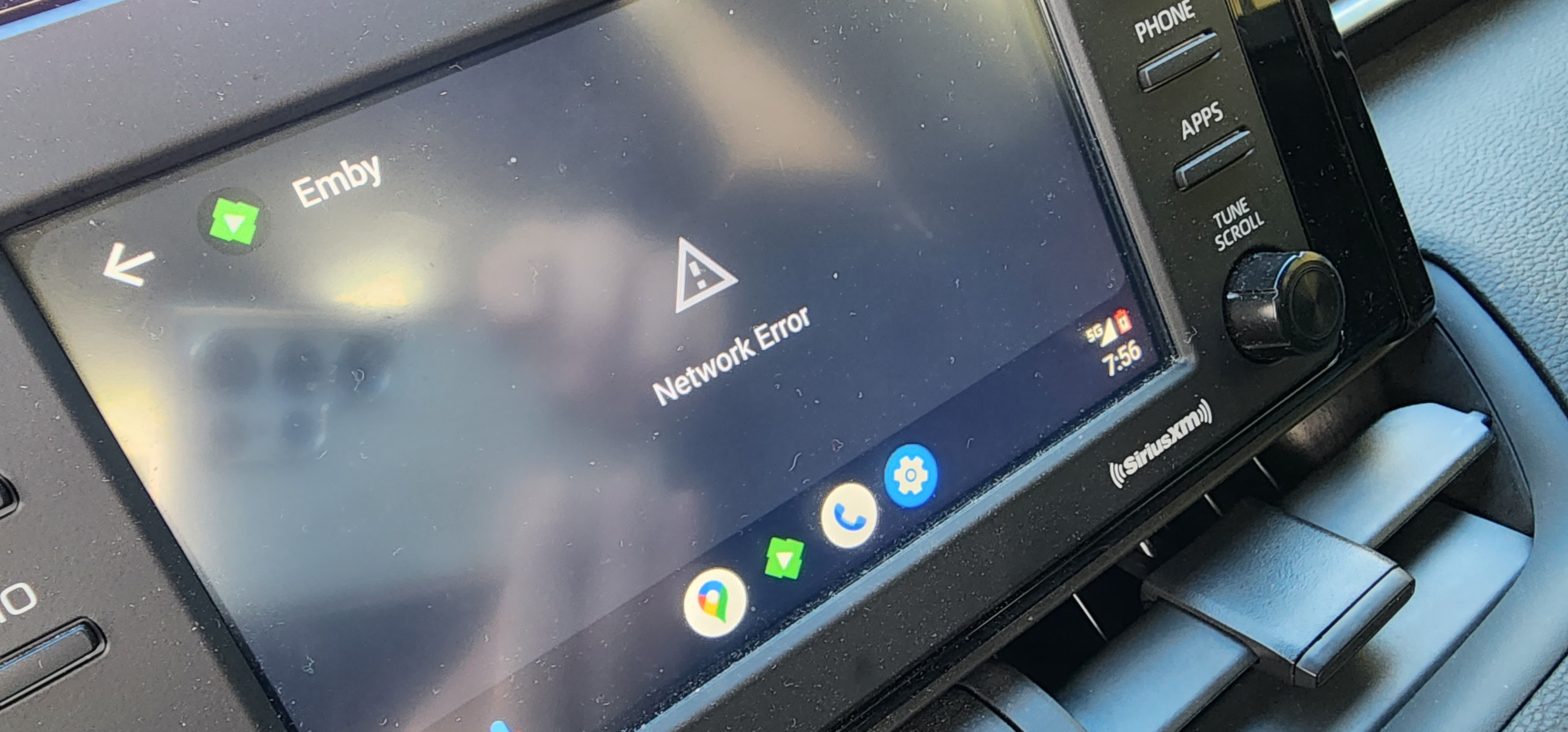

davidawarner 12 Posted March 15, 2023 Posted March 15, 2023 (edited) Developers, Before I begin, I want to let you know that I have no problems streaming any media from my Synology NAS using Wireguard VPN to my S22Ultra phone. In my car, friends house, work, I am able to stream w/o any data packet loss. Now, there might come a time where I hit a grey area and that's to be expected. What I notice is when accessing EMBY interface with Android Auto, if I am searching, or accessing folders, bringing up the playlist I am usually greeted with the 'Network Error' first time around and then I go back one screen then back into what I was trying to connect with and no problems. Here is my tech info pfSense running latest firewall OS with wire guard 2.6.0-RELEASE (amd64) Synology DS720+ (Latest OS) DSM 7 Embry Server for NAS Version 4.7.11.0 S22Ultra Samsung latest OS (Android 14) and EMBY client v3.2.92 Wire guard client latest version for Android v1.0.20220516 Toyota RAV4 Year 2021 Toyota RAV4 latest firmware updated Now, when this issue occurs I monitor my IP traffic and there is no data loss. In addition, able to use third party app like Solid Explorer to browser my network shares. In addition, able to ping my EMBY server and monitor any packet loss there - none. Cleared EMBY client cache on android device, good ole reboot of NAS server and Emby server. So my belief is that it is the software communication between Android Auto and Emby. Why? If I am not using Android Auto and accessing my NAS with EMBY outside my network with my phone absolute no problems with browsing, viewing, deleting, interacting with the web client. Have spoke with others via Reddit forum for Toyota and Emby and the same behavior as been documented. Any ideas if this is being looked at? Please advise and Thank You tvos Edited March 15, 2023 by davidawarner

Luke 42243 Posted March 21, 2023 Posted March 21, 2023 Quote Why? If I am not using Android Auto and accessing my NAS with EMBY outside my network with my phone absolute no problems with browsing, viewing, deleting, interacting with the web client. It's possible it could be performance related. Android Auto is controlled heavily by the OS, unlike our app. Requests have to come back quickly or it will just fail them outright.

Luke 42243 Posted May 30, 2023 Posted May 30, 2023 Quote As I am connected via wire guard or OpenVPN to my firewall and can ping the Synology NAS server but connection is lost with Emby, this tells me that there might be a connectivity time out with the client. Android Auto requires fast responses. What I mean by that is the OS imposes a requirement on apps using Android Auto that any data or stream requests have to respond quickly, within a few seconds. If that doesn't happen, then the system considers it timed out and gives the user a network-related error message. Do you have anything in your network setup that might be causing slow responses?
davidawarner 12 Posted May 31, 2023 Author Posted May 31, 2023 On 5/29/2023 at 8:36 PM, Luke said: Do you have anything in your network setup that might be causing slow responses? Hello Luke and Thank You for responding back. I had to rethink this and verify the workflow and how the data is transmitted. I believe it not to be within my network for the mere reason is that if I am not using Android Auto interface integrated with Emby, there are no issue's with packet loss or response time. Able to listen, watch, browse with Emby w/o error. When using Android Auto with Emby I was also pinging my firewall for response times. There was no packet loss at all. If I am away from home across the world connected through wireguard vpn into my pfSense firewall, I am not seeing any packet loss. So it is either Emby not sending the data quick enough or Android putting the cart before the horse. Let me know your thoughts. Dave 1
