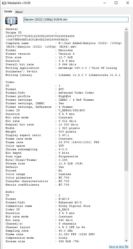

ErikaJ 65 Posted March 18, 2023 Author Posted March 18, 2023 (edited) That is what I thought as well but when I run mediainfo against the mkv file I get the following and there is data in there. So my question now is how is Emby not able to read it? Secondly, I noticed that this information appears to be missing in the nfo file. Is this where Emby is looking for the data? TIA Cheers!!! Edited March 18, 2023 by ErikaJ
pwhodges 2023 Posted March 18, 2023 Posted March 18, 2023 49 minutes ago, ErikaJ said: EDIT: If there is no media info, why are the files (all of them) able to play just fine in VLC, explorer etc.? Presumably you have given the necessary permissions to access these files to your desktop user, but not to whatever user is running the Emby server. Paul

Happy2Play 9800 Posted March 18, 2023 Posted March 18, 2023 (edited) In the end it is all about the context user that runs Emby and ffprobe as that is what Emby uses to read the data. But if it failed in the past and the issue is corrected then all you need to do is Refresh metadata for Emby to reprobe the media. Edited March 18, 2023 by Happy2Play
