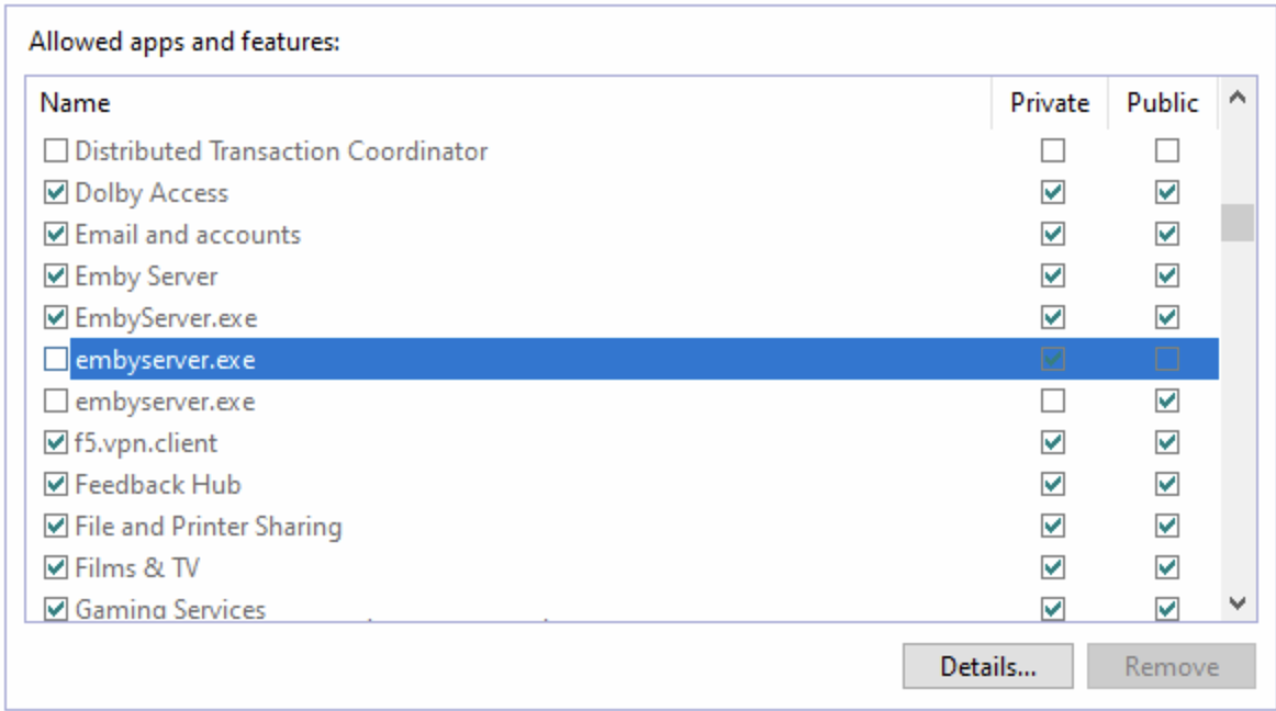

GrimReaper 4851 Posted March 10, 2023 Posted March 10, 2023 As stated: 10 minutes ago, GrimReaper said: If you temporary disable firewall That was just for testing purposes and to ascertain that route is open and to confirm or exclude firewall as the underlying issue. Anyway, it's obvious now that it is firewall blocking your connections. Do you have any EmbyServer.dll (not .exe) process rules blocked maybe?
jtbreen80 1 Posted March 10, 2023 Author Posted March 10, 2023 18 minutes ago, GrimReaper said: As stated: That was just for testing purposes and to ascertain that route is open and to confirm or exclude firewall as the underlying issue. Anyway, it's obvious now that it is firewall blocking your connections. Do you have any EmbyServer.dll (not .exe) process rules blocked maybe? I don't see anything but Embyserver.exe in the list.

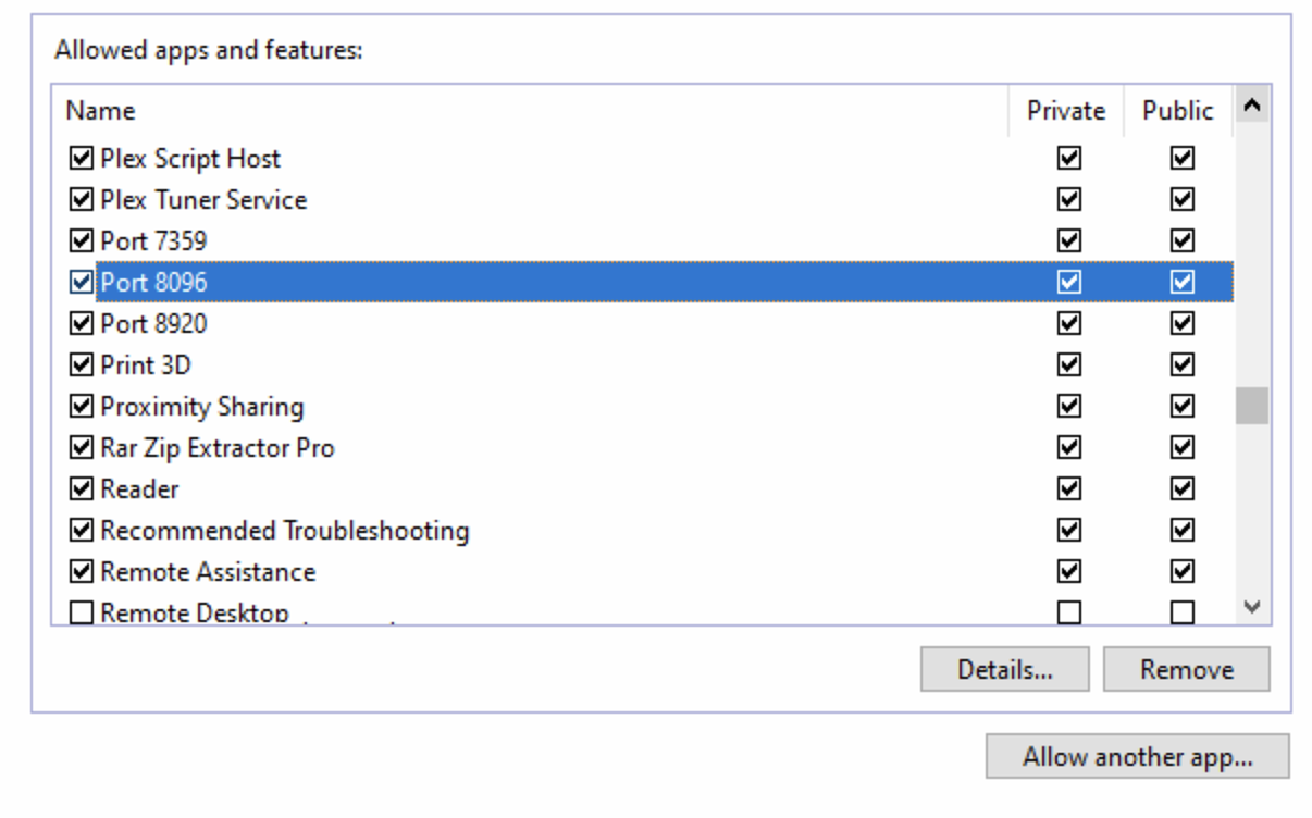

GrimReaper 4851 Posted March 11, 2023 Posted March 11, 2023 Why do you have so many Emby rules? Which ports are those? Particularly that highlighted and disabled Private rule?
jtbreen80 1 Posted March 11, 2023 Author Posted March 11, 2023 18 minutes ago, GrimReaper said: Why do you have so many Emby rules? Which ports are those? Particularly that highlighted and disabled Private rule? I didn't create any of them. I assumed they were created when I installed Emby.
GrimReaper 4851 Posted March 11, 2023 Posted March 11, 2023 Emby should create 4 rules by default, 2 for Private and 2 for Public for embyserver.exe TCP and UDP. IMHO you've got too many of those process rules up there. If you enable that embyserver.exe Private rule from your previous screenshot, does anything change? What are the details for first two rules, what path is shown?
Happy2Play 9800 Posted March 11, 2023 Posted March 11, 2023 I would delete the Emby firewall rules. Shut down Emby and edit the C:\Users\username\AppData\Roaming\Emby-Server\programdata\config\system.xml Change <IsPortAuthorized>true</IsPortAuthorized> to <IsPortAuthorized>false</IsPortAuthorized> then start Emby again to reauthorize the ports.
jtbreen80 1 Posted March 11, 2023 Author Posted March 11, 2023 17 hours ago, Happy2Play said: I would delete the Emby firewall rules. Shut down Emby and edit the C:\Users\username\AppData\Roaming\Emby-Server\programdata\config\system.xml Change <IsPortAuthorized>true</IsPortAuthorized> to <IsPortAuthorized>false</IsPortAuthorized> then start Emby again to reauthorize the ports. Thanks. I ended up just deleting a couple of the extra rules and it's now working. Must have been there from a previous install or something because I definitely didn't add them. Still tinkering around but getting some audio dropouts and then audio sync issues happening with remux files so still a WIP. 1
